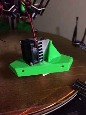

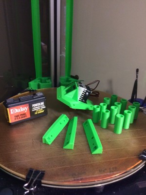

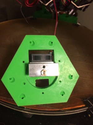

Thanks for this post JFettig, I am working on getting my Dual extrusion parts printed...   I like your top mount for the Extruders.  I read for these new E3D heads we should change to a Geared head stepper motor on our bowden tube setup.  are you using the 5:1 gearbox ratio?
