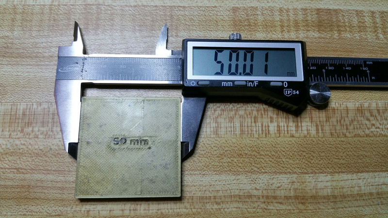

STEP 2: Small Box
Slice Step 2 - 50mm Box.stl with the following settings:
- Loops: 3
- Skin thickness: 0.6 or more (not a big deal)
- Infill: 15-20% is fine (not a big deal)
- Speed: 20-30mm/sec outer loop, 30-50 for everything else
Use the Digital Calipers to measure the width of the 50mm box in several locations. Measure the box across the east-west and north-south directions. (We don't care how tall it is right now.) As stated above, avoid measuring right next to the corners, as well as the bottom 1mm or so, where the plastic may be a little thicker. You should get a number close to 50mm.
STEP 3: Big Box
Slice Step_3_-_100mm_Box.stl with the same settings as above.
Print the box and measure it in several places, avoiding the corners and bottom layers. It should come out to about 100mm.

I´m in the process to calibrate dimensional accuracy also.
All is nearly perfect, but have one issue.
Printed Boxes like 626pilot mentioned. One 30x30x10mm, 60x60x10mm, 90x90x10mm. All hollow. Wall thickness is 2mm.
Walls are 2mm one the spot, height is on the spot.
Cube 30x30 is in X=30,02 in Y=29,89
Cube 60x60 is in X=60,02 in Y=59,90
Cube 90x90 is in X=90,03 in Y=89,90
Printed now 6 of each. They are all the same within 0,01mm tolerance.
My Delta build is very accurate. All angles are nearly perfect. Effector is parallel to the printbed. Arms are all within 0,05mm Tolerance.
But why are all prints in Y-Direction 0,1mm to small, but in X-Direction nearly perfect?
No matter what I do, Y-Direction is 0,1mm smaller than X-Direction, independant from size of the Testparts?!
Any tips to solve this little issue?
Thanx
Dirk

Think I solved the Problem.
Changed the Nozzle on my e3d V6 to a stainless steel one.
Now I have it in Y-Direction only 0,03mm smaller. Hard to messure, but much better than before.
That shows, that the old nozzle is not round not perfectly round or something inside must cause this problem.
Anyone here who experienced the same with different nozzles?
Anyway. This Tolerance is absolutly acceptable and more than I ever expected. Now I can print skates and effector for my magnetic ballarms with tolerances below 0,05mm - PERFECT!
