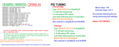

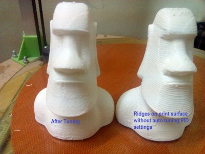

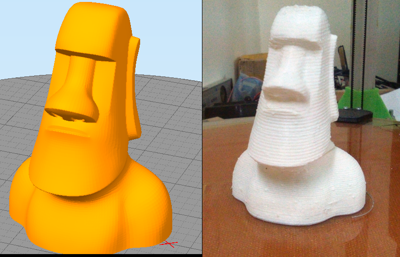

Just want to share my experience of getting Harmonic ridges/serrations on my print surface. I thought first it is due to vibrations or other loose mechanical component in my 3D printer. I checked all and nothing bad found in mechanical settings. Then during the print i stopped the Heated Bed and saw that all the ridges vanished on the print surface.
Actually PID tuning of the Hotend and the bed thermistors is key to success. The variations in the glass bed surface due to poor tuning of the bed temperature sensors (thermistors) caused the minor thermal expansion/contraction of the glass plate which pronounced in the print surface. I did autotune the PID settings and now the temperatures are constant reading and ridges are vanished.
Happy printing

I have silicone bed 220V. It abruptly rise the temperature of the glass from within 1minute from 23C to 110C I am controlling with Solid State Relay!!! My glass is fixed at three locations.... I just 3D printed another statue with tuned heat bed and it came out very clean. There was no noise issue and i came to cnclusion that rapid temperature rise at certain intervals was the reason of those harmonic imperfections.

Eaglezsoar, In my case the untuned PID of the heat bed was the cause of these ridges. As I am using Silicone 220V bed which has abrupt rise in temperature. This rise and fall of temperature from the setpoint was huge which causes those ridges. Now after PID tuning all is perfect.
