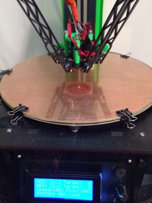

Re: PEI print bed surface experiments
I installed the PEI on my Glass Plate and added the copper plate. Installed my E3Dv6 and re-calibrated the printer. The PEI print bed surface is great!techstorage wrote:I am running out of glue sticks, so time to install this update.
I have a thin copper sheet .032", ULTEM PEI sheet .003" and 3m tape to make the sandwich on my Max v2 with an extra glass plate I purchased from Seemecnc.
After reading mhachney's other post about starting on the first layer over and over till you get it right, it is very helpful, also. I can take up the first or first and 1/2 the second layers to see how things are going and I don't have to reapply glue or ABS Juice.
