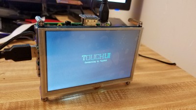

The point of this exercise is to get this up and running:
If you see a bunch of static looking stuff on the right side of the screen, it's because something went wrong with editing config.txt. If what you see is just like the above image, you did it right!
NOTE: The first time you boot the OS on your Pi, it will run a bunch of "first boot" tasks that will make it take awhile to finish booting. Subsequent booting should complete in well under a minute!
Once the Pi is done booting, you will need to bring it up in a browser. The OctoPrint interface should pop up a window asking you to specify a username and password for access control. Either set that up, or tell it to skip that. Please note that if you set up access control, it will apply to the touchscreen along with any other Web client, meaning that it will be read-only unless you log in through the touch screen.
After you choose what to do about access control, the interface will probably tell you that there's a new version of OctoPrint available, and ask whether to update. Say Yes. This will take a few minutes, and then OctoPrint will restart.
After it's done restarting, the OctoPrint interface will ask you to reload. Once that's done, click Settings -> Plugin Manager -> Get More. From that screen, you can install Touch UI. Do so. It will tell you that you need to restart OctoPrint before the plugin will work. Click System -> Restart OctoPrint -> Proceed.

After this, you should see the same bootup screen from the screenshot above (with four raspberries at the top). After about ten seconds, the screen should go blank, as X starts and loads Chromium. Ten seconds after that, you should see this:
About twenty seconds later, you should see OctoPrint's status screen (machine status, file, timelapse, etc.) The tabs and menu are all at the top of the screen. Scrolling is done by dragging a fingertip or stylus up/down on the screen. You won't need to scroll much, if ever. If you use the on-screen terminal, be advised that the terminal screen itself is scrollable, and it can be a little tricky to scroll back to the top of the screen and access the different tabs.
Connect to your Raspberry Pi according to the instructions linked above, set an access password when prompted, then click Settings and tell OctoPrint everything it needs to know about your printer. See the section below if you're connecting to a RAMBo.
I'm working on a printable enclosure for this. Stay tuned.
