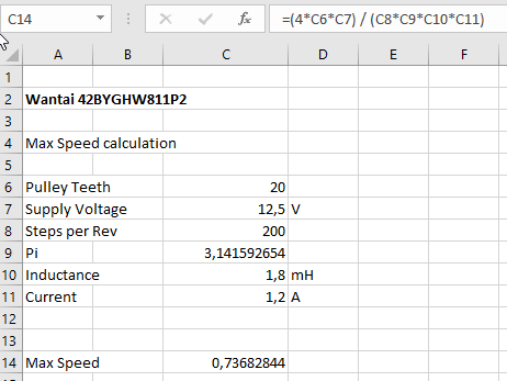

The info in the above mentioned topic made me curious about my own stepper motors, and I checked them out to be Wantai 42BYGHW811P2. I googled for specs: http://www.phidgets.com/documentation/P ... asheet.pdf . Here it shows that they are rated for 2.5 Amps, which looks to be much higher then most others?
Using the formula for calculating the maximum speed (as found on the Duet3d.com wiki) as:
max speed = (4 * pulley_teeth * supply_voltage)/(steps_per_rev * pi * inductance * current) I get this result: But I am having troubles interpreting it. Obviously 0.737 is no nice speed. Would I have to use mA instead of A, then the is even worse. Assuming meters/second the outcome is unreasonably high... What am I missing? And how can I optimize the jerk setting?
Reason I am asking all this is that I have a lot of stringing problems in my prints, and I think I can at least partly counter measure that by optimizing jerk and move speeds, so that the string breaks. It does not do that now. I already put a lot of effort in optimizing retraction settings and extrusion temp... My current config in the duet is this:
