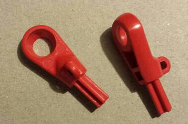

First batch of injection molded rod ends arrived today.
Should be available for shipping by end of next week. After we inspect and package up kits.
Will be available as complete CF arms sets, retrofit kit for existing Trick Laser CF arms, and just rod ends for building your own arms.
Fits 3/8" balls like oem seemecnc bar-bells.

Nice add-on Brian, they do look great.
Just out of curiosity, will they come in other colors?

Tincho85 wrote:Nice add-on Brian, they do look great.
Only red.

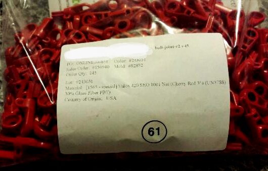

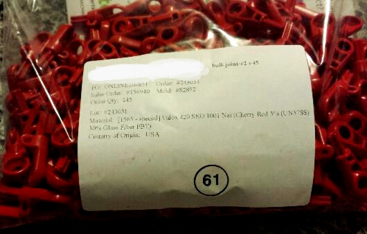

What kind of plastic are they made from? My slight OCD makes me wish these were a neutral color like black/white/silver so I'd be interested to know if they were made from something I could use a black plastic dye on.

U.S. Water Rockets wrote:What kind of plastic are they made from? My slight OCD makes me wish these were a neutral color like black/white/silver so I'd be interested to know if they were made from something I could use a black plastic dye on.
Glass fiber reinforced PBT
