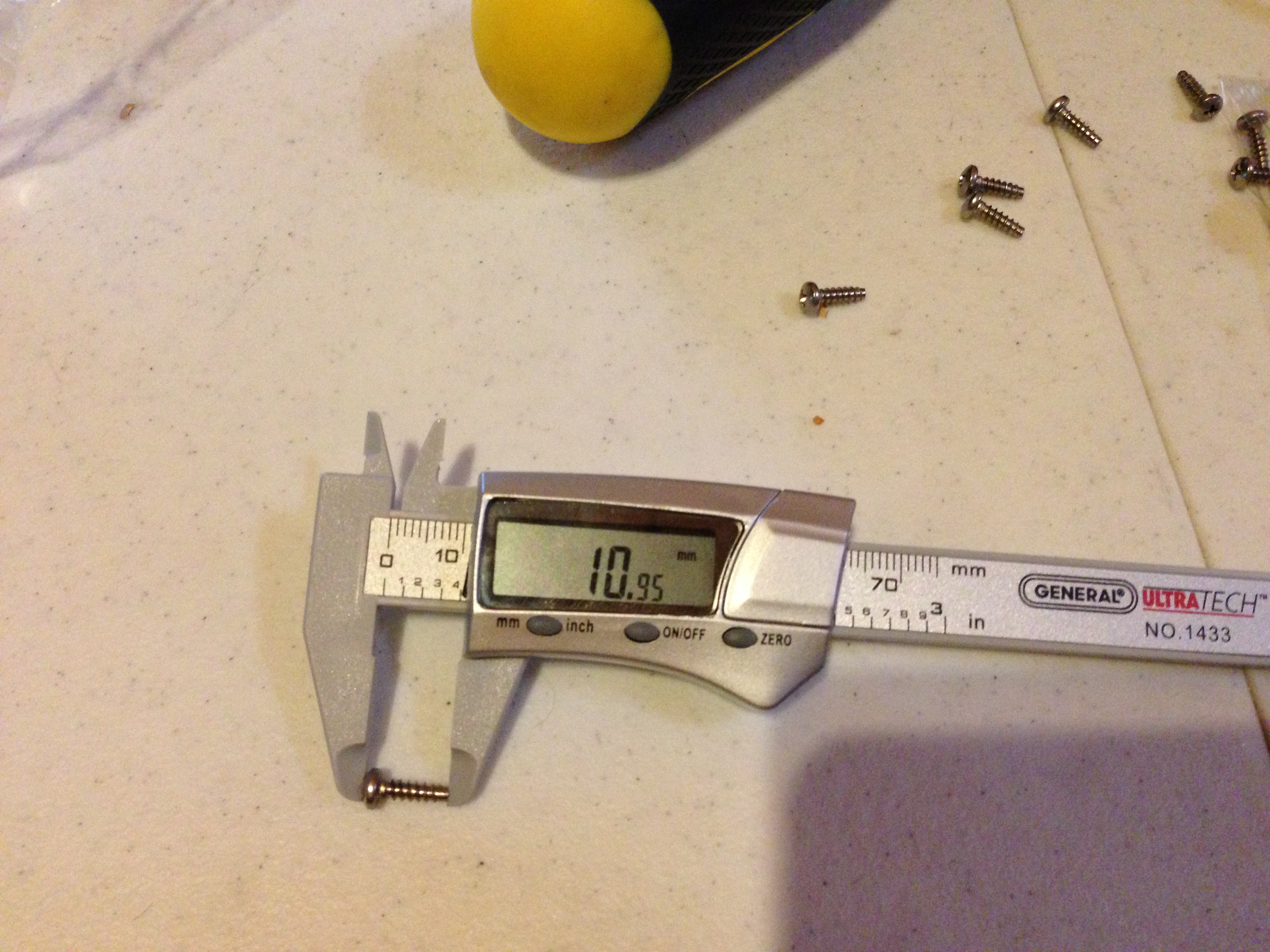

Re: Rostock MAX Assembly: M3 x 10mm pan head screws
Indeed, I got those, but the resolution isnt great, and so I didnt see the difference in threading, especially since I dont have the actual M3s to compare. Or didnt anyway. Once you have the #4 x 3/8ths and the M3x10mm Ls side by side, its pretty obvious which is which. That said, I wonder if labels ...
by Chandley
Sat Jun 08, 2013 7:50 pm
Forum: Rostock MAX
Topic: Rostock MAX Assembly: M3 x 10mm pan head screws
Replies: 14
Thanks cambo3d, that certainly would explain why they wont catch. Unfortunately I simply dont have any other screws that even come close to the right size. Off to the hardware store.

Sat Jun 08, 2013 7:16 pm
Forum: Rostock MAX
Replies: 14
This is what I got:
10mm M3?
10mm M3?

Sat Jun 08, 2013 6:55 pm
Forum: Rostock MAX
Replies: 14
Thanks for this picture, helped me find these screws as well. Unfortunately, the problem Im having is that these screws are like... 1mm too short to actually bind to the stepper motors through the board. Before I go buying longer screws and trying to cut them to the right size, is there something I ...
