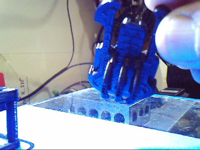

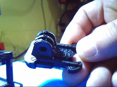

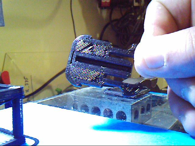

This was a GoPro bracket I was attempting. Btw Sorry for the low quality photography!

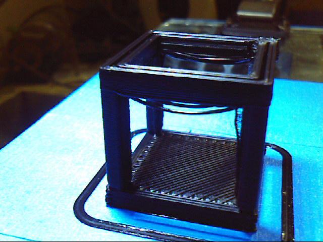

Not sure about posting a picture here.
