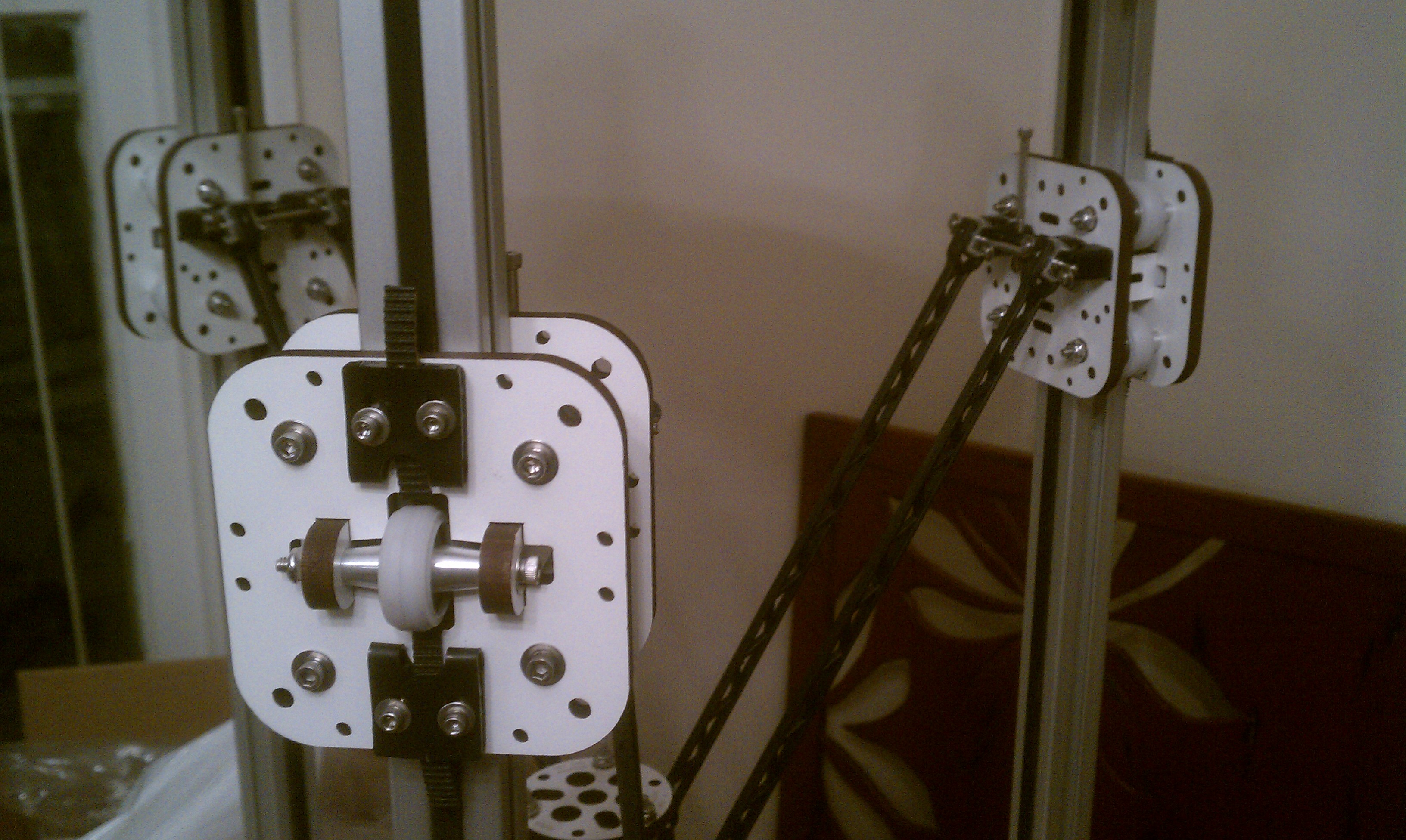

Re: endstop questions
I also had this problem with the end-stop bolt hole. I found it easier to drill holes in the back cheapskate plate and move the belt clamps there so that they no longer interfered. You can see what I did in the crappy cell-phone picture below.
