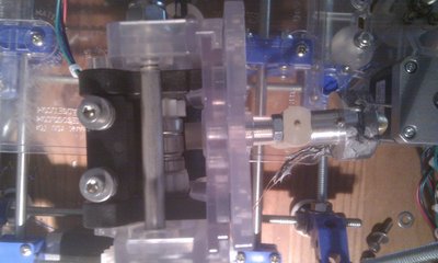

Re: Cannot fit Hot end to extruder- seems too long
Thanks John!
Perfect, that was exactly the problem. All reassembled now and fits fine
cheers
Steve
cheers
Steve

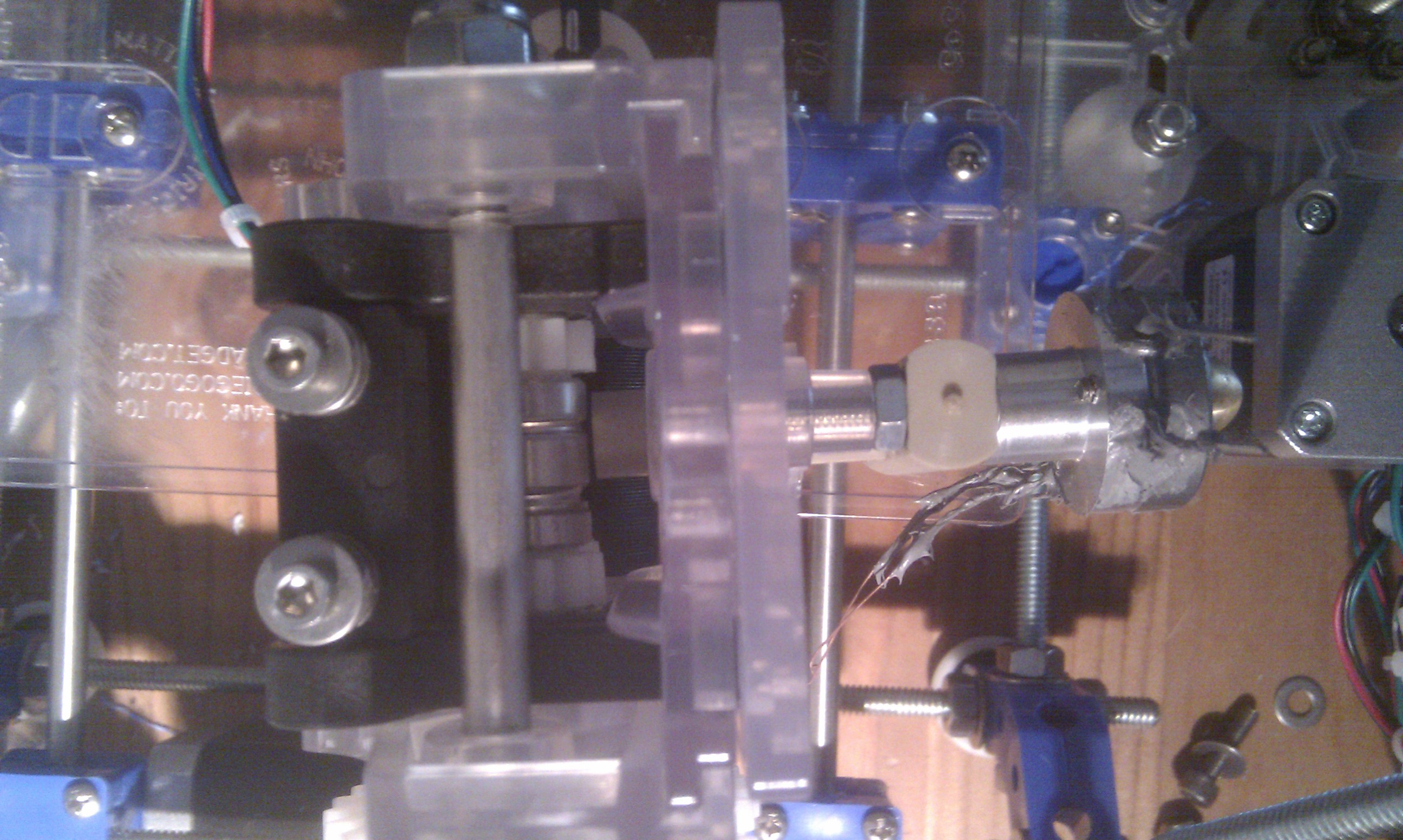

Hi There, Thanks for the replies. Checked the crossbar and the countersunk holes face the table so the screws go in. Bottom of the extruder is definitely on correctly- the slots on the motor mount and opposite side prevent it from going on incorrectly. Also the 2 lugs that locate the hot end bottom ...
Think I have a solution- have fitted 2 slightly oversize nuts as shims which brings the hot end down a bit. How does this look?
Steve
IMAG0493.jpg Hi There as shown on the pic the hot end seems too long and pushes up against the rollers stopping them from turning. Im pretty sure I assembled the extruder correctly. If I have got it right is it acceptable to cut a section from the end of the peek to give me more clearance - what ...
