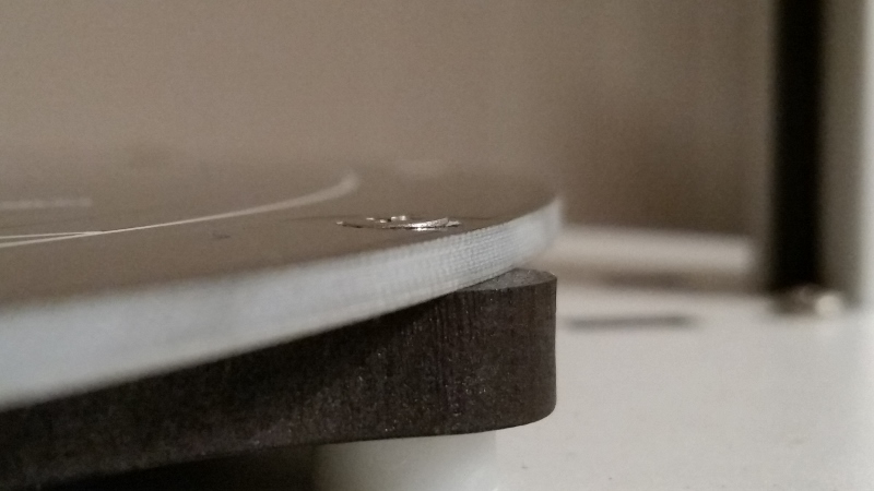

Re: Bed leveling issues
Hey Teoman, You're spot on. I actually tried this a bit earlier, but i didn't adjust all three screws out, just the y and z tower (tried a shortcut). However did this again now with adjusting all the screws out three turns and started all over again. It works! When doing the radius adjustment i ...
So that didn't help.. i'm completely lost now.. the g0 z0 x-77.94 y-45 f3500 is still ramming the bed and i'mm all the way in on the screw on x tower cheapskate any idea what i could be doing wrong?
Here's a pic of the bad taper job i did... corrected it now and trying again..
Hey! Thanks for the reply. The thing is that i've done these steps according to the manual, but i'm still ramming the bed at G0 Z0 X-77.94 Y-45 F3500. I've now turned the screw in 4 turns to the right and it doesn't help turning it more as that cheapskate body is now hitting the end stop switch ...
