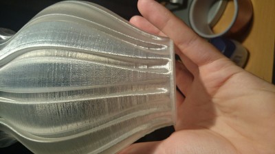

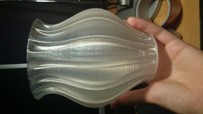

On the topic: I've successfully managed to print a 8,5 hour print today. I've used a little bit of vaseline on the first 30 cm of the plastic to lube things up. The rest of the print happened I did not lube any more. I printed at 15mm/s, at 205 deg.
Vase
Vase
Bottom is a bit shaky, gotta sort that out.

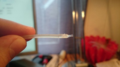

Another jam, printing at 210 degrees (10mm/s) constant extrusion, no retracts.
This is what it looks like when i retract the filament from the hotend.
picture of the removed filament
