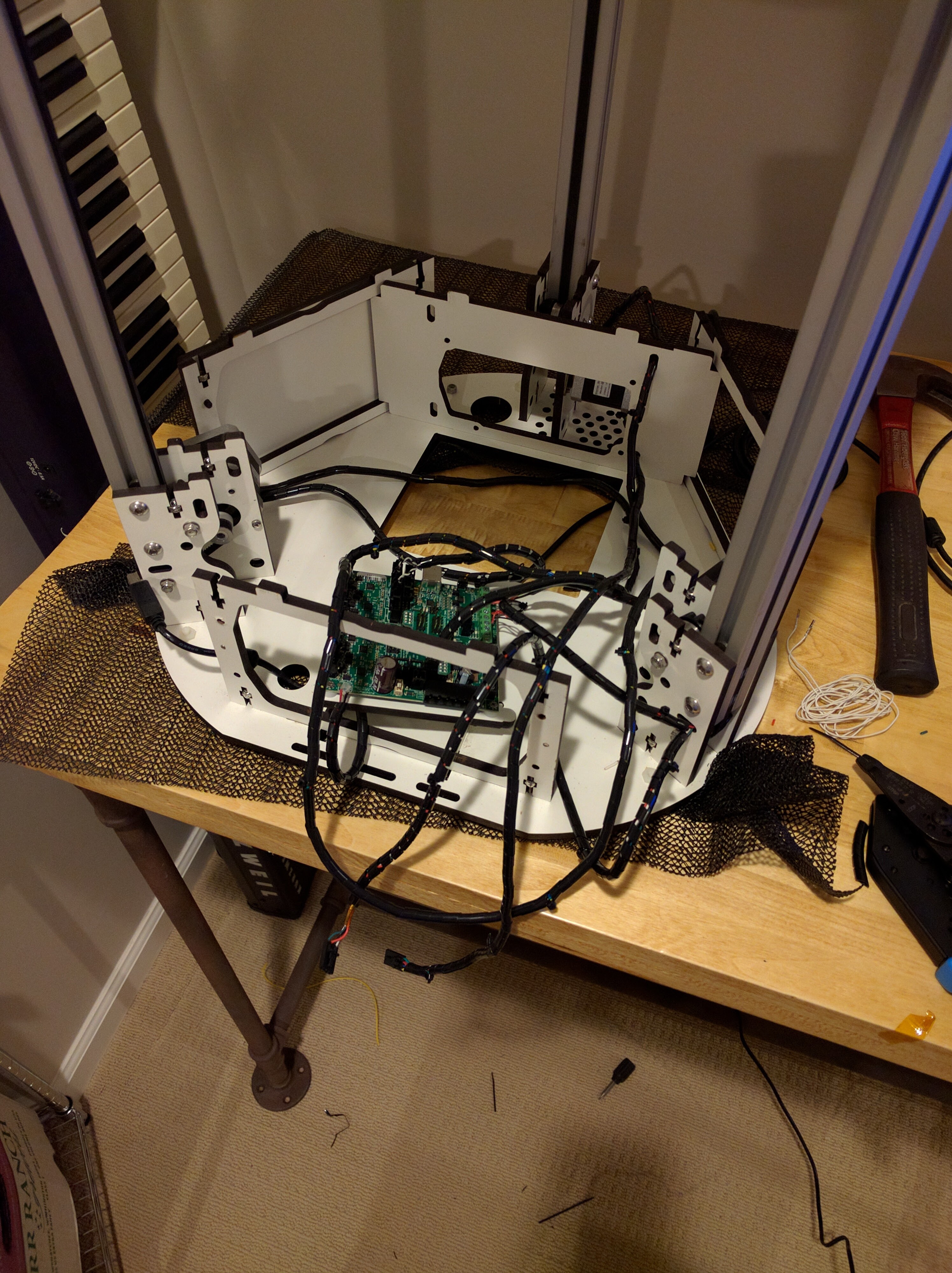

Got the bottom opened up and all the wires wrapped up. Once the power supply arrives, hopefully this afternoon, I will get it installed and route all the wiring. It already looks much better with the mass of unneeded wires from the original power supply gone. I also added a second set of wires to the heatbed so hopefully that will help with heatup times. Had to use a solid core wire as that was what I had laying around, do you think that will cause any problems?

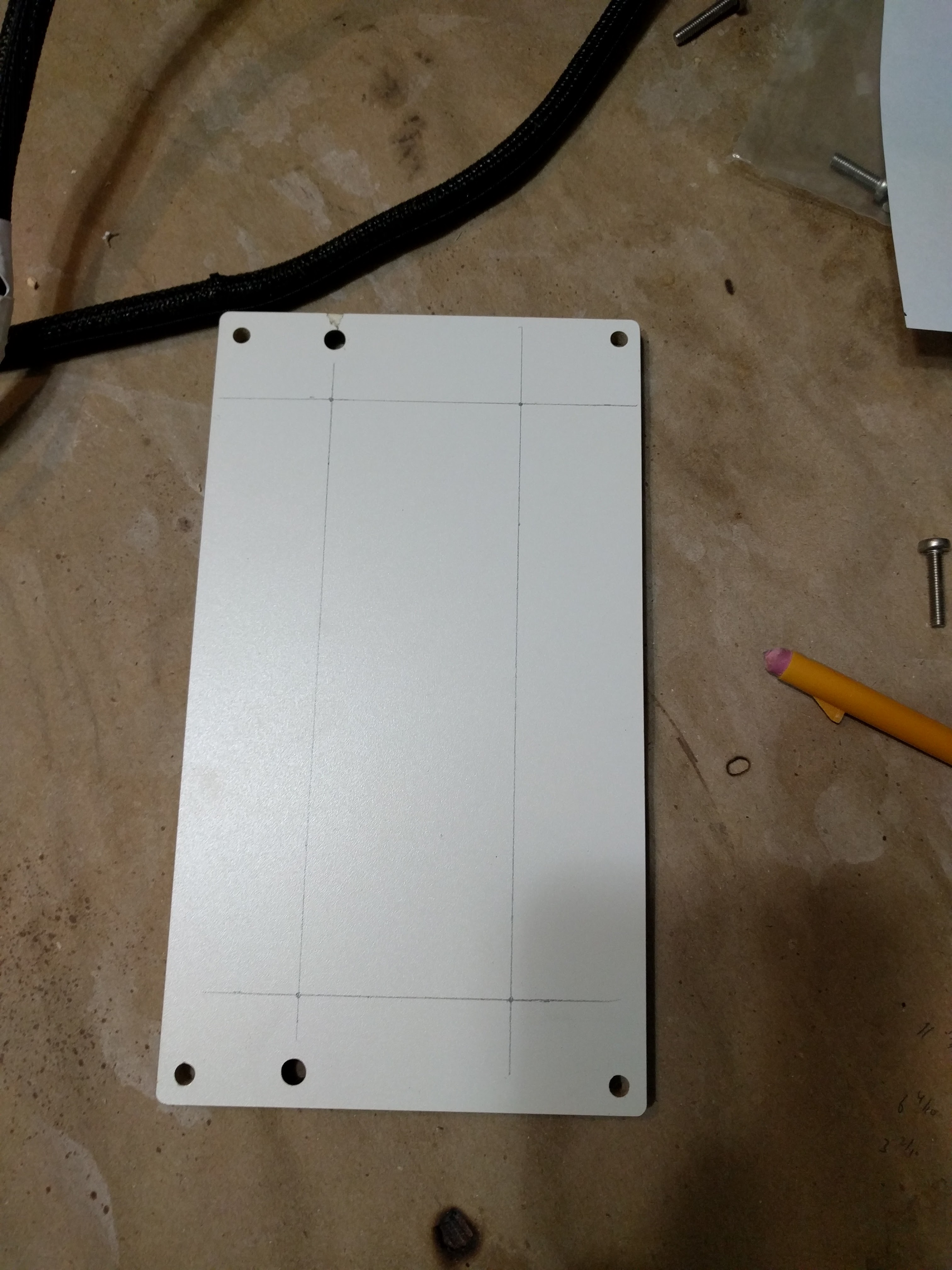

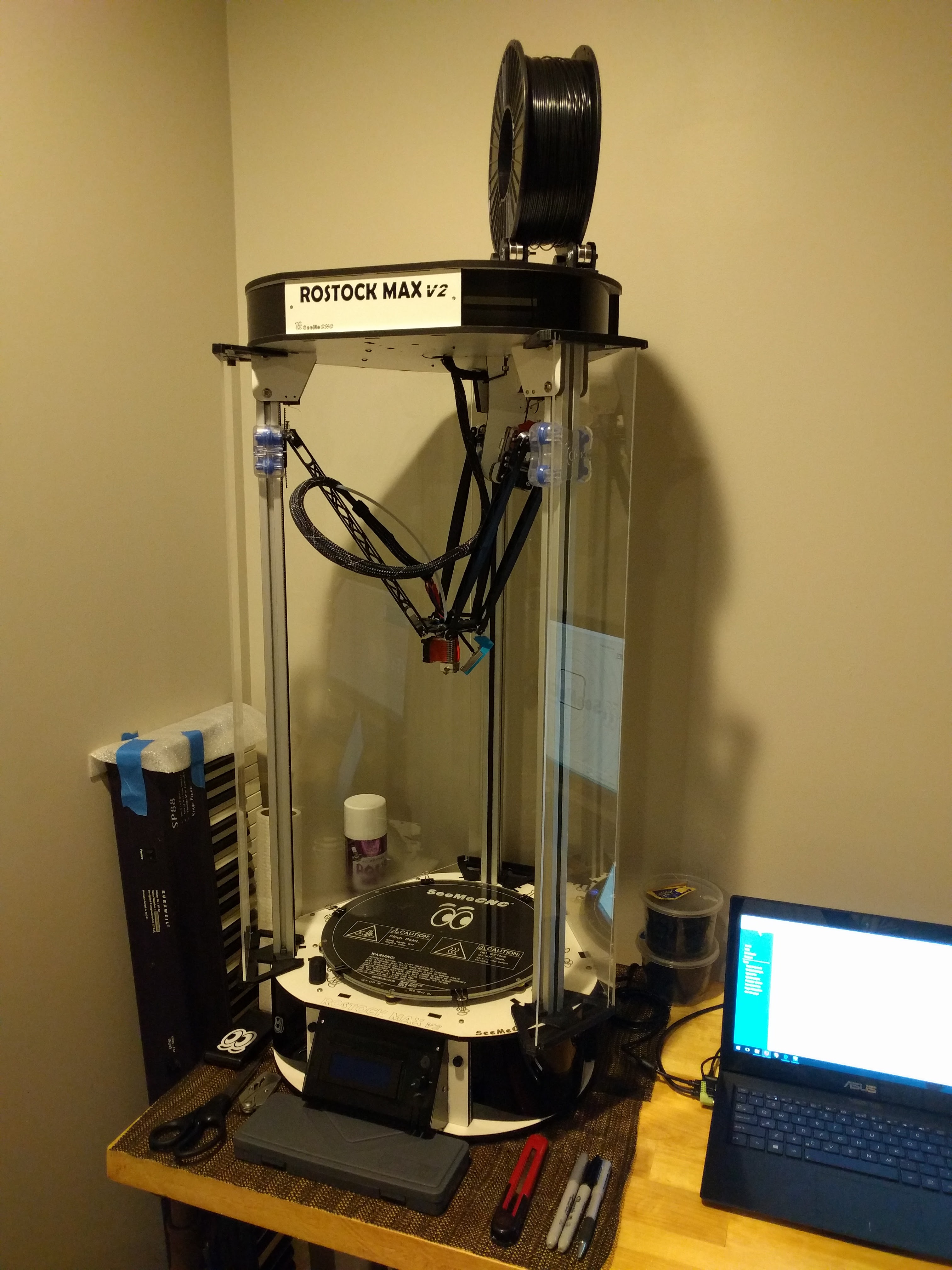

The rest of the components came yesterday so I was able to get my max back together. One thing that became a problem was when I went to drill the new holes for the power supply I realized my version of the max has a large hole for the old power supply and as such no where to screw into. I ended up using the extra side panel ( the one that is replaced with the new vented panel) to bridge the gap and then mounted the power supply onto that. It worked quite well so I have posted some photos below in case anyone else is in the same situation.

Post by guanu »
FYI anyone who comes across this later and also gets the kit, you do not need to use the side plate to bridge the gap, the hole in the bottom is actually good for ventilation on the psu... you can use this template that is linked on the psu kit page to mark the holes to drill.

Post by Nath5 »
I printed that template but there was no almost no way for me to position it such that none of the holes would overlap with the big hole in the bottom of the printer.

guanu wrote:FYI anyone who comes across this later and also gets the kit, you do not need to use the side plate to bridge the gap, the hole in the bottom is actually good for ventilation on the psu... you can use this template that is linked on the psu kit page to mark the holes to drill.
Guanu
Does anyone have a picture of this? Because I also don't see how to orient it so all four screws can be secured without using the extra side plate.
I've the Max V2 from July 2015, so I have even more ventilation holes in the bottom than the above poster.
