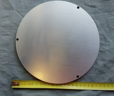

OK, replying to myself, but I managed to find a very helpful guy here in Germany that produces custom PEI covered aluminium build plates.
Will report back when I have a chance to use it (still need to build my max v2....)
PM me and I can put you in touch if anyone is keen to buy from this guy

Ok - here is the pic from ebay. The guy is basically a one-man show (he is doing it for me over the weekend) so I'm not sure there'd be an option for group discounts... we could of course ask though. I paid 65 EUR for a 300mm plate - bit of a risk / unknown I know.... will take pictures of it and post as soon as I get it, which should be early next week.
Here is the link to the ebay listing that I found - I then contacted him to organise a custom size.... http://www.ebay.de/itm/Dauerdruckplatte-PEI ... 463be2ea88" onclick="window.open(this.href);return false;

teoman wrote:is that 65euros including the PEI?
My pei just cracked, and i need a replacement some time soon.
Yes, including a coating of PEI. Exactly how thick I wait to see. He says it is "exoliert" with PEI, not sure exactly how that translates from German.

Anodized? Then it is a few microns thick.
My pei is 2mm or so. I got it from amazon. From the link posted in the PEI thread.

teoman wrote:Anodized? Then it is a few microns thick.
This is true. Do you think that will be an issue? My hope was that the aluminium plate would offer good strength and heat distribution.
