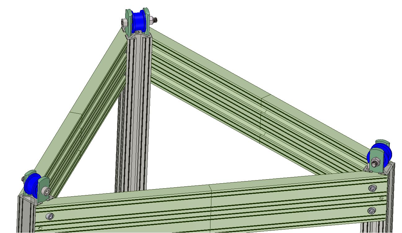

I am building a simplified all aluminum Rostock MAX sized frame to be introduce at MRRF.
The "MAX METAL" frame by Trick Laser
It is the blank frame only, with the precision machine work done. Ends of frame side pieces are machined at a 30 degree angle with a key that fits into slot. Also dowel pin to locate.
The design self aligns perfectly spaced and square, Just bolt it together. Machined mounting holes for stepper motor and idlers will be included also.
(3) vertical 1" x 1" columns and (6) 1/2" x 2" frame sides make the whole frame... simple, strong and elegant.
I am using the same custom fixtures built for machining the NEMESIS Air Delta frames.
This makes a solid & true frame for you guys to build onto.
All the other little bits and pieces are up to you to design.
Actually many of the parts from a stock SeeMe Rostock MAX will work with this frame.
No price set yet, will be posted on http://www.TrickLaser.com" onclick="window.open(this.href);return false;

Boy am I glad I finally put my order in for a V2 yesterday. Otherwise this new frame might have made me hesitate a little. I'm glad to finally be all-in. At some point the research has to stop and you need to just jump in. The only upgrade I ordered were the motor dampers. Also got a .35mm nozzle since I'm interested in high resolution.

The new aluminum frame is a little bit different animal than the full Rostock kit. It's probably better to start with a complete machine first, and do the mods, upgrades, and new builds second. You'd want a working printer to design your brackets and fixtures for the new model anyway.

How are those brackets sized? Perhaps if they were sized correctly they could be used as extra bracing at the bottom and possibly top of the printer? The frame doesn't do much to ensure proper tower spacing as is..

Now that's an idea! Maybe these could be sized to install inside of an existing Rostock... On the V2, you'd probably have to install the control board elsewhere, maybe bump the power supply over a bit... Sounds like something worth testing!

The idea of braces sounds interesting to me too. I am putting the towers in today on my build so I will see how it goes. From my reading the forum though this seems to be a major issue of all of them being +/- 1/8 to 1/4 inch over the length of the tower.

By design the "MAX METAL" frame in self aligning, true, square and sturdy on it's own, you don't need any brackets.
