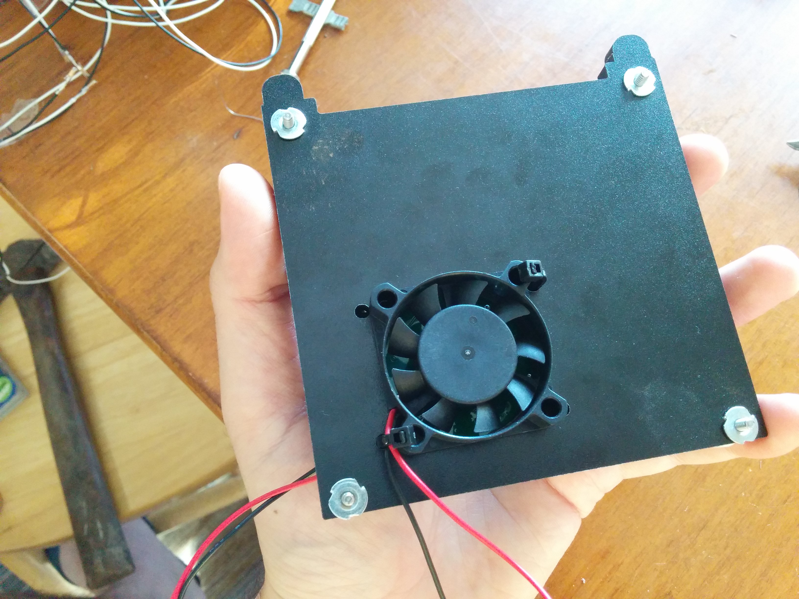

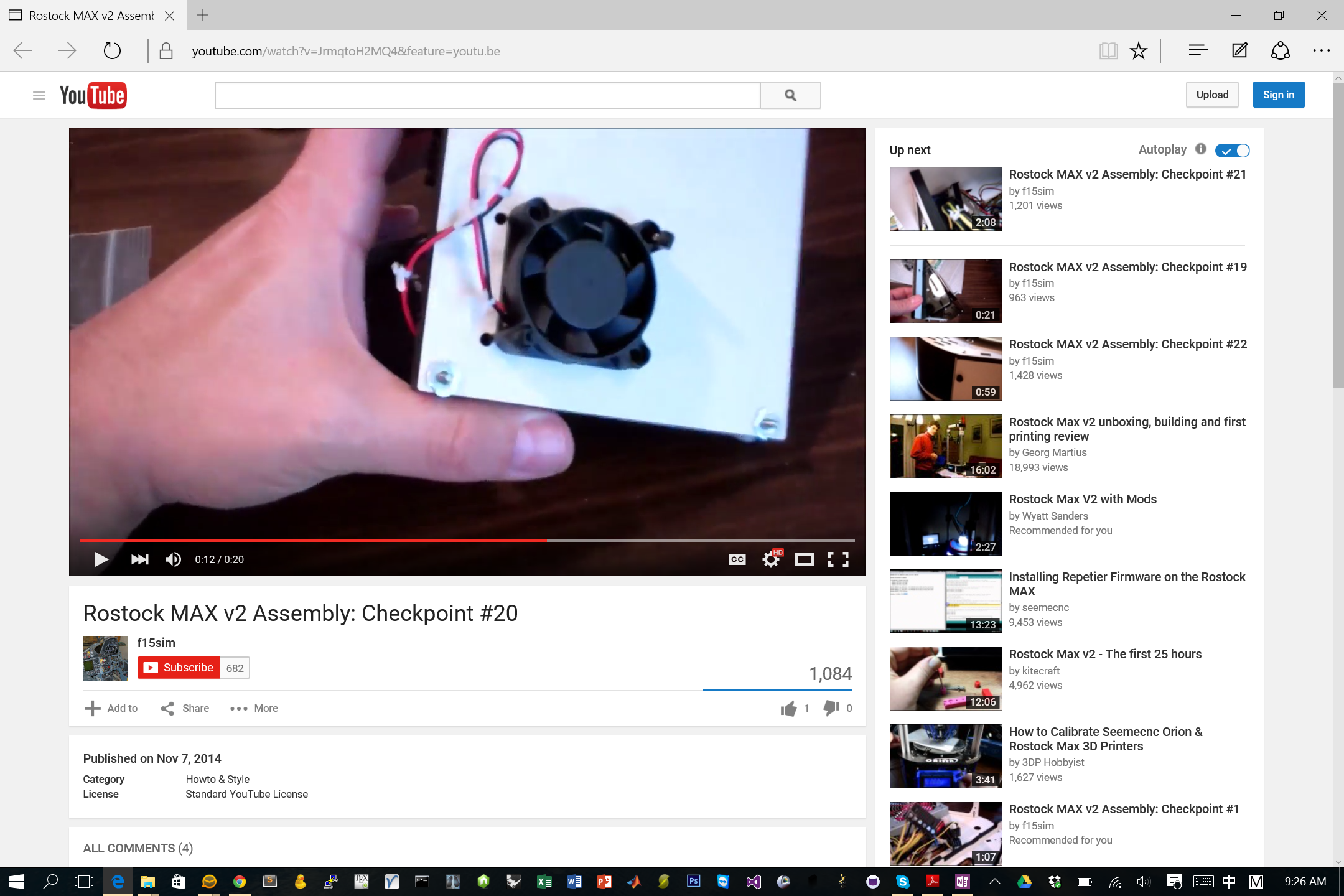

Hay guys,
Just a quick question regarding page 203 and checpoint video #20.
Even though I have the fan case oriented correctly, the fan blades seem to be reversed.
Does this mean I need to flip the wires?
screenshot from checkpoint video #20
my build
my build

cookiemonster wrote:Hay guys,
Red for positive, black for negative.
Posts: 5365
JFettig, he's referring to the blade pitch of the fan. On his fan, the blade pitch is reversed from what mine was - which makes me think that the fan may run in the opposite direction.
I'd contact tech support and ask.
