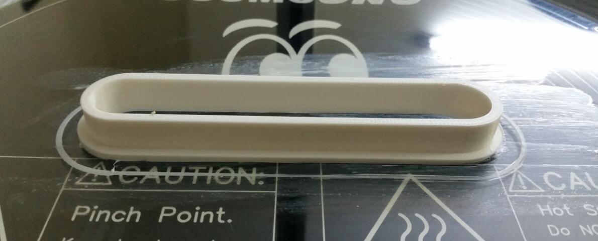

Hello,

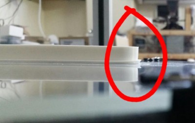

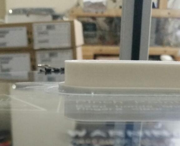

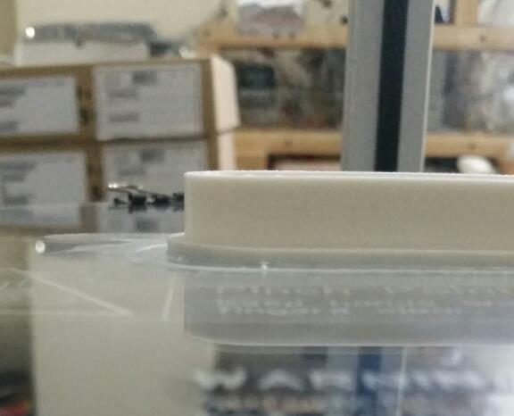

I've printed this part and noticed it is skew from the right side only like pics. Please help me to know the reason and how to solve.

Based on the picture with the red circle, it appears your print partially delaminated from the glass. As it lifted up it moved the edge of your print towards the center of the bed and resulted in the slanted result. Print a quick single wall box of the same approximate size and I bet it will not be slanted.

The part was sticked enough but found x-axis belt was over-tightened so causing extra friction, adjusted it again then problem solved. Printed single wall after adgustment and it was perfect.
