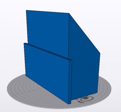

I printed a little thingy... all worked out fine.
Did more reading, tried another thingy to print and now the printer is begining the first layer halfway up the Z axis! HUH???
What happened?

Step 1. Go back and print the first little thing (the one that printed correctly). If it prints correctly again, then you will know the problem is with the other model file or settings when it was sliced. If you can no longer print the first thing correctly, you'll know something about the printer has been changed.

Yup. Did that. Then, downloaded a file to print from seemecnc site. Same thing.
SO.... I did a thorough virus check, and sure enough there was one. Also, I noticed that there were two printers (both the same only one was named and the other was not) on MatterControl. I deleted ALL files from Repitier...thoroughly, again. manually deleted anything on 'puter I could find. And reinstalled, re-calibrated, everything. Works fine now for first print. Just now checking to see what happens when I download that same larger file.
