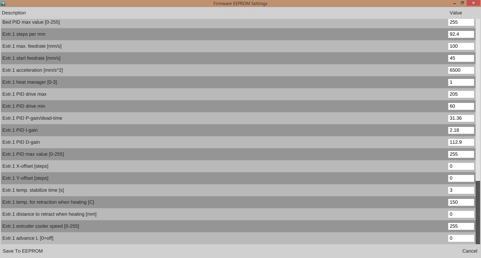

I am thinking that my hotend issue might stem from not holding the top nut in place with a wrench when I disconnected the nozzle to clean it out from time to time. This caused some turning and probably jarred the components loose. Is this a sound hypothesis?

That could be how the thermistor got loose. I've got a config file posted in my build log for a stock MAX for .92 Repetier with the thermal runaway protection enabled. I might have some settings wrong, so if you'd prefer to wait on it for me to test it on a stock machine I have one I can test it on this Tuesday.

I haven't looked at 0.92, but a lot of run aways cannot be detected. I lost my very first hotend this way, the thermistor didn't just pop out of the hole, it creeped out resulting in it reading progressively lower and lower temperatures for a given set temperature, because the creep was gradual, doing what I assume 0.92 does which is detect the case where your applying power and the temperature isn't rising doesn't help until long after the PEEK section of the hotend has failed.
Just make sure the thermistor is secured in the hole with some kapton and you make sure there some strain relief on the thermistor wires, the RTV silicon is not designed to be a structural bond.
