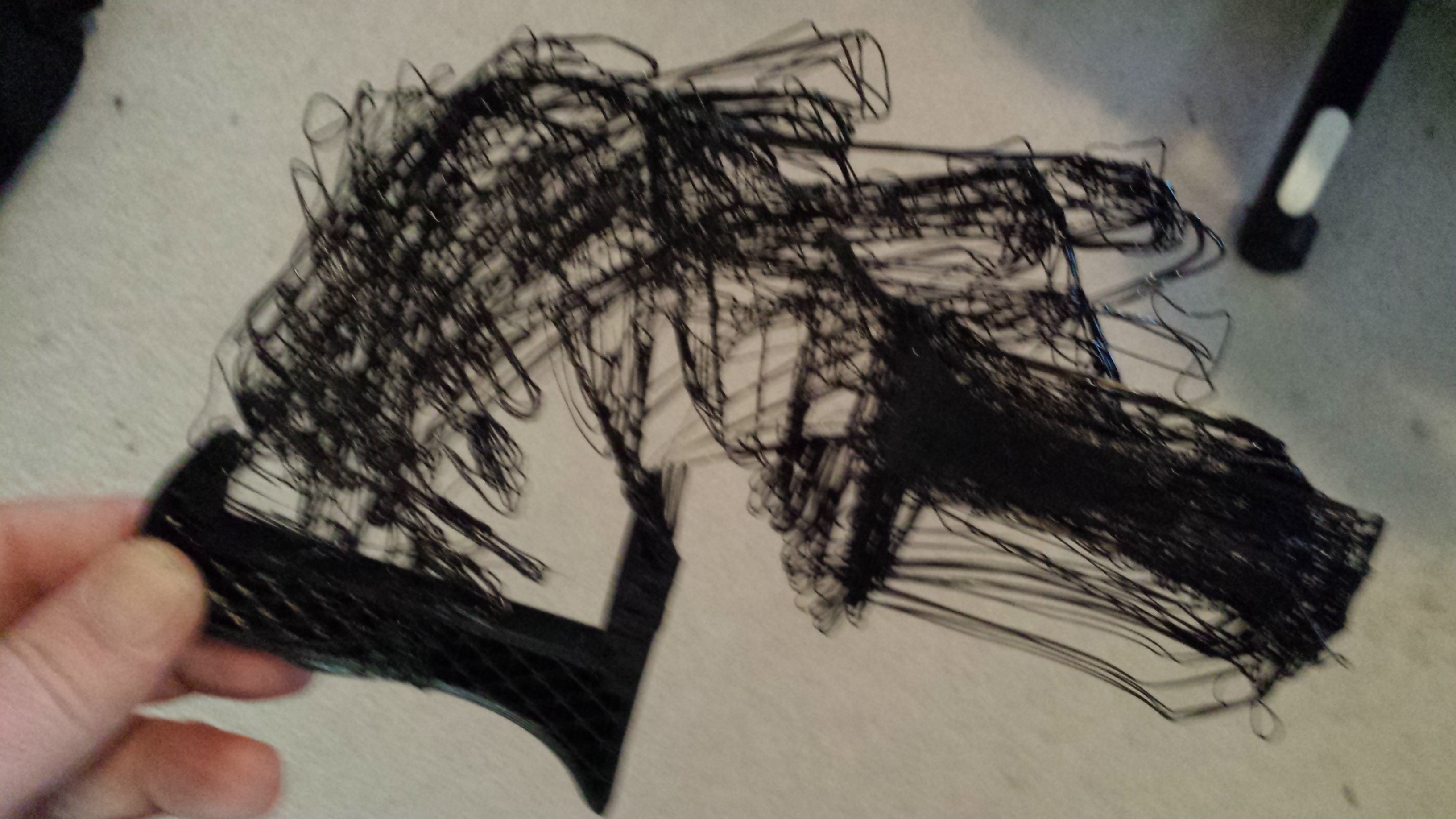

Re: Got my first fail
This is what I woke up to
[img]http://i.imgur.com/03eOnX8.jpg[/img]
I was using the whole print bed, It gouged right into the middle part and the far part(closest to z tower)
[img]http://i.imgur.com/qK13Sys.jpg[/img]
You can see that it looks like it was trying to lay down its first layer of top in that picture for about 1/2 square inch, but that isn't the top of the part.
About all I can guess is that it snagged the shower curtain enclosure... as you can see I'm building my enclosure
Difficult to tell.
I have had things go terribly wrong when a part breaks free from the bed, or if a corner curls up.
It seems the longer (LARGER) the job the more shrinkage becomes a breaking free risk - once the part touches the nozzle all bets are off, filament seems to go anywhere/everywhere.
I have reprinted them, one at a time.
