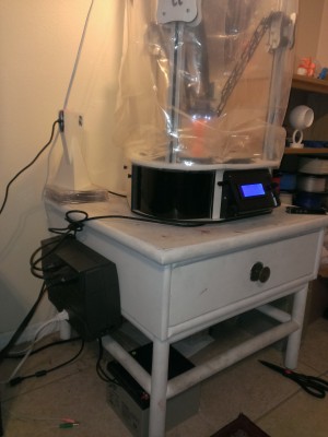

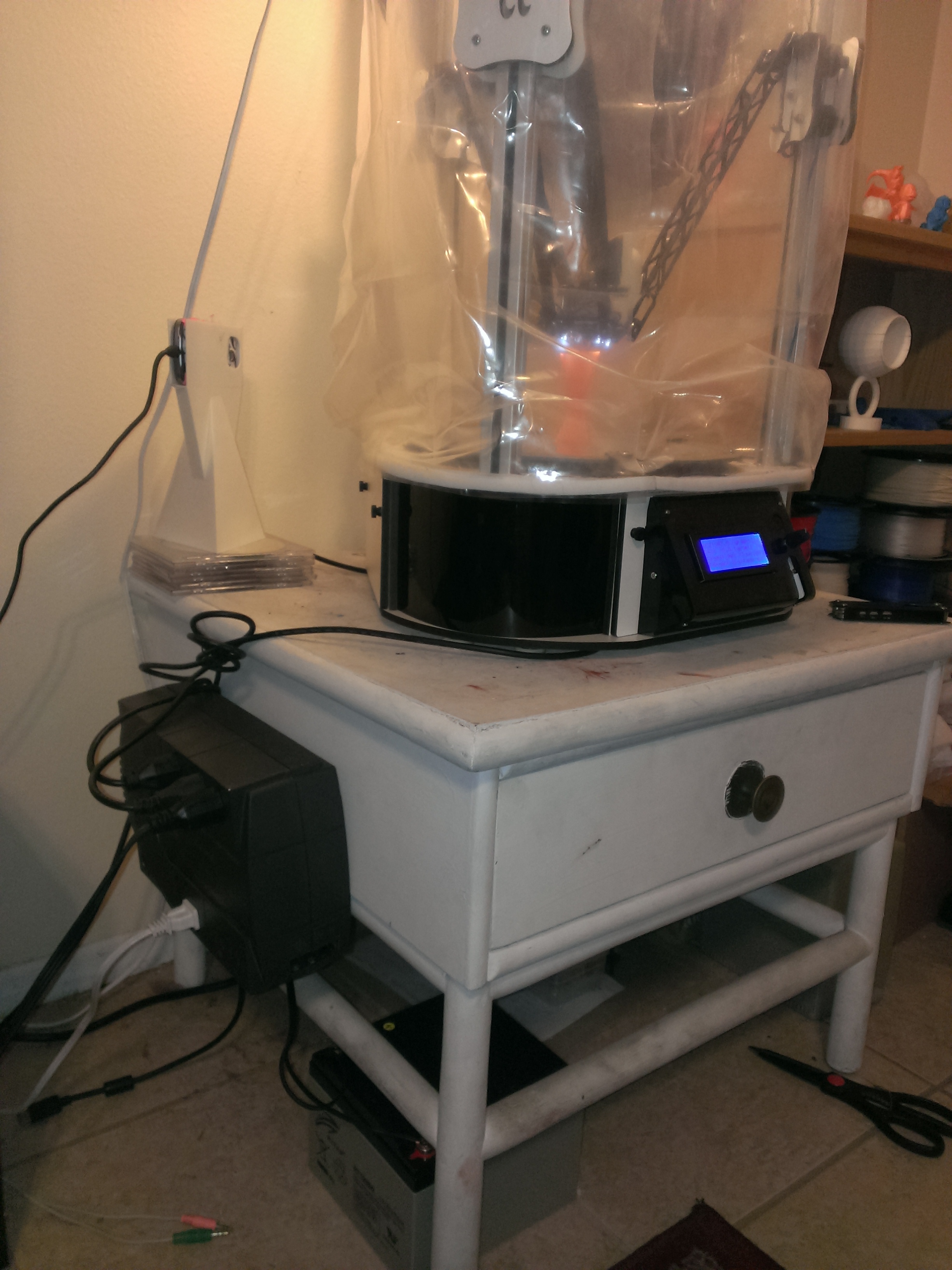

- lightninjay
- Posts: 289
- Location: Tampa, Florida
Re: Anyone use UPS? You can guess why I'm asking...
I'm using an APC backup power supply with a beefier battery than the stock one that can keep my printer running as long as the power stays out. (I reckon it could run for about 4 hours on my conservative estimate, but I haven't run any actual tests other than pulling the plug on the UPS while the printer remained running.
APC Back-UPS® XS 1500VA 10-Outlet Power-Saving UPS
With my laptop running on it's internal battery, and the printer on the back up under full load, I can get about two hours run time with this backup.
