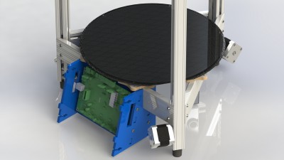

I had seen a posting about the Trick Laser "MAX METAL" frame a couple of weeks ago and was curious.
Long story short, Brian had a frame kit at the MRRF this past weekend and it was love at first sight. The design of the frame is deceptively simple and elegant. It's very rigid and should easily self align and square at assembly for a very accurate build. I have anguished over my own design for while and after seeing the MAX METAL in person, it was a very easy decision... I am now a proud owner of a MAX METAL frame, and the build begins!
Instead of rushing to assemble the frame, I'm slowing down a bit to design up the necessary bits and pieces to perform a parts transplant from from a Rostock MAX v1 kit. Everything is being designed to be printable in a 200mm x 200mm build area. All parts will be printable, but some are designed to be laser cut from MDF as well. Once complete, I will post the parts. I will be using the Trick Laser Trick Trucks for the build, but the original Rostock MAX trucks can be used also.
Design Objectives:
- Reuse as much of the Rostock MAX parts and fasteners as possible. (EZStruder, SeeCNC Hotend, arms, etc)
- Design for the Rambo electronics and the Smoothieboard
- Reuse the stock ATX power supply
- Full Frame
- Electronics Housing
A mashup of the Rambo and Smoothieboard are shown. The extruder wire exit at the bottom.
- Power Supply
- Under Belly
I'm still roughing out the design. I need a part to secure the Oynx insulator to the frame and need to design end stop switch mounts, etc.
I'm also considering drilling a couple of holes in each vertical extrusion to route the end stop wiring through the center hole.

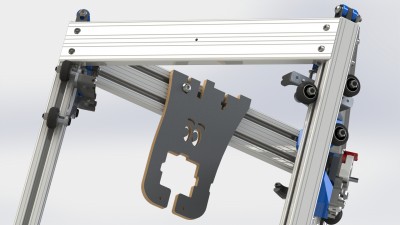

Switch bracket design complete. It reuses the same Omron switch and fasteners. The t-nuts and screws are reused from the original as well. The Trick Trucks with SeeMe CNC U-Mount are being used.
- Switch Bracket and Trick Trucks
I've also designed up an alternate idler assembly that better matches the 20 tooth GT pulley. It uses 2 11mm dia x 4mm thick bearings. The outer sleeves are 3D printable and center the belt with a small amount of clearance. The inner races are clamped tight. A length of heat shrink tubing over the bearings will create a near perfect match. I've been using a similar assembly on a Cartesian printer with very good results.
- Idler Cutaway

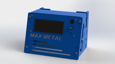

More work on the electronics enclosure today...
- MAX METAL
The front cover houses the stock Reprap Discount LCD controller.
The top cover is just an interference fit. It should stay put, but will keep dropped parts out of the electronics.
There is room for a 40 mm cooling fan on either side. If using a Rambo, the fan goes on the right. If using a Smoothie, the fan goes on the left. Both boards will require 1/2" spacers. The extra height is to move air around the drivers on the top and bottom sides of the boards. The Smoothie design is based purely on CAD data as I do not currently have one. I use a 40 mm today on the Rambo in the same configuration without issue.
The spacers are printable, but they could be purchased or lathed if desired.
More pictures below...
- Enclosure Only
- Back side
- Cover Removed - Rambo Electronics
- Smoothie Version

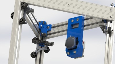

EZStruder mounting bracket is complete. It uses a couple more 1/4-20 t-nuts and will require a longer screw than stock to mount. It's beefy and should be printable with a sparse infill to keep filament usage to a minimum. I wanted it stiff because the mass of the motor is cantilevered.
- EZStruder Mount
- EZStruder Mount - Backside
An alternate route is to take the original mount and drill out the nut locations and bolt it to the frame using the t-nuts and stock screws.
- Alternate mount
