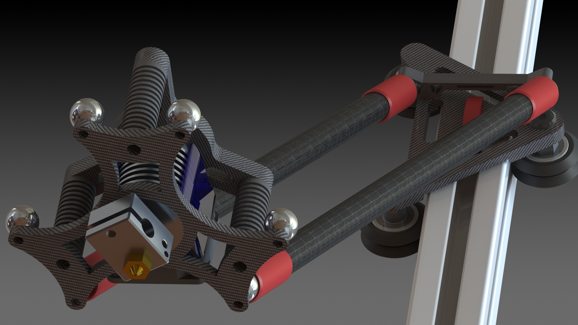

That´s actually my favorite idea for the effector and trucks made of Carbon Fibre.
Just a plain effector for the E3D-V6 without probemount, LED´s and other schnick-schnack (sorry for the german phrase, but have no engl. word, maybe "no nonsense" ?)
More "spacy" than the other one. And standoffs are no longer in conflics with the arms (thanks again, Brian!)
But actually only all theory. If it works - I have no idea!
But as soon as I´m at home and have little time I will mill it and check if it will work on the Max-Metal...

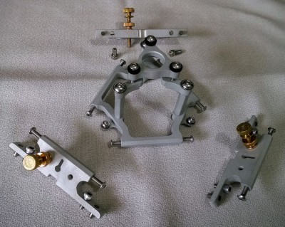

MAX METAL Effector Platform, J-Groove Mount and Carriage Arm Mounts, final version up on web site...
http://www.tricklaser.com/MAX-METAL-Pla ... L-PLAT.htm" onclick="window.open(this.href);return false;
OMG I need this! When will they be in Stock?bvandiepenbos wrote:MAX METAL Effector Platform, J-Groove Mount and Carriage Arm Mounts, final version up on web site...

Hey all, thanks for your kinds words and support.
I have a small batch of aluminum platform sets in hand from my local waterjet guy that I am in the process of doing the CNC work, drilling, tapping, finishing, packing, etc.
My goal is to start shipping out the platform kits by end of next week.

I send (6) M3 x 20 screws with the frame for mounting motors.
I hate to say it, but you really should not put the t-nuts in with flange around thread facing out. They are designed to face in. If you put them in backwards they will not clamp in slot properly.
If you need to add t-nuts after assembly, they make some that will "roll in" from the side.
https://youtu.be/nK-DsJxAdwM" onclick="window.open(this.href);return false;
You should use the bolts, spacers, eccentrics, and precision washers from openbuilds.
The screws are M5 x 30
I have a link on Trick Trucks product page listing what hardware to buy along with the v-wheels.
http://www.tricklaser.com/Trick-Trucks- ... TRUCKS.htm" onclick="window.open(this.href);return false;
Tricks Trucks will NOT work with the stock SeeMeCNC wheels, bearings or spacers. (as it says on product page)
What do you have to change around in the firmware to get those going? I'm guessing current to match the motor spec. What about steps_per_mm ? Anything else?626Pilot wrote:You can get 0.9-degree steppers with 58 oz-in. holding torque for $22 each at Amazon. Haven't wired mine up yet, but if I'm not mistaken, the stock 1.8-degree Kysan motors have something like 54 oz-in. Not bad, for twice the resolution.
Does it make much difference to print quality and can the smoothie keep up with the extra calculations?
