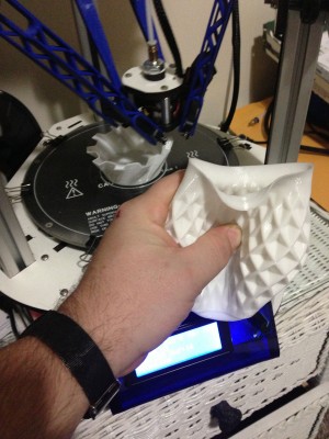

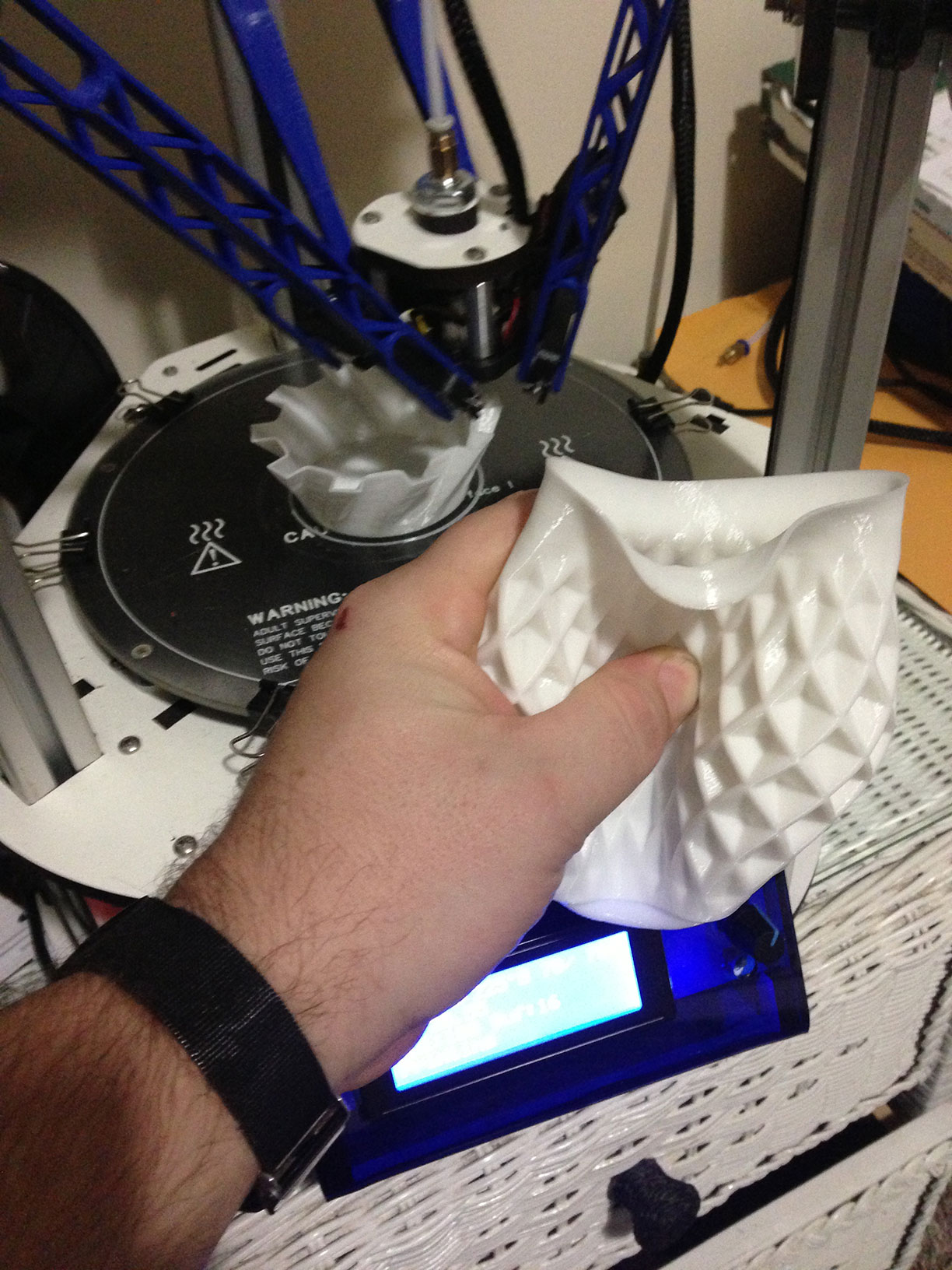

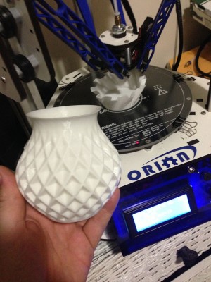

I dont know what kind of stuff I'm printing with but I decided to try the flex filament I have here with my Orion... ezstruder, and stock hot end... 225c hotend, but you have to print slow... think I'm at about 28mm/sec currently, any faster and it jams in the extruder (bends before bowden tube) but I'll throw on a pic..

That's some impressive stuff.

this was a testing purposes only spool.. the filament isnt for sale yet, its polyflex (found the box) and after looking around the website couldnt find it, and its only on the kickstarter.. https://www.kickstarter.com/projects/19 ... top-3d-pri
I saw ninjaflex at MRRF and that stuff was awesome.. the guy who was printing it was running it on a kossel mini, so I remembered I had this stuff and decided to try it... its not bad.. want to try ninjaflex or anohter style in the orion to compare....
