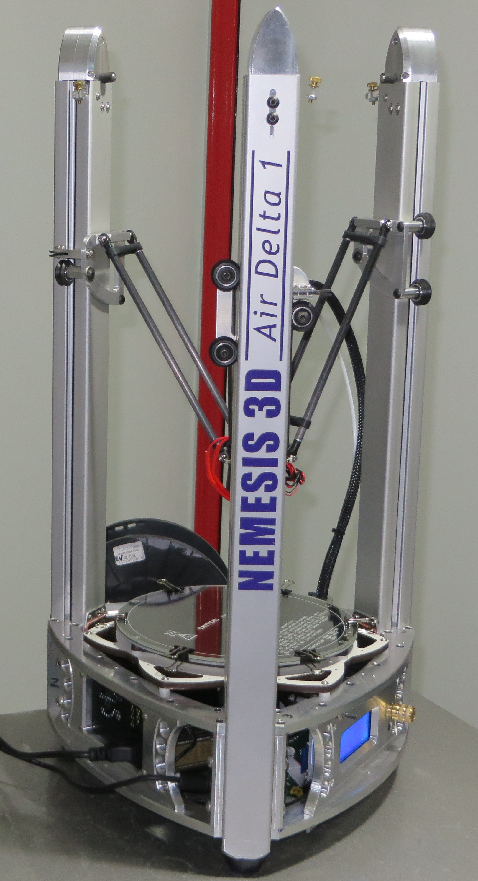

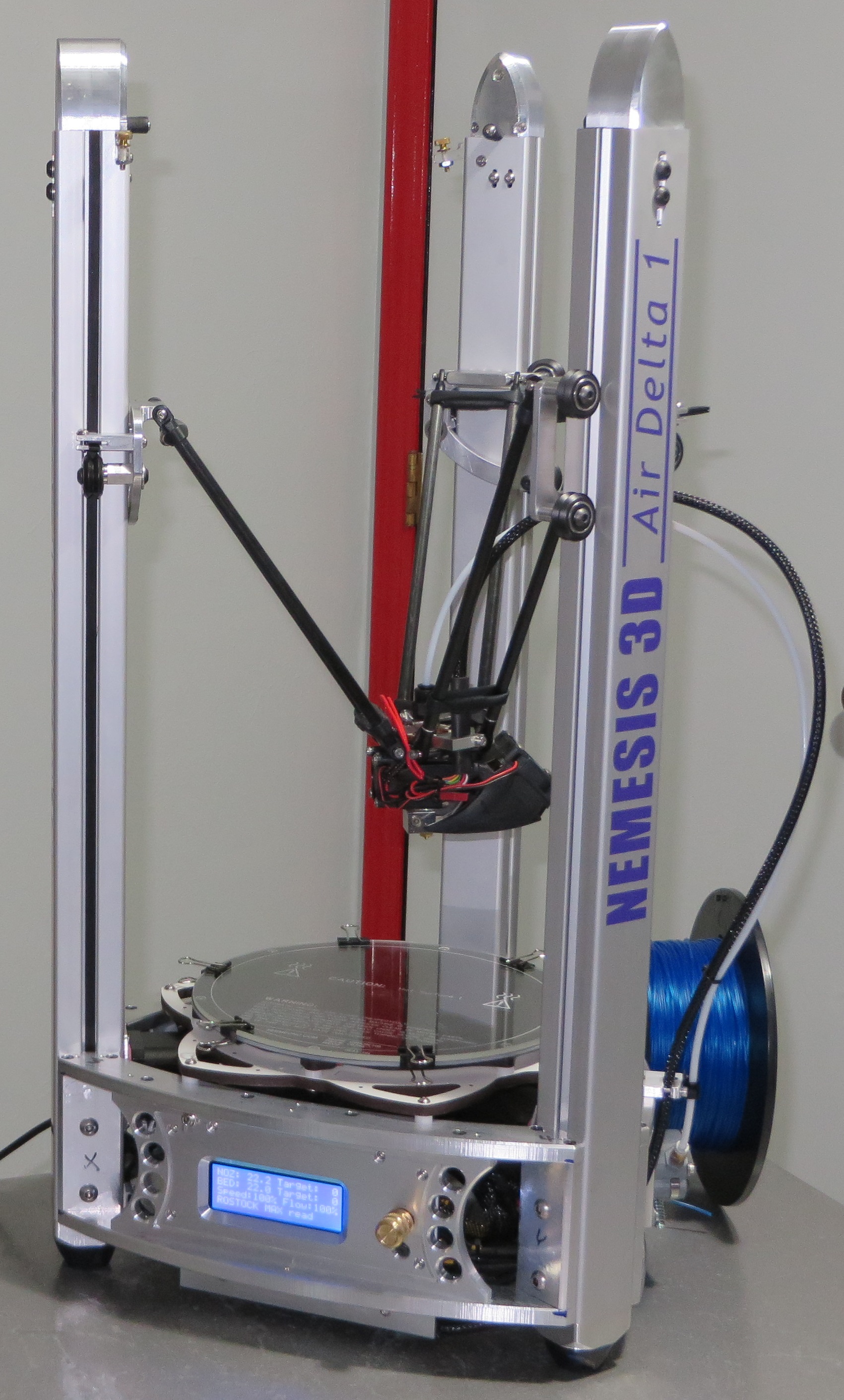

NEMESIS Air Delta 1 all metal printer
Printer I designed and built. Finally alive!
Tweaking the firmware now, should be printing in the next few days.

Re: NEMESIS Air Delta 1 all metal printer
thanks Jim.Jimustanguitar wrote:Looks awesome, Brian! Can't wait to see it move in person.
I will bring it to the Makerhive on Thursday.
Thanks Gene.
I have revised the design for iteration 2 to require a lot less machining... so cost will be more reasonable.
Still all metal and same basic configuration. Frame sides one piece instead of 5, move top idler down inside extrusion with a simple flat top cap.
Hi Eagle, thank you for the compliment.Eaglezsoar wrote:Brian, that is the most awesome looking Delta I have ever seen.
One H of a good job and I congratulate you for developing something so great.
Now I know what you were talking about when you said you were working with a lot
of aluminum. I am truly impressed!
I love machining things from aluminum and building machines.
The goal is to build a reasonably priced all metal delta printer that is precise, smooth, sturdy and fast.
With it we can explore pushing the limits of FF printing even further, I believe we have just scratched the surface of what can be done.
Very nice, I take it you have tested the columns during arm fast movement, for vibration dampening.
video of first moves...
yep, no problem with stiffness or vibration...joecnc2006 wrote:Very nice, I take it you have tested the columns during arm fast movement, for vibration dampening.
http://youtu.be/Q5k94l6YaH4" onclick="window.open(this.href);return false;
are those v rails? how do you like them?
It is not vrail or maker slide, it is plain t-slot extrusion I found on ebay.bubbasnow wrote:are those v rails? how do you like them?
the wheels are from open builds, made for the maker slide extrusion.
I really like them, they work great in regular t-slot aluminum extrusions also.
they have dual bearings and are quite sturdy.
open builds offer several variations
very reasonable priced $3.95 per wheel kit
http://openbuildspartstore.com/wheels-b ... estselling" onclick="window.open(this.href);return false;
