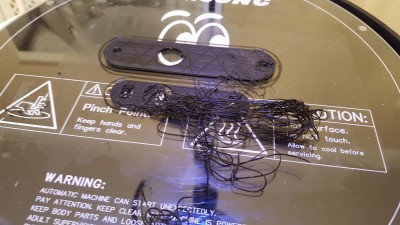

Sunday.. Design small enclosure for a project in Tinkercad.
Monday.. Try printing it, but if fails after coming unstuck from the bed
Tuesday.. Try again, but this time you didn't notice the slicer failed and you end up with some bizarre extra layer that ruins it half way through
Wednesday.. Try again, but you have a power cut and it stops the print at 50%
Thursday... Try again but it curls so badly you have to bin it
Friday.. The print head jams and you spend 2 hours cleaning the nozzle, heater block and recalibrating it all
Saturday.. You go to Maplins and buy the same enclosure for £2.29 and decide that 3d printing is the most unrewarding hobby ever
Sunday (tomorrow)... Pack printer away

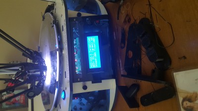

Spent the time this week? Spent the time this past 3 months.
There's dicking around, and there's coming to the conclusion that this thing swallows up far too much time for so little reward.
I always knew these things needed a lot of attention, but not this much.
Anyway... it looks pretty

Can you post your STL file for what your trying to print?
Large rectangles with 90 degree corners are prone to lifting right at the corner due to shrinkage so a very warm room or enclosure is needed to minimise it.
Breezes from open windows also really don't help along with if you accidentally run your layer cooling fan with ABS (normally you don't run your cooling fan with ABS but it does have advanced uses in specific scenarios).
Adding a brim can help or modifying your model with essentially thin discs 1mm thick or so intersecting each corner in your modelling software, this gives you a large contact patch at each corner.. you then snap off the excess of these temporary discs and smooth off with Acetone (Propanone) for ABS.
I've used this technique for many prints when I need a high contact patch area the model doesn't possess but needs to print well (essentially a hand made bespoke brim for specific areas). You could also make sure your model doesn't have sharp corners if that's possible.. looks better imo also.
How you slice, fill density and type obviously also influences the shrink percentage in any direction.... hexagonal is quite good in my experience.
PLA is much easier as it doesn't shrink as much so rectangular boxes are much easier in PLA.. but with experience and a calm logical approach ABS is doable for this type of object, it's not rocket science but there are numerous variables to account for so unfortunately there is a bit of a learning curve.
Myself personally at first with ABS I wasn't using enough glue as my experience with PLA was I couldn't get the prints off with large contact patches.. so this carried over into initial ABS failures.
I personally use repetier with Slicer or Cura and inspect every prospective print after slicing before I commit to actually printing it. 2 minutes doing this on a multi hour print is worth doing. Not sure about Matter Control as I gave up with it and moved back to Repetier as the latter is more reliable with some functionality I need that MC doesn't have...

Might I suggest looking at other filament options? ABS absolutely sucks to print with and there are lots of options that provide equal or better mechanical strength without any of the warping, curling, or bed adhesion issues - namely the PET/PETG filaments (PET+, nGen, Colorfabb XT, nVent, PETG, etc)
Re: Diary of a RoStock Max V2 print
There are several reasons your print might not be coming out as yo wish. i have made a list of all my print failures and what might have been the reason. Most things are really simple. I put the Rostock max V2 together from the kit and I couldn't be happier with it. I am no electrical engineer or any thing close to it. I am mechanically pretty good and took my time with the construction.
After using ABS and PLA filament i pretty much use PLA exclusively now.
Printing a small item can be challenging. A small base does not give much surface area to stick to. Are the layer fans all turned off or at reduced fan speed (PLA)? Are the X,Y.Z arms and bed adjustment pretty good. paper drag test. Consider printing a raft around around the base to give more stability. Are the skates snug against the rails. Are the motor belts snug and not slipping? Readjusting the top motor pulley is needed at times. Decrease the speed of the axis movement, 300 mm/sec may be too fast and knock it off, try 100mm/sec. If a print is going to take several hours,make sure your computer never goes to sleep.
I print something almost daily and have wonderful results. it shouldn't be frustrating to get a decent print.
Of course sometimes Matter Control quits unexpectedly and the print stops. Then you must "home" the axis arms back to the top and begin again.
If all this doesn't work then the problem becomes trickier. Are all the wires on the Rambo board attached properly? Any rogue strand of wire touching another one? Are the soldering points all good on the Onyx board? Hot end connections all good?
Check and recheck connections.
I think most of the Rostock Max owners are happy with the machines they built. For the money it is a very capable 3D Printer.
Hope your machine gets you results you are looking to achieve.
Good luck.

The machine is dialed in pretty well I think. Paper test under the nozzle is perfect centre and each tower.
Belts etc are all fine.
I don't like PLA. Its brittle and not much use for my projects. Plus, I did have nozzle blocking issues when I used it.
I have ordered a different roll of filament and I will try that. I certainly cannot use the printer for its intended task - custom enclosures... I just don't have the time available to faff around with it anymore.
I will stick with using pre-made enclosures, and this will just be a large monument in the corner of the dining room for now.
Maybe when I retire, can spend more time on it

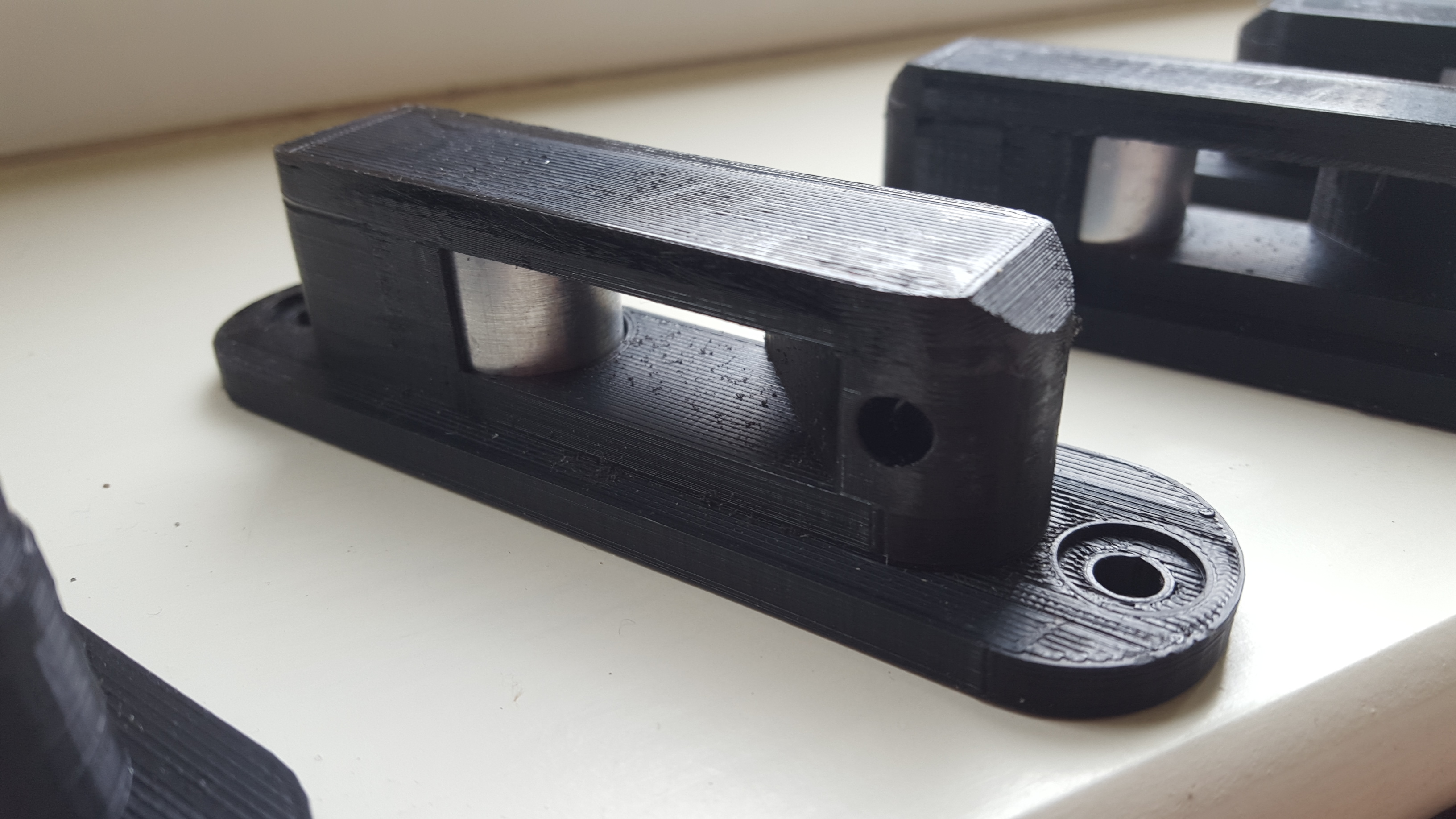

Well I bought some Petg and had another go last night. Not a bad first print really. Didn't curl (although only a small test print).
Tonight... nozzle jammed solid.
This hobby sucks the big one and I am not wasting any more money or frustrating time on it

Well I have tried over and over again. Altered retraction, speed, extrusion speed etc. Just cannot get a decent repeatable outcome.
I need 12x brackets for a project and I can't waste any more time trying to print them. The Petg seemed a bit easier to work with at first, but its stringy and oozy... goes all over the place. That leads to lumps which the head then crashes into.
First decent offer for the printer and its gone. Patience expired.
