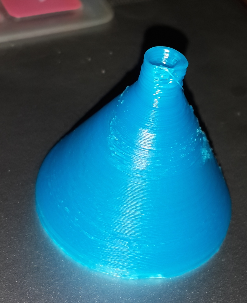

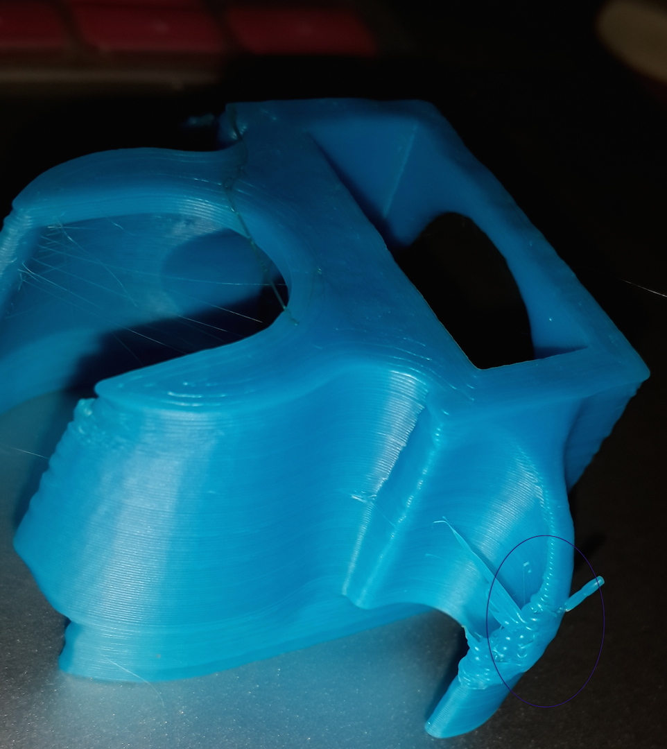

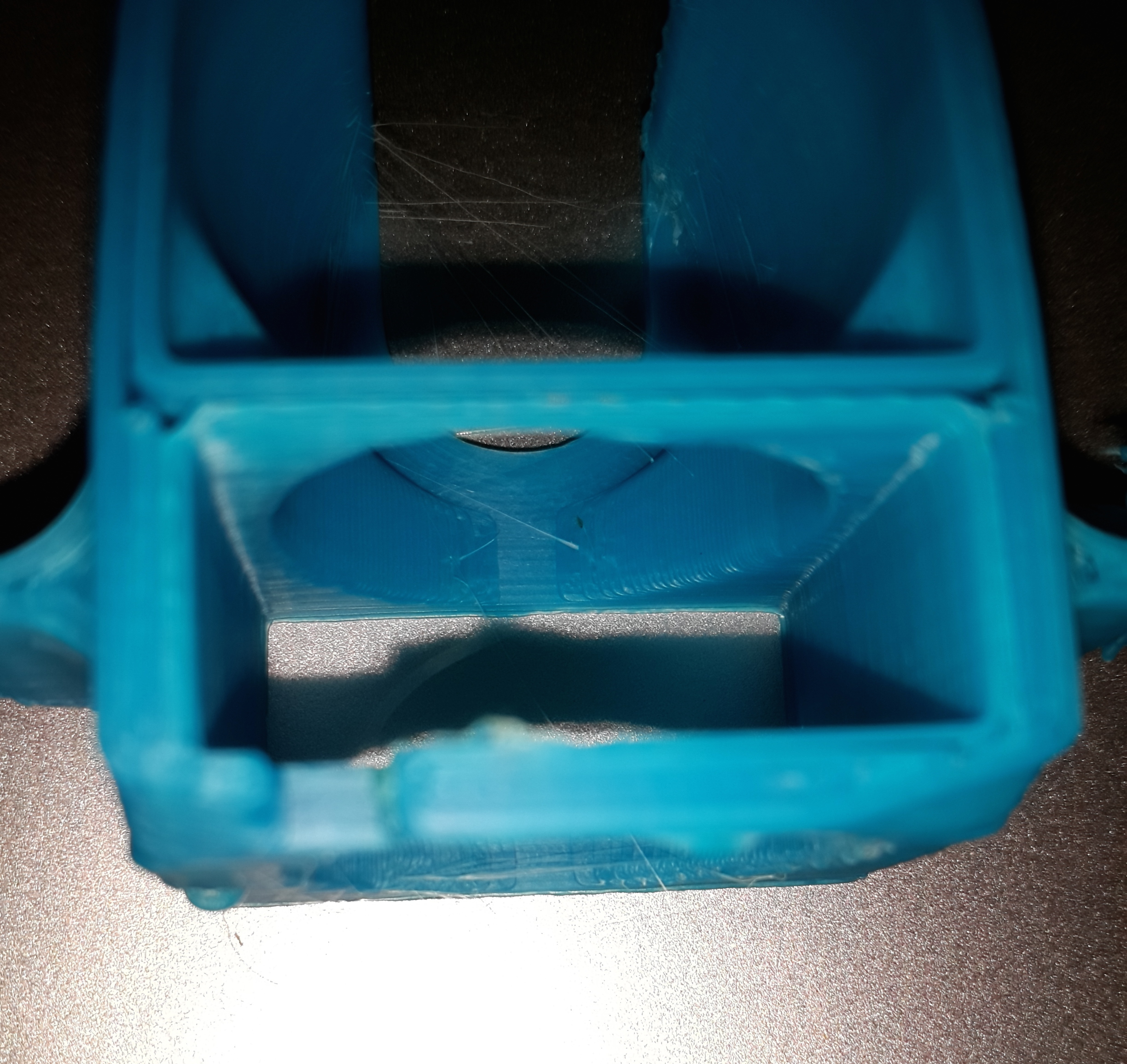

Kind of a noob here... As you can see I am still printing the fan shroud.
What do you recommend to slice the prints? PS: I am using a Mac.
Re: How to make beautiful prints
When I first started printing I was backwards with my printing temps and printed abs at 195 without much issue, but at the layer height increased off the bed the print layers began to separate. so it is possible to print at abs at low temps IMHO.
Im am partial to cura for a slicer, but I run a pc. If there is a mac version please give it a try.
Have you added a cooling fan yet?? one to cool the filament below the nozzle that is. Might help you out. I have been printing for all most a year and still havent added one but have seen where they can be very beneficial when printing the tips (small high points) on smaller prints. I only run 50 c on the bed for both abs and pla. Abs juice to get the print to stick has worked the best for me (for abs). I would suggest trying the colorfabb filament as it is easy to get good adherance and great prints.
Im not the best source for guidance, but to me it looks like your under extruding and could use some cooling on th print.

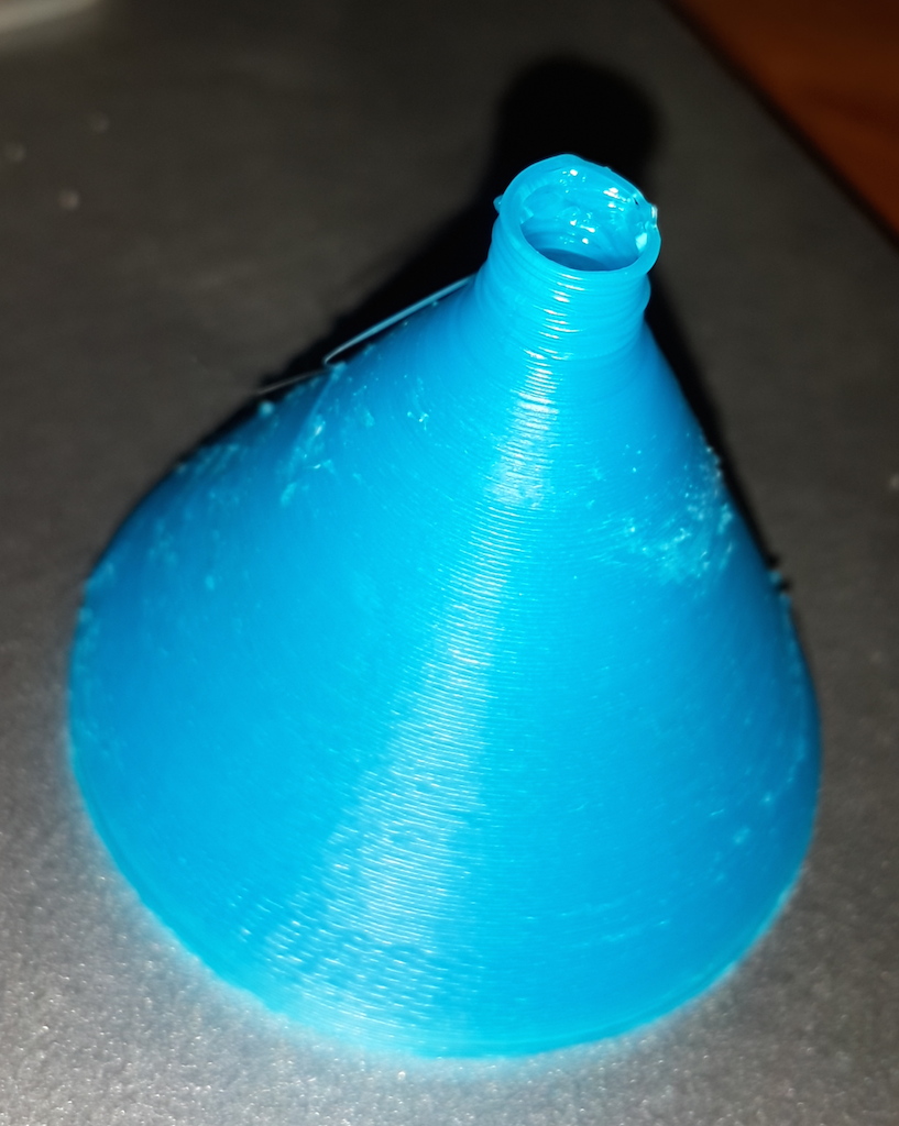

Yep, i noticed that cooling was important.
The best print of the shroud i got was with 2 of them printed at the same time.
Would printing on rafts have an advantage? And how does one go about doing that?
Fiddling with CURA at the moment.
That shows its a cooling problem. IMHO No cooling on the part I assume??? keep going with the multi part print, and lower the print speed to allow more time to cool.teoman wrote:Yep, i noticed that cooling was important.

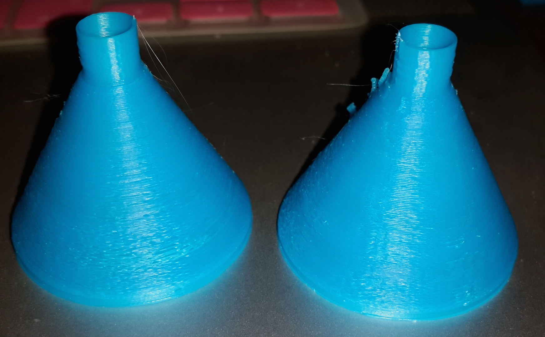

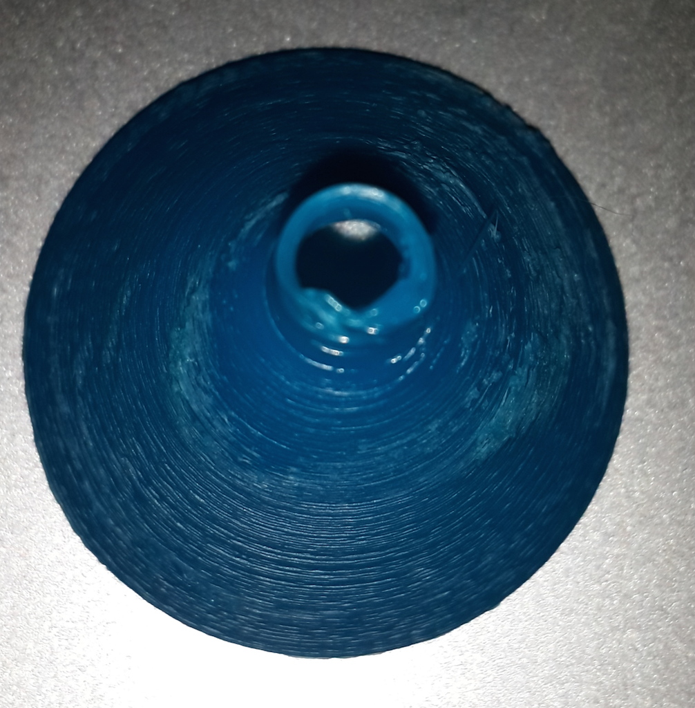

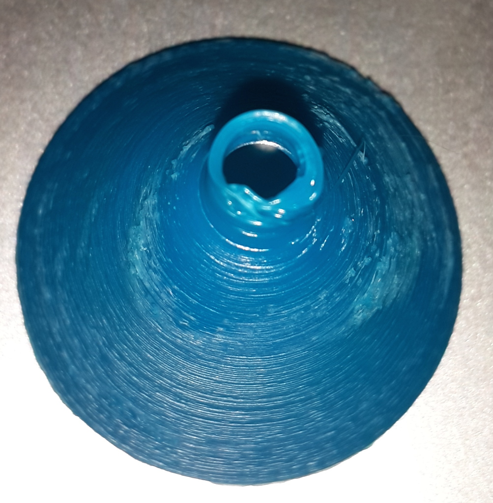

I printed this funnel for the filament entry point.
Speed %200
Hotend 230 C All the way.
Bed 80 C All the way.
Now i am printing 2 of them with %75 speed.
Speed %200
On cura i selected DeltaBot while it was asking for a printer. Then it ocurred to me that delta bot is probably a brand name. Anyone have the configuration info for CURA? Link will also do.

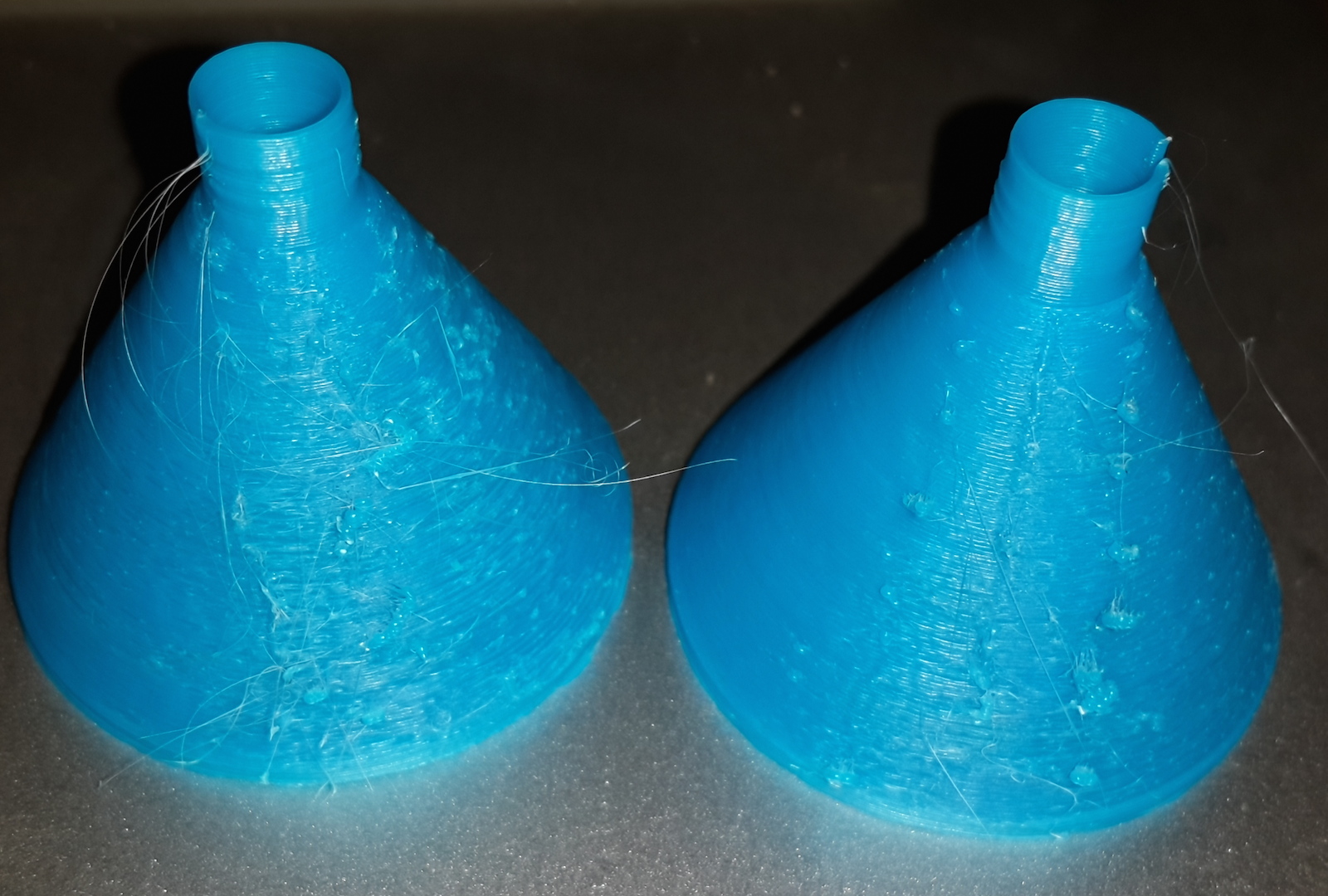

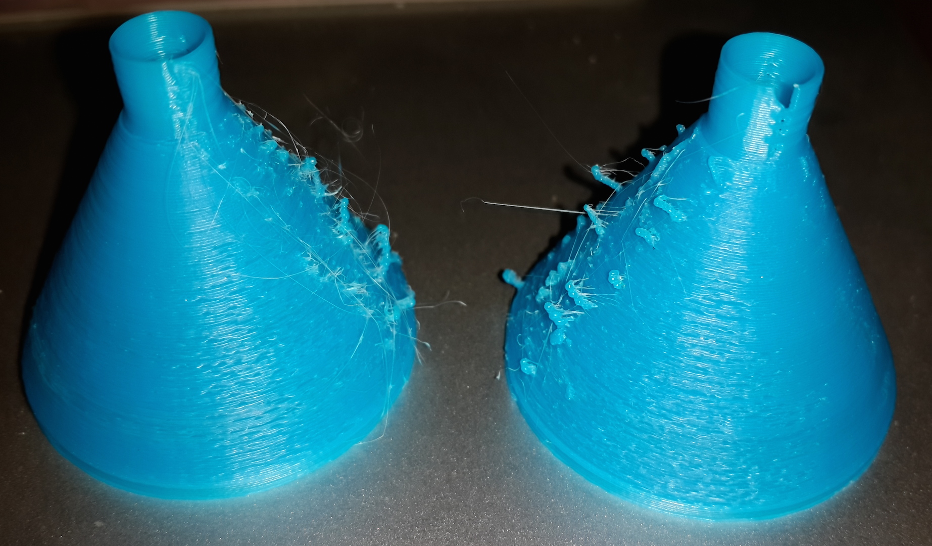

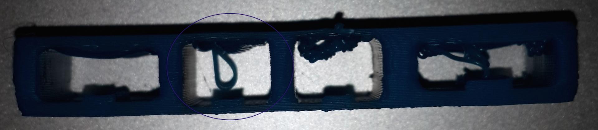

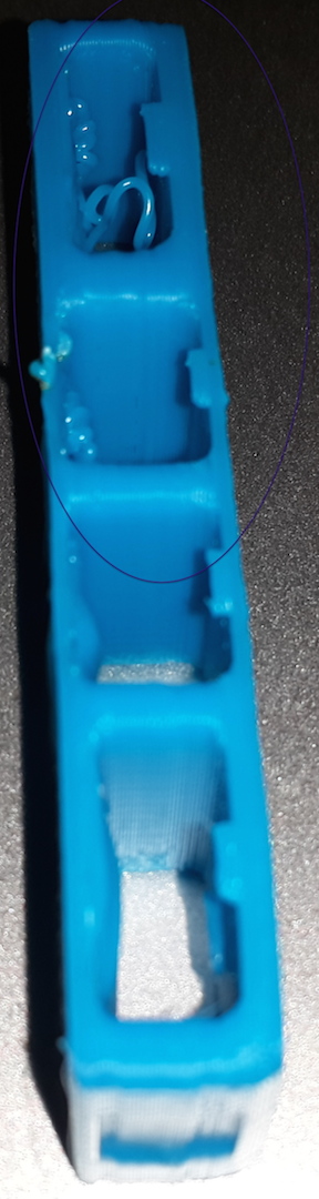

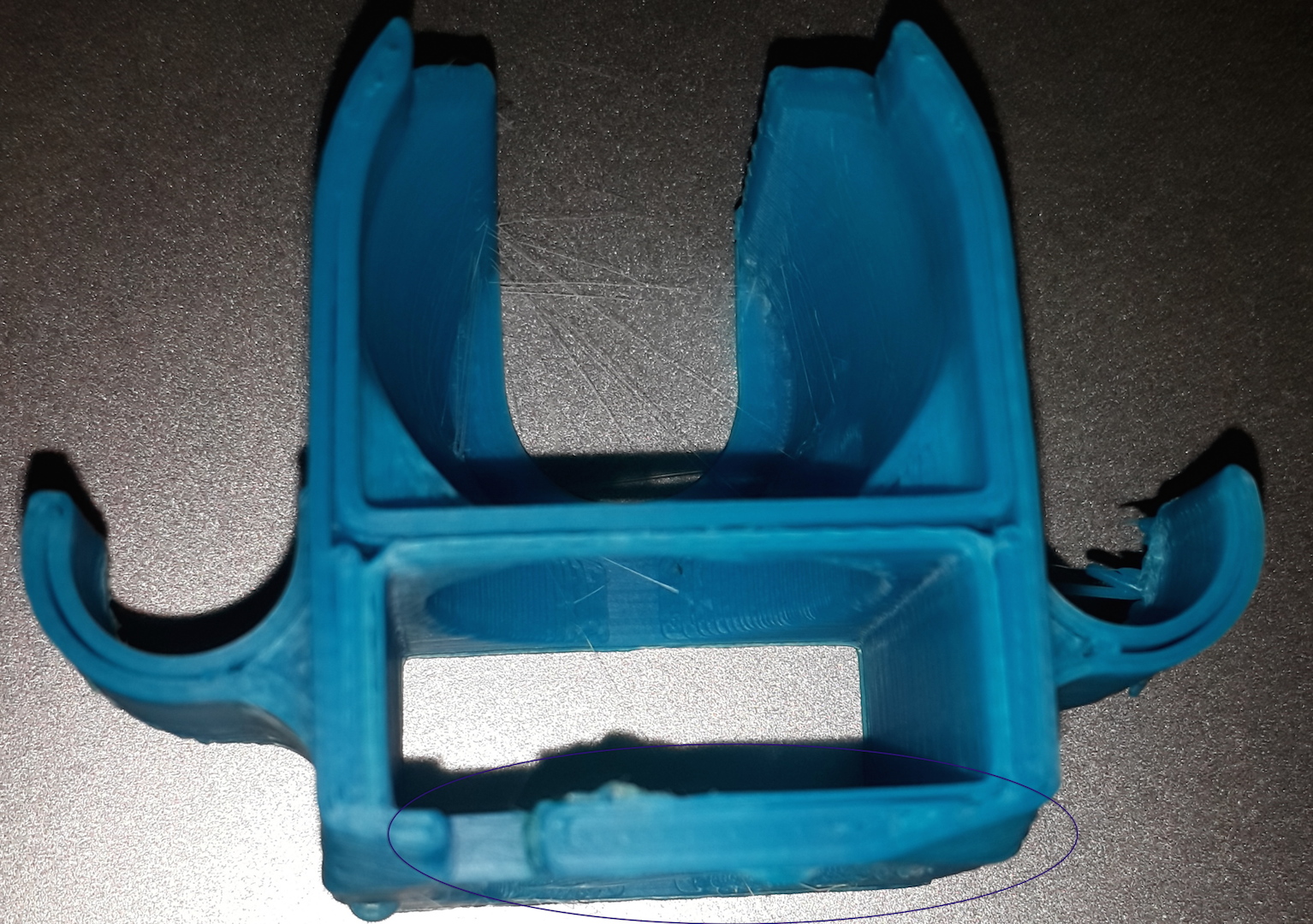

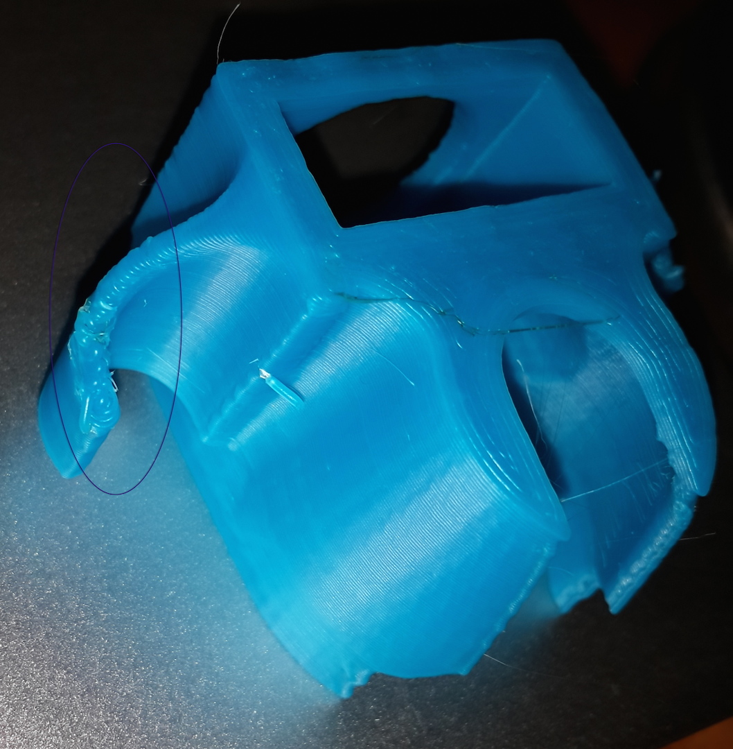

So my prints are ready.
THe sides that face each other have lots of artifacts.
The other sides are much better, however, they do not have the standard layer lines, it looks almost as if the layers have cross fused. On some parts, i think the layer has been slighly pulled towards the inside of the funnel.
- Posts: 2631
Fully agreed. Keep the bed temp up the whole time, and higher if possible. Any shift in this will make the part expand and contract and break loose.Polygonhell wrote: FWIW I would not drop the bed temperature after a first layer, 80 is marginal for ABS to start with, I'm surprised the part doesn't detach when the temp drops.
Thank you for the tips. The parts have started to look better with the bed constantly at 90 degrees.

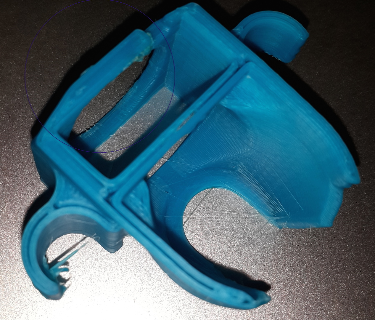

FInally got round to installing the PEEK fan.
Now i have bumped up the nozzle temp to 245 degrees, and the bed is at 90 degrees. Will see how it goes.
Speed is at %75
Speed is at %75
