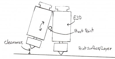

Hey guys,
So I have two Max's, one at my work, and another at home. Both are running E3D hot ends and upgraded arms and both work wonderfully. But the time has come to move forward with the dual head setup.
I have spent some time designing a mounting system for the dual heads that incorporates cooling fans and all that good stuff. I know aligning the two heads has been a persistent problem, and my design doesn't really do much to improve upon that issue, I was mostly just planning on using some thin shims under the mounting screws on one of the heads if it needed adjustments.
One of the problems I can foresee with dual heads is that the one nozzle not printing will be dragging along in the exact same plane as the nozzle that is printing. Often my prints curl up a bit on edges and corners, or I get a bit of extra plastic in places. This extra head moving around in the same plane will inevitably come in contact with the printed part and cause it to break loose or disconnect one of the mag arms.
So, I was thinking how neat it would be to design a dual head mount that articulated with a small solenoid or servo motor. This would allow one of the heads to swivel up a few degrees and clear the part while the other head is doing its work. Then when its the other heads turn the solenoid switches and the other head rocks into place. This would give clearance room for each print nozzle and eliminate any problems with the other head being in the way.
I can design and build the mechanical system easily enough that allows this to happen. And would be more than willing to share my design with you guys, but my hold up is the software. How hard would it be to include a command in the G-code or update the firmware to send a signal to a servo whenever it switches from one head to another? And what pins on the Rambo could I use to do this? I hope this is a trivial question for some of you guys :D
Any help or direction would be appreciated.
Here's a rough sketch of the concept.

I like the idea a lot, but I'm not the coding wizard that you're looking for.
Mechanically, I think this could easily be done with a servo or gear reduction motor of some kind.
It will be very interesting to watch this develop!

I have never given it much thought but if the dual extruders are exactly the same height then the second extruder should not hit the curled part any more then the printing extruder
would. Dual extruders are becoming more and more popular and they seem to work fine without such exotic solutions. If they work without having to raise the non printing
extruder then yours should also. All printers experience the curling part problem at times including those with dual extruders and I have never read of any problems with the use
of the dual extruders such as you describe. I have never ran with dual extruders and I do not claim to be an expert but I have to question if your exotic solution is really necessary.

Instead of a servo, why not mount both heads on a slight tilt like this:
I'm showing 5 degrees but perhaps it doesn't need that much.
Then depending on the head being used, the code adjusts the arm mathemagics to tilt the effector plate (I think that's it's name) by 5 degrees to position nozzle 1 correctly or -5 degrees to position nozzle 2.
Not sure what sort of nightmares this might cause to geometry, but it's a thought. :)

McSlappy wrote:Instead of a servo, why not mount both heads on a slight tilt like this :
The effector cannot be tilted through the 3 axis steppers. It is mechanically impossible.

Tis true, the geometry of the system would prevent that... but a pivot mechanism within the effector would. An Electro magnet set up to switch N/S would do the trick.
Eagle: Astute question... might not be enough of a problem to have to solve on a well calibrated machine.

Eaglezsoar wrote:I have never given it much thought but if the dual extruders are exactly the same height then the second extruder should not hit the curled part any more then the printing extruder
You make some valid points. And there are many dual heads that are out there and are working fine with fixed heads. So I will likely just go ahead with a fixed design and see how it performs and then if any of my imagined problems surface I might continue to pursue this "exotic" idea. You mentioned that the second extruder shouldn't hit the curled parts any more than the printing extruder, this is true, but the active extruder is generally following a path that coincides with the curl, thus limiting its likelihood of catching on the part as it moves about. Plus the extruder is hot and often melts its way through the high spots. The inactive extruder would have nether of these advantages while tagging alongside the other. But perhaps I am way over thinking and making it more complicated than it is.
