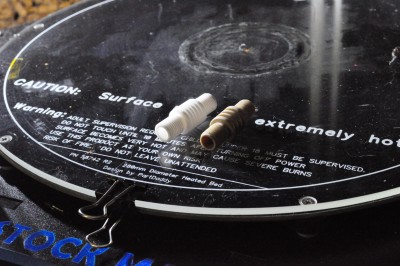

Macor cuts way easier then I thought it would.
Posts: 1409
Re: Upgrading the stock hot end...
Post by Mac The Knife »
My first attempt at cutting threads on a lathe that has no operators manual was successful,,,, If lefthanded threads were required. :oops:
Posts: 1409
And here is the second attempt. I'll have to see what happens this weekend.
[img]https://www.flickr.com/photos/87910005@N08/14721656122/[/img]
Posts: 1409
And the reason Macor (machinable ceramic) does not work, is that it doesn't care for the temperature differential between the hot end, and the mount.

Mac,
What happened, did the thermal stress crack the Macor?
Posts: 1409
I believe so, It was only a few minutes into a print, still on the first layer when I heard it snap. It snapped at the first cooling groove. I may try it again, only next time I wouldn't cut the grooves.

Posts: 1409
Version 2 is still printing, after 20 minutes of ABS @ 255... I'm expecting it to break after this post.
Posts: 1409
255 my @ss. I thought the temp was only 10 degrees off, so I had set the temp for 265. That was only 230 degrees actual. If i have the temp set at 280, my thermal probe reads 255. I'll still need a substitute for the liner,,,, metal or glass.
