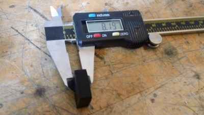

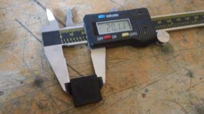

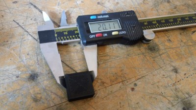

My Printer is fantastic with the only problem being that all of my prints turn out about 20% shorter than they should be. I have included photos of what should a 20x20x10 box. Sometimes I can compensate before I print, but guessing how much altering I should do has become a hassle. Perhaps this friendly community has some suggestions. Normally I could just trail and error change my settings to try and find my problem, however my attempts are futile to say at the least. I am running the newest Repetier-Host, it's bundled with the newest Slic3r, and I am using Marlin for my firmware because I have had... issues with Repetier-Firmware. Many thanks for any response and constructive critizism. Cheers!

I do believe your z-axis steps per/mm are 19.1% low. Have you verified that the call for 20mm gets you 20mm in lift?

foshon wrote:I do believe your z-axis steps per/mm are 19.1% low. Have you verified that the call for 20mm gets you 20mm in lift?
I don't have the best accuracy, but here are my numbers;
Command|Result
0.1= 0.0127
0.5= 0.3556
1= 0.762
10= 8.001
20= 15.951
Command|Result
0.1= 0.0127
0.5= 0.3556
1= 0.762
10= 8.001
20= 15.951
The math says you take the steps you expected and divide it by what you got. So if your steps/mm is 700 you would take 700x20=14000/15.951 and your new steps/mm would be 877.687.

Thanks, I think I understand but when I go into the coding and adjust the steps per mm in the z axis, the machine does not register the changes.

Mike&Mr.Stevens wrote:Thanks, I think I understand but when I go into the coding and adjust the steps per mm in the z axis, the machine does not register the changes.
What board/firmware combo are you using? I know the H-1's originally had some goofy CNC stuff I know nothing about.

I'm using rambo and Marlin.

You want to change this section here:
Code: Select all
//#define DEFAULT_AXIS_STEPS_PER_UNIT   {80,80,1600,761.328}    //mendelmax with MicroExtruder 1.4.2 and PBC Leadscrews
#define DEFAULT_AXIS_STEPS_PER_UNIT   {80,80,1511.81102362205,761.328}    //mendelmax with MicroExtruder 1.4.2 and Precision ACME Leadscrews
#define DEFAULT_MAX_FEEDRATE          {500, 500, 5, 200}    // (mm/sec)
#define DEFAULT_MAX_ACCELERATION      {2000,2000,50,500}    // X, Y, Z, E maximum start speed for accelerated moves. E default values are good for skeinforge 40+, for older versions raise them a lot.
If you are using repetier host make sure you change the value in the eeprom section as well. This post has a screenshot of the area you will need to alter.

Just tweaked the settings in repetiers eeprom configuration window. works fine now.
