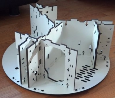

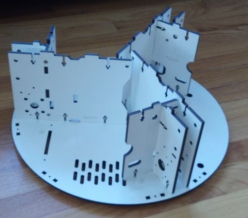

OK - end of day 1 and I've reached "base camp"... but not without a few adventures along the way...
1) The biggest slow down was the idlers and stepper motor mounting. I had a heck of a time understanding that particular PDF and I had trouble finding the parts (they were all there - it was a question of which part is the "bushing washer 3mm" - it doesn't actually look the same in person as it does on the diagram). I couldn't find any photos or video that showed a good close up of the part.
2) It would be nice if the baggies were all labeled with contents - but I think I've got everything right so far (well, at least in the fastener dept). The one exception is I haven't figure out how to attach the PSU to the retainer.
3) Some of the holes that need the t-nuts are mighty close - I had to leave one off because it's neighbor was partly covering the hole. We'll see if that causes problems later on... EDIT: Doh! You only have to put 8 t-nuts in the bottom of the table - the ones for the insulator and bed. I filled in every hole (that wasn't countersunk on the other side indicating a different fastener).
4) Getting the table top on was a b....tch. My approach was to loosely attach the seven cover brackets to the table - with everything else already attached to the base. Then place table on base and line everything up and away we go... That was the plan. However, it took a lot of trying to get everything lined up at the same time. I started using more force to try and get things in place and I put a small hairline crack in the melamine.
5) Did you notice the snag with step 4? Yup I forgot the freakin' doors. But so be it - it was enough of a PITA getting the table on that I ain't taking it off unless I absolutely have to. I'll figure something out - one of them has the RAMBo mounted on it so I'll want that in there. Maybe I'll cut off the tabs and put a screw in to act as the pivot instead.
Here's pictures from today's adventure:

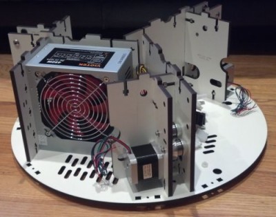

Thanks for the extra pics Steve. I've been working from the instructions at the rep-rap wiki but didn't want to post edits on that page without running them by you and John.
I didn't spend as much time on assembly today - got step 2 (top assemblies) and half of step 3 (cheapskates) completed. I found that I made a mistake with putting all the t-nuts into the bottom of the table.
Looking at the later instructions I saw that I needed 12 t-nuts for the cheapskates - and then taking a closer look at the rest of the instructions it seems like I only need 8 in the table for the bed insulator and the bed. Oh well - at least I could retrieve the t-nuts without any disassembly (apart from stabbing myself in the finger whilst removing one!
BTW, the base appears to be the biggest assembly task the rest seem to be less involved. Although I'm having a slight issue figuring out the cheapskate assembly - figuring out the location of the t-nuts and what screws into 'em. I'm sure I'll figure it out tomorrow. I hope to be printing by next Sunday...
A couple pics from today's fun (MK - with Steve's pics I don't think I need to post higher res right now?)

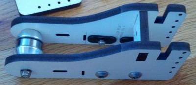

Mechanical assembly is complete (including the Bowden Extruder - thanks to the eDrawing for that one)**. Minus the doors and the heated bed.
I haven't started the wiring/electronics yet. Steve and John - are there any how-to-guides or videos for this part?
Also, my u-joints are binding still. They're not binding on the axels - they're binding in the plastic ("68304 platform 2" and "68332 u mount base"). Should I take an X-Acto knife to those parts and shave off a little plastic to make things move freely?

OK - you can ignore the following question (I just watched the video about belt routing) ...
One other question -
The original cheapskate has four bearings - the new one has an extra fifth bearing. This extra one "sticks out the back" - how do I route the timing belt? Should it ride over this bearing? If so, does it need some form of guide to keep it there? Conversely, if the belt routes to the left or right of this bearing isn't that going to cause unwanted friction?
The belt goes up the inside of the channel and passes underneath the back of the cheapskate and underneath that fifth bearing because the bearing doesn't ride on the bottom of the slot... (for some reason I had it in my head that the fifth bearing was "filling" this channel and would obstruct the belt)
