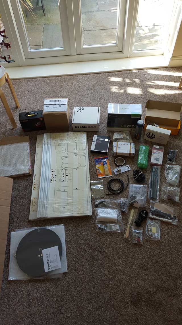

Ordered all the follwoing parts, and looking forward to many evenings of rewarding 3d printing (or pulling out my hair and swearing a lot)
RoStock Max v2 kit
E3d V6 hotend
Replacement 750w Corsair PSU
Copper RTV Silicon
Trick laser 300mm carbon fibre arms
Trick laser Nema stepper motor dampers
Trick laser J-Head groove mount for the E3d V6 hot end) - hey it was on offer, what the heck
Extended screws for the E3d V6 hotend
Silica packs for the filament storage
Kapton tape
Replacement 40mm Noctua fan
Replacement 25mm bearingless fan (just in case)
Roll of PLA
Roll of ABS
Sheet of PEI for the hotbed
RGB led ring for the print head
RGB led controller
I ordered the upgrades straight away, because I know I an upgrading the hot end anyway.... so lets do it now. Plus... impatient like that!

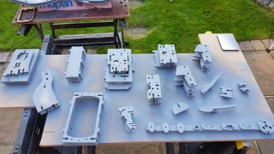

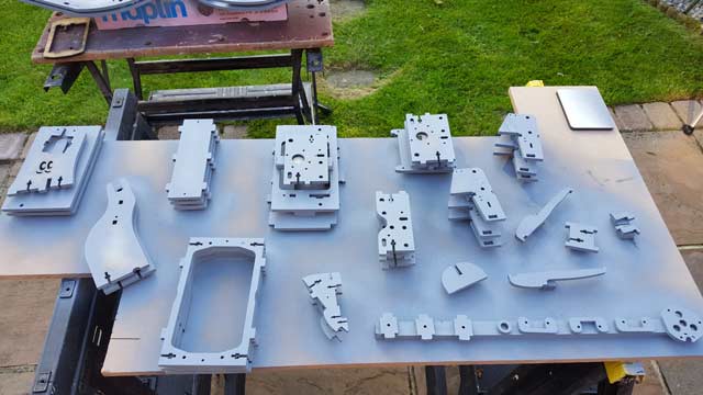

I have designed a cabinet with full enclosure and heating. I will start on that once I have the main unit assmebled and had a little play.
First job..... paint those edges on the printer panels!

Well got going today. Trial painted the edges of one piece and it looked fine.
So - etch spray primer, metallic blue and laquered all the edges.
