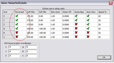

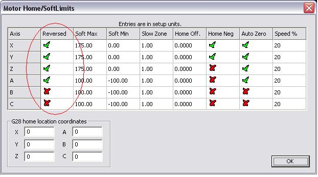

Things going well but ran into a couple issues. Via the manual, Y positive should be toward the front of the machine. Right now within mach3 my positive/negative are revised. When I jog any axis it is the opposite of that found within the manual. Is this normal? How do I revise this to match? Another issue I am running into is Zeroing each axis. This may be due to the reversed +/- axis, but what is the procedure to set the Zero for x,y,z? EDIT - Found how to reverse the motors - Config -> Homing/limits - first column. This also seems to have fixed the zeroing issue, now looks to be zeroing. Pic below.

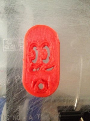

I would like to thank John and Steve for letting me know about the temp sensor from walmart. Looks my temps are correct now. I am having an issue with getting the abs to stick to the deck. Tried different things to make it stick, sanded the deck, blue tape and adjusted the temp a bit hotter to see if i would get better adhesion. At this time cannot tell if my flow isn't enough or my distance from the deck is to high. When I try and print the abs rolls up the tip and a blob develops on it. I used the A motor tuning profile supplied by mhackney. Also to make sure I am slicing the stl correctly. I'm using a Nozzle Diameter of .5 is that the standard 1.75mm nozzle supplied with the Kit?

johnoly99
Posts: 736
Location: Goshen, IN
Re: New build almost complete
Post by johnoly99 »
Hey tizle, try lowering your z height a bit and slowing down the speed for the first layer. Anytime, stop on by!

It did end up being the Z height along with an uncalibrated A Axis, my flow was way to slow. Adding a pic of my first print. Just from this one print I see why heated beds are a must.
Mtizle
johnoly99
Posts: 736
Post by johnoly99 »
Dude! For a first print, it's really not that bad! Congrats, it's alive! you can get that print down no problem without a heated bed. Spend plenty of time calibrating your Z and A axes, those are really the most important. After that, play around with printing the same part at different speeds and watch how it goes. you'll learn a lot from watching your machine do it's magic. Try 30mm/s perimeter, 40/s infill and solid, .3 layer height, .5 nozzle dia., and set the temp to about 430-440 F and that will come out better I bet!
