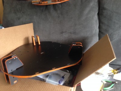

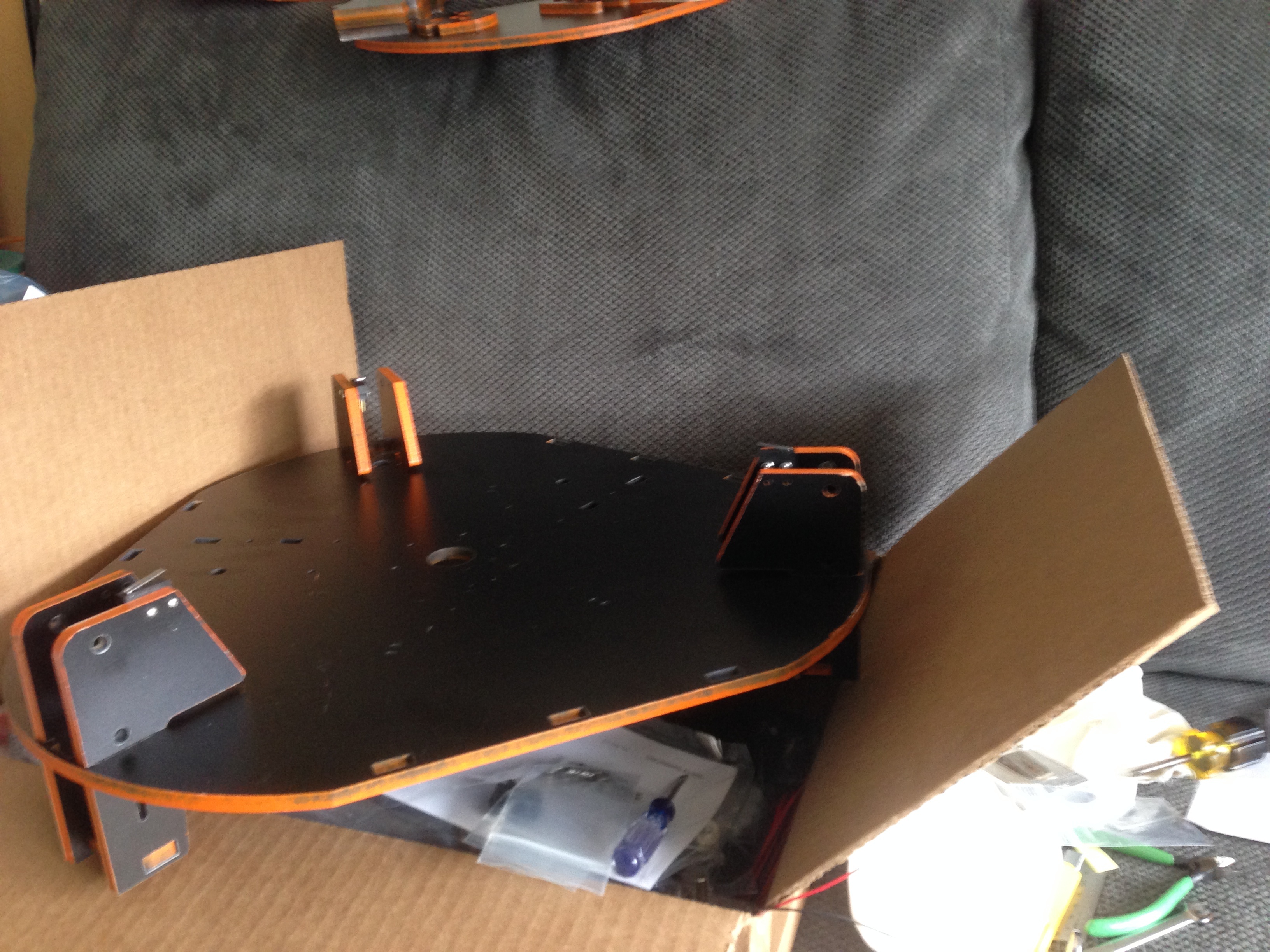

It's here......
Thanks mcslappy!
I will go and get some paint tomorrow and do the done thing, I think it's going to be yellow.
I have just ordered the vibration dampers for the steppers and a dial test gauge to help me get the bed levelled properly when the time comes.
I've just got to LOOK at all that good stuff in the box....

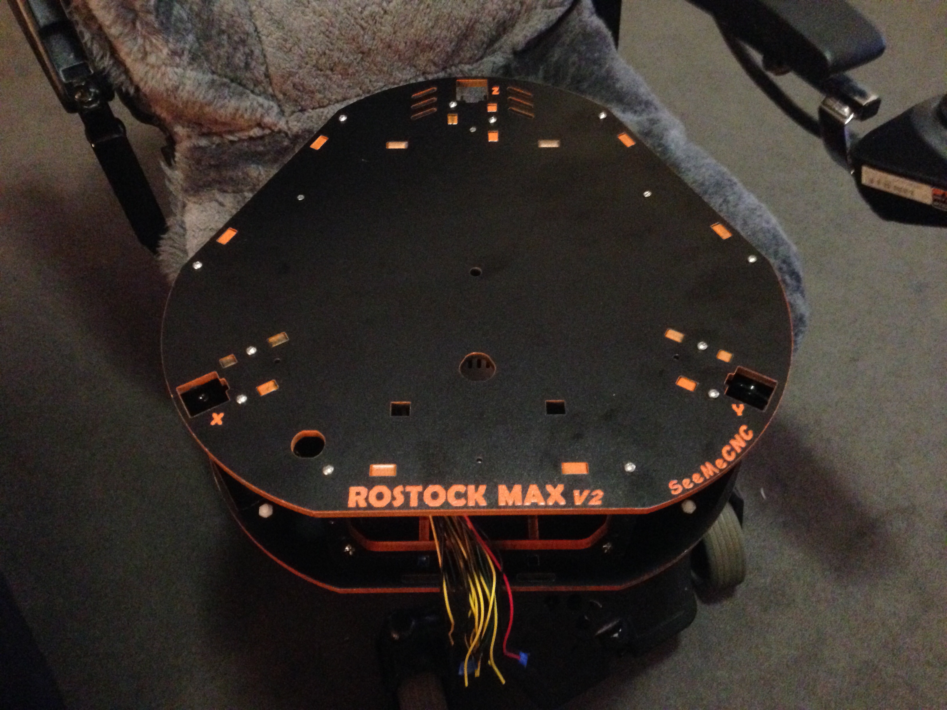

Re: crocky's Rostock Max V2 Build
Back again
Progress so far, painted most of it orange (doesn't the thing suck up paint). Installed the motor dampers, had a loss trying to find screws and then I remembered that my crimping pliers had an area for shortening screws
Got power supply in and got rid of the un-needed wires, I also got 12volts and 5volts (you never know what mods will happen).
The base is pretty well done now, the fun will be when I get to the Rambo!
Sitting on my wheelchair

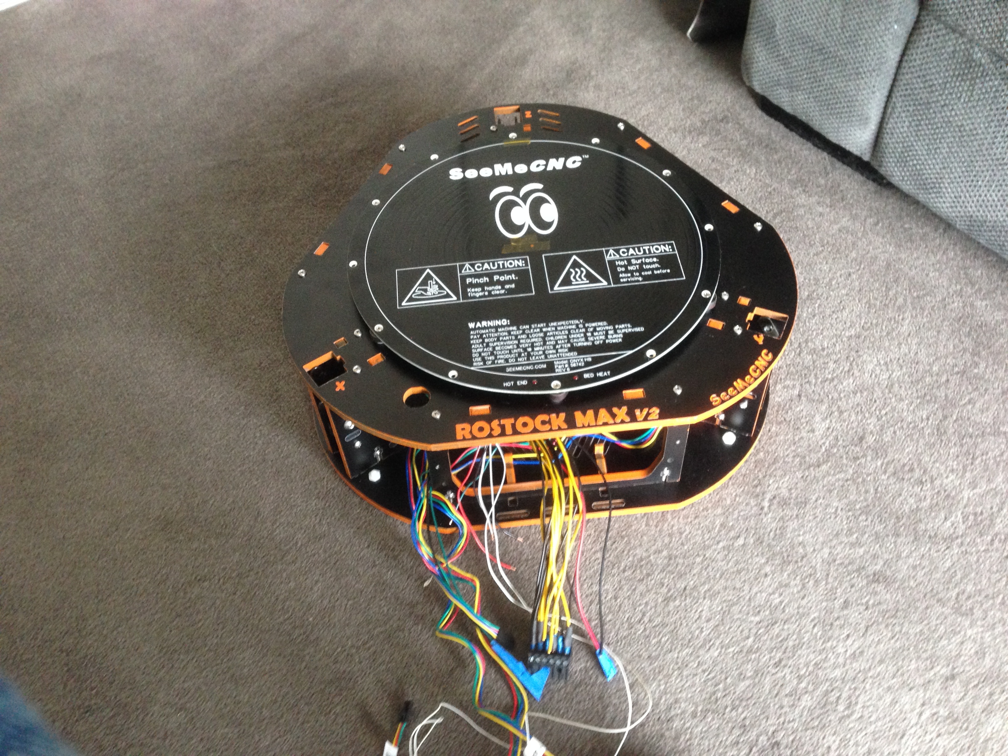

Progress Again
The hot bed is all soldered up and fitted, there is a mess of wires coming out where the rambo will fit!!!!
I like how the top of the base has the X, Y and Z printed out.
I have made a start with the top piece.
and today, I will put the wires into the tubes and hopefully get them mounted.
I have got a few bits coming from ebay, I'm going to do the McSlappy hotend heater mod.

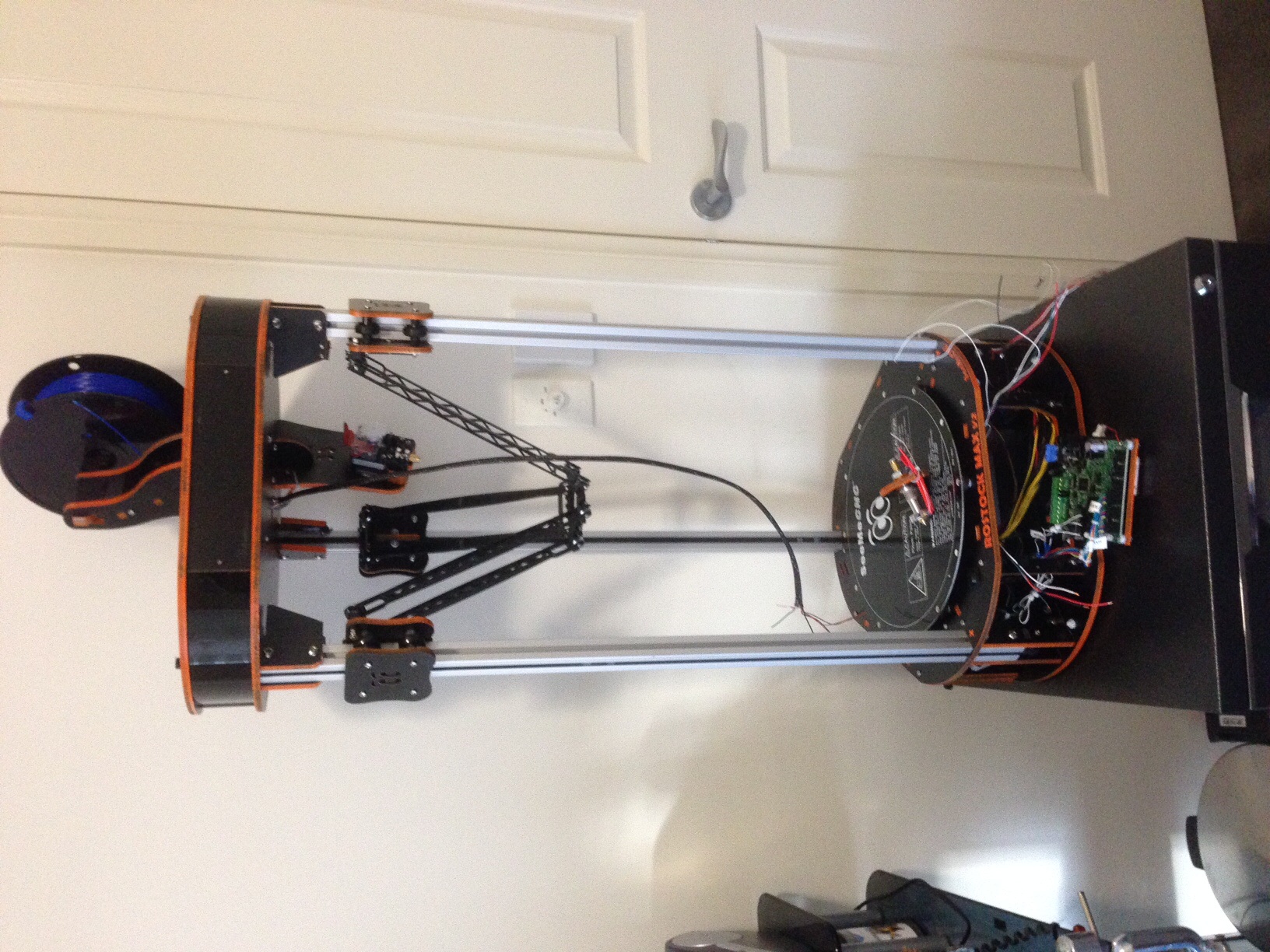

Well, got the towers on it and put it up on the filing cabinet. I had the previous 3D printer on it and it seems to kill the noise fairly well.
I am just starting the cheapskate setup now

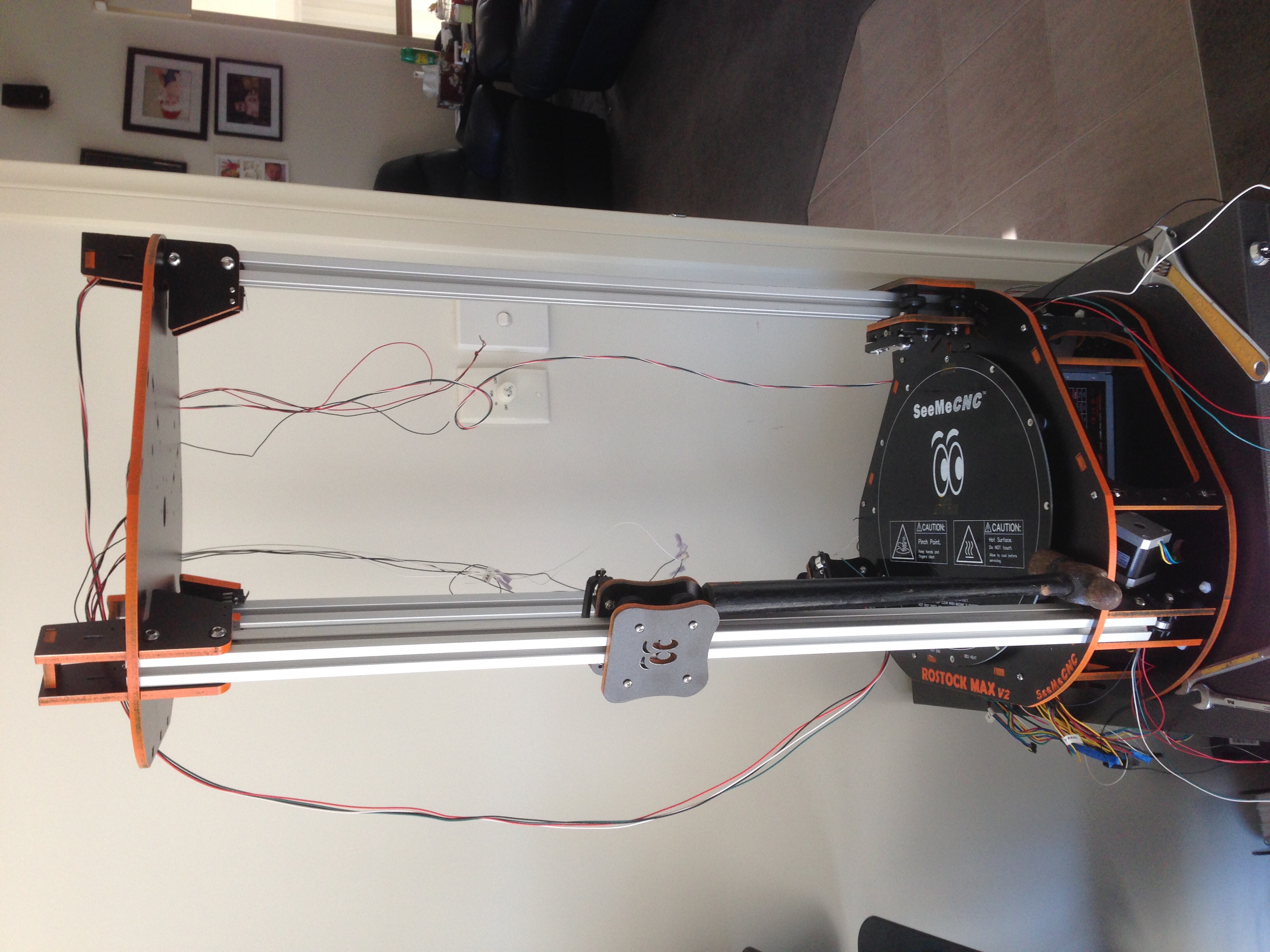

What I have done....
Cheapskates tightened, belts fitted, extruder fitted, reel holder fitted, LCD fitted (some those nuts are real small and difficult to fit, but....).
Just have to get the poles perfectly at 90 degrees and then tighten them up, gotta find the square!
I am waiting for a few things from eBay including the special crimping pliers for the Rambo board

Did the McSlappy hot end heater cartridge and the screw in thermistor mods.
After hearing of lots of power supply problems I am leaving the rear covers off until I have fitted a Noctua NF-A9x14 Premium Fan. The power supply breaths a lot better in the kits that are coming out with the new multi slot baseboards with particular attention to the power supply area.
I have PEI on the way
I am waiting for a 18 led 60mm circle to arrive and I will make an adaptor and mount it to the hot end.
That should be enough for a little while, I really just want to enjoy it now!!
