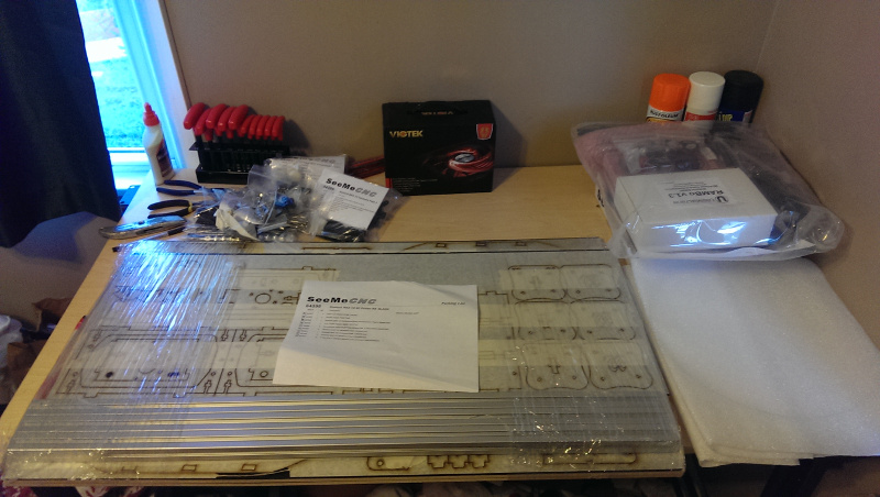

Today the box with my new 3D printer has arrived from SeeMeCNC. I've been waiting for it about 2 weeks. Unfortunately I'm flying to Seattle next week so I will only have one day to get started.
Here is a picture of the box arriving from UPS. It required my signature so I had to work from home in the afternoon to make sure it wasn't sent back. My build space was a bit crowded from my past computer build and some things I am making for my scooter. I cleaned the room up a bit and got to unpacking the box. Here is all of the items which came with my Rostock. I purchased an extra glass plate because I knew I wanted to experiment with different films on the build surface. I have a polyetherimide sheet I purchased from Amazon which I'm going to give a try. I really liked how GeraldO's build color came out with fluorescent orange. I am going to paint the ends of my "wood" parts a very bright orange. That is the next step for tomorrow.
I will continue updates with more build pictures and some of the mods I am wanting to try.

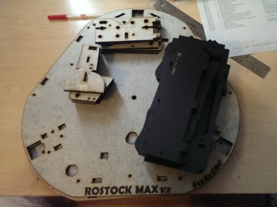

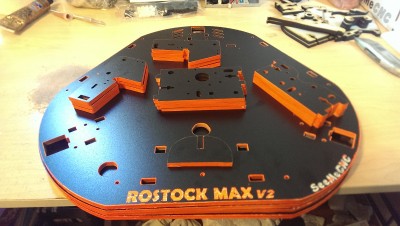

Here are the parts ready for primer and then orange paint! Anything black will be orange and anything with paper on it will be black.

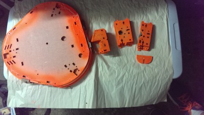

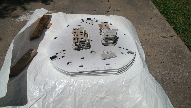

The first step of the side parts being orange. It is too hot now for any further painting in the garage. So I'll need to paint the other parts next weekend.
The primer I'm using is Kilz Latex 2 primer. I had to use two coats to cover the majority of the black wood ends. I'm using Rustoleum Neon Orange spray paint for the final coating. You will notice some of the orange paint on the top is cracking. The sides looked good when I inspected each part.

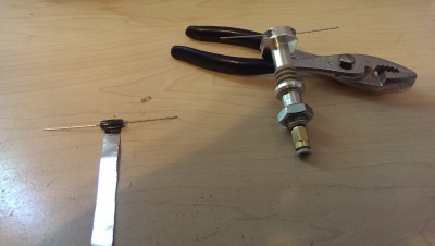

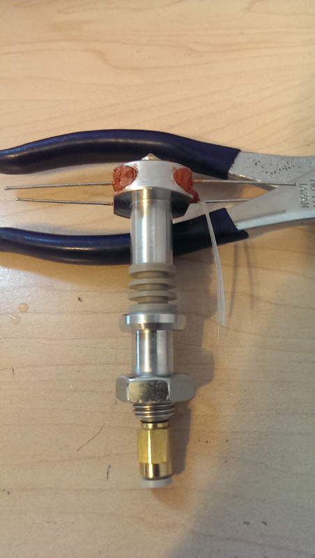

While the paint was drying, I got to work on the hotend as well. I cut a narrow strip (3/8") of aluminium the width of the resistors and wrapped the foil tight around the resistor. Then inserted the foil in to the sides and applied copper silicone. Hopefully this will provide better thermal contact to the hotend. The thermistor is installed per the manual.

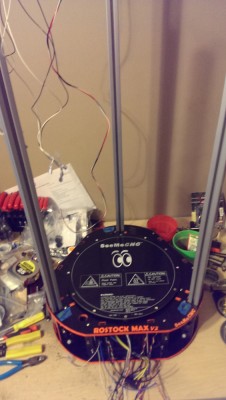

Ultimately decided not to run another set of wire through one of the tower supports. Got the tower supports installed and the wires ran through the aluminum. It went very smoothly and now I'm on to the top section assembly. I would like to say that the assembly manual is awesome and guides you through every part of the build process.

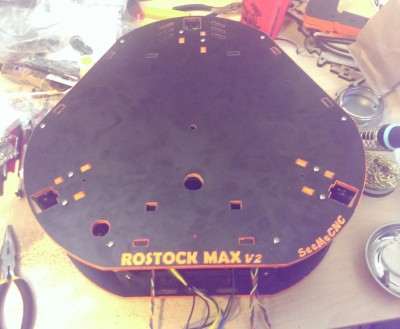

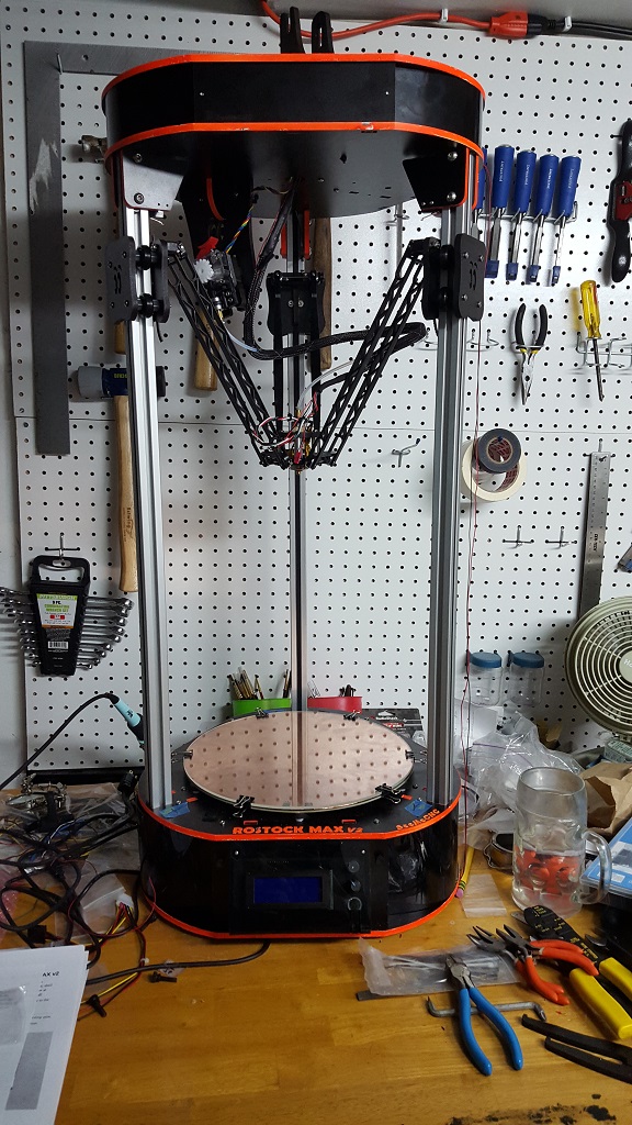

Here is what my version of the finished Rostock MAX V2 looks like. I've since moved the Rostock from the garage to my home office.
I went through the tests tonight and found a few problems. All the endstops and motors works very well. The heated bed, bed thermistor, and two LED lights work well. I have an issue with the hotend heating and hotend thermistor. I've narrowed down the problem to the quick disconnect on the extruder platform. I get continuity between the connections on the RAMBO board and to the quick disconnect connector. I also get about 88k ohms on the thermistor and 3.2k ohms on the power resistors after the disconnect latch connector which I believe are the correct resistances.
My current thinking is the male pins aren't sticking out enough on the latch connectors. The male pins are 1/4" inside the male latch connector. The female pins look like they are all the way to the end of the female connector. Here is a picture of the male connector with the pins from my phone.

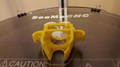

Here is a picture of the first successful print. During the print, I noticed the X tower cheapstake was moving a lot so I have to adjust it for the next attempt.
