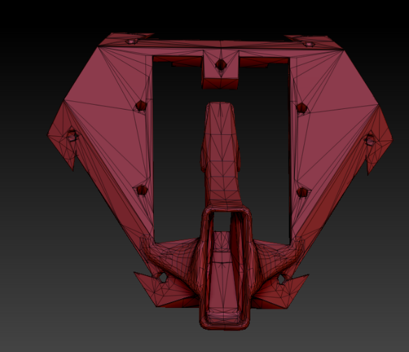

I was thinking of a direct drive system as well and what I concluded might have to happen - if I were to do this is to mount either surgical rubber hose or a spring inside the cable management hose with just enough tension to lift the weight upward to the Rostock ceiling (perhaps just to lift the cabling rather than the endeffector). I have a magnetic end effector setup, I've had it tested on 2x speed multiplier in Matter Control (using Rambo 1.3V3) and it didn't come off but I had only a single hotend and fan shroud at that time.
I'm working on having Kraken set up with 4 E3D Volcano's on the magball endeffector and I would like to quickly swap another Kraken endeffector system with small nozzles for detailed prints etc.
I've been modeling a new endeffector for the Kraken to use with magballs and 40mm fans should ideally just snap into it rather than needing to print them -less weight & material.

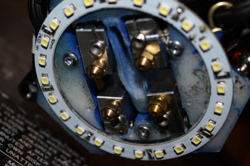

Here are a couple examples of what I'm working on to get the Kraken working in a smaller, compact effector with common features such as fan shroud and LED built in. Bungie cables have been added, these ones in particular can be latched on easily and adjusted on the fly. Please excuse the poor image quality, just took them quickly. I still have to rework the files as I explained earlier. This effector allows the original/stock z height. I haven't yet tested this effector, I am hoping I could get additional setup info.
Can anyone share what the offset values are for the Kraken? thanks.
Re: Kraken thread
Interresting design.Ascensi wrote:Here are a couple examples of what I'm working on to get the Kraken working in a smaller, compact effector with common features such as fan shroud and LED built in. Bungie cables have been added, these ones in particular can be latched on easily and adjusted on the fly. Please excuse the poor image quality, just took them quickly. I still have to rework the files as I explained earlier. This effector allows the original/stock z height. I haven't yet tested this effector, I am hoping I could get additional setup info.
It would not fit on my kraken, because it seems that my heat blocks are much bigger than yours.
Did you do anything to them, or did E3D change their heat blocks for the kraken ?
But how do you make sure your heat blocks dont melt your effector ? What material do you make your effector in ?
What offset values do you need ?

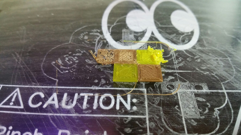

Is anyone here actively using a Kraken, or has everyone abandoned it to the Cyclops and other hot ends?
Any 3- or 4-color prints that don't look like a bunch of trash (which is literally all I could find online)?
Re: Kraken thread
I'll consolidate the reply from the other thread here too...
I think the situation is that no one extruder is going to be good at everything and that there will be specialization. We are starting to see the early days of that now. For instance, I think a really good switching extruder similar to the Cyclops for PLA or ABS color work is probably not going to be able to do its color job well while also being able to handle high temp materials (Nylon, etc) or greatly dissimilar support materials. Similarly, a really good all metal extruder for doing work with exotics like CF PLA, woodfiber, Nylon, polycarbonate, etc probably is not going to handle PLA very well. These materials have different physical properties of both the solid and melt. A simple example, a short nozzle bore really helps when printing PLA but a longer bore is much better for materials like Nylon and polycarbonate which tend to drool with a short bore. Also, as you pointed out, the melt path needs to be "hardened" for materials like CF PLA but simple PTFE tubing is fantastic for ABS or PLA only work. The choice is going to be very personal - what do you need to be able to do and what tradeoffs are you willing to make?
I've had the best dual color printing experience with the Cyclops over all others by a big margin. Drooling and stringing have not been an issue. I worked hard to test and adjust to get the lowest extrusion temps - which translates to less drool and stringing - and that revealed a weakness in the extruders I use. That resulted in investigating a more forceful extrude. That led to the BondTech QR. The combination of the QR and Cyclops gives me really excellent results. I think you've seen some of the 2 color prints I've done.
I no longer use the Kraken for multi color work. I think if I went back now, with what I know about "calibration" and getting a well calibrated machine, some of the dragging issues would be alleviated. I might try this over the next few weeks.

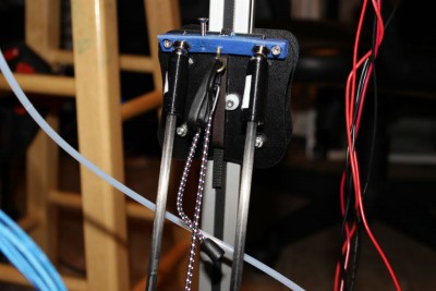

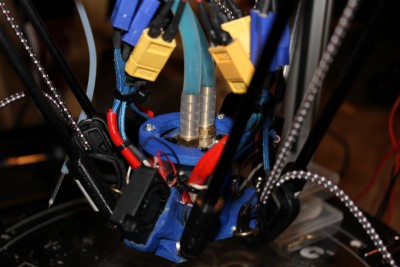

Re: Kraken thread
I have become convinced that to get the effector REALLY tram with the bed, with arms that last for years without losing any tolerance (rather than weeks to months), you have to use either magnetic or tension ball joints (steel balls held in place with Spectra line/spring). I have some steel balls ordered from Haydn (deltabot forum) and will see about getting them adapted to the Trick Laser platform and carriages. If that doesn't work out, I think the answer is to CNC machine an acetal effector with the standard SeeMeCNC hole pattern. If acetal is good enough for the wheels, I think it will be good enough for the joints as well.
I'm also working on a counterweight solution for flying extruder platforms based on Spectra line, V wheels, and 500-gram weights. I'm concerned that any differential weight put on the platform (from extruder bowdens/electrical cables/water tubing pressing at different angles) will change the tension on the GT2 belts. My idea is to suspend the platform from the carriages, and then counterweight the carriages so that they're mostly "weightless." The platforms will eventually have a strain relief for the huge bundle of wires going down to the hot end, so it won't press as hard either. Eventually, I'd like to look into replacing the GT2 belt with either highly-tensioned Spectra line, or some type of chain that obviously won't flex at all. I don't know how feasible chain is, but I've seen others mention the idea.

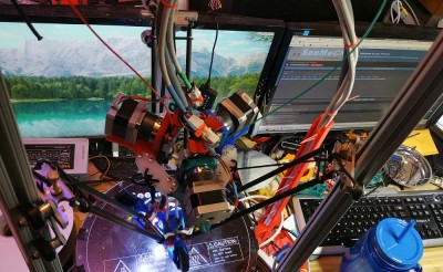

Re: Kraken thread
I currently have three steppers weighing about 500 grams each (NEMA 17, geared 5.18:1, short can) on a printed platform above the extruder. They are tied to the carriages with paracord, and they definitely keep the belts tensioned! The tricky part is getting the height of the stepper platform just right so that it doesn't push/pull the effector down/up via the Bowden tubes.
The geared motors are nice. You can run them at much lower current than a standard NEMA 17. I have mine at 1 amp, and I think they could run with a little bit less. (At the standard 1.5, they were quite hot to the touch.) I would say the smaller steppers would need to be significantly lighter to incur much additional benefit. 200g sounds about right.
The trouble with supporting extruders, whether from the carriages or the effector, is that you can never just turn the machine off. If it's homed and you turn it off, it will plow the hot end nozzle right into the glass at top speed. It's fast enough to illuminate LEDs on the controller! I'm working on a counterweight system. Spectra line is tied to the carriages on one end, and 500g weights on the other. The lines are routed with V-groove pulleys from Amazon. Initial tests (without the pulleys) were good. The effector wouldn't fall regardless of what XY position I put it into. Werner Berry uses a similar system on his printers, but he takes the weight off the effector instead of the carriages.
Key reels do sound like an interesting idea, and it would be nice not to have a bunch of weights hanging off the side of the printer. Would need to find some with about 500g of retraction force. They could be mounted right to the tower tops, no V-groove bearings required.
The swashplate idea is interesting. I assume you mean something like the thing on a microscope that swivels and lets you select which lens magnification to use. It would require mounting a servo or tiny stepper on the hot end. In theory, it's doable if the actuator is repeatable enough. I don't know how repeatable hobby servos are.
