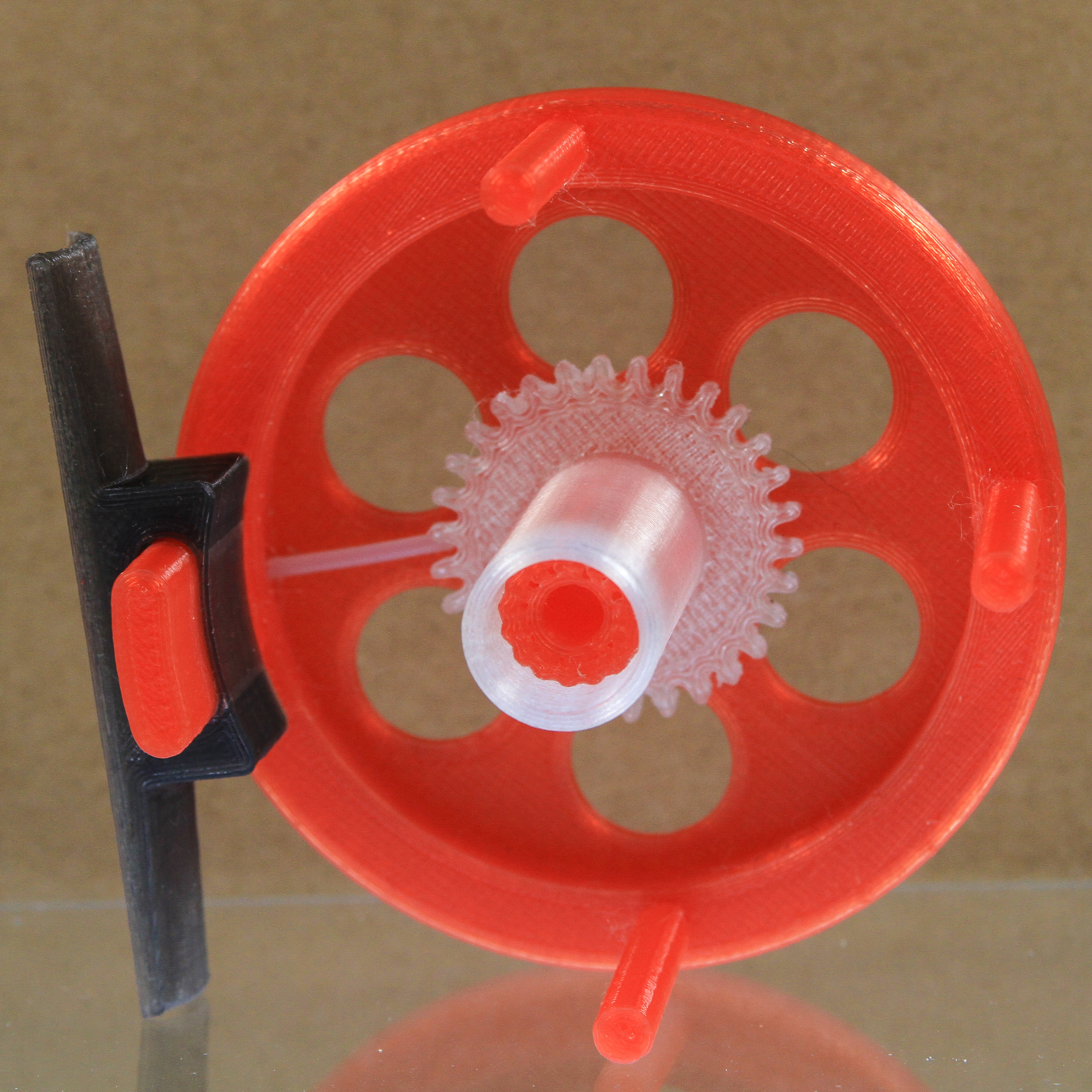

It's more about getting the air at the correct location rather than blasting a lot of air on it. If you blast air on the pylons above with such a thin first layer I guarantee you will peal the print. A thin well directed beam of air right around the nozzle will be much better. You can even hand hold a squirrel cage fan with a soda straw rigged up to it and direct it when you get to these critical areas. That's a quick and dirty approach. Even a slow even breath through a straw (or a balloon) will do it.
(click image to see the high resolution version)
The 3 pillars on the red part are 5mm in diameter. They are perfectly smooth and dimensioned. If I used ineffective cooling, they would look like your pylon test.
