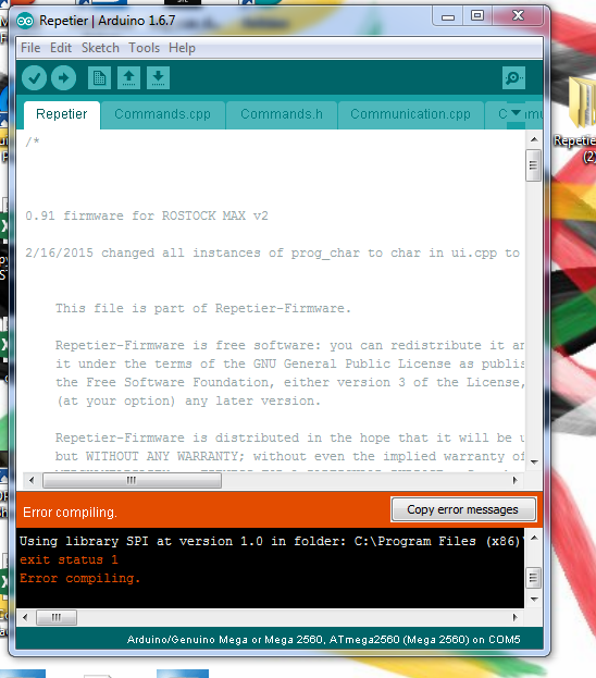

i am trying to upload the repetier firmware and it keeps giving me the same error im new to coding so i was looking for Little help or guidance if it is the a hardware issue or if it is a firmware issue i have a rostock max v2 here is the error message that i keep getting if any one wants i can copy whe whole thing in here if it might make it easier to solve
C:\Users\jgardner\AppData\Local\Temp\build42879d3f4a51ad5a156a0c9e9b8b6401.tmp\sketch\libraries\twi.c:1:17: fatal error: twi.c: No such file or directory
#include <twi.c>
compilation terminated.
Using library SPI at version 1.0 in folder: C:\Program Files (x86)\Arduino\hardware\arduino\avr\libraries\SPI
exit status 1
Error compiling.
thank you
#include <twi.c>
exit status 1
Error compiling.
thank you

I'm guessing that the version of Repetier firmware that you are trying to load was written for a different version of the Arduino IDE. The library inclusion is failing because the compiler can't find it. It should be possible to alter the Repetier sketch, but far simpler to just download the matching version of Arduino IDE.

What version of the Arduino IDE are you running? That is NOT specified on the SeeMeCNC page. The Repetier release on the page is a few years old. It is very possible that you are using the most recent Arduino IDE and it is not compatible. Look at the About dialog in the IDE to get the version #.

When you start up the Arduino editor, what is the version number on the top bar? If it's not at least 1.6, you should go get a more current version.

jerome, no that is not it. Arduino is the programming environment that compiles the firmware and uploads it to the machine. You get it here: https://www.arduino.cc" onclick="window.open(this.href);return false;
You have installed it haven't you?

Ok, did you configure Arduino for the correct board under Tools-> Boards menu?

yea its arduino/genuino mega or mega2560 and it is on com5 the eeprom seem to work fine when it had me run that

im not sure if this helps but heres the complete error
Arduino: 1.6.7 (Windows 7), Board: "Arduino/Genuino Mega or Mega 2560, ATmega2560 (Mega 2560)"

C:\Users\jgardner\AppData\Local\Temp\build03da911c33663a65c85edf1a0eeee7f3.tmp\sketch\libraries\twi.c:1:17: fatal error: twi.c: No such file or directory
#include <twi.c>
exit status 1
Error compiling.

gotcha yea no luck on compiling
