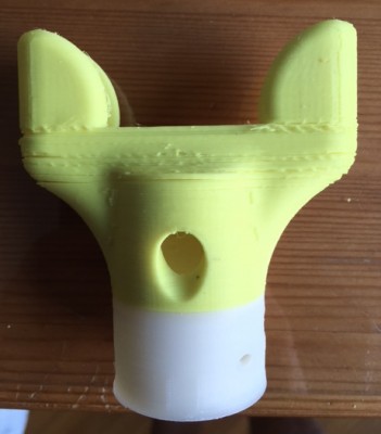

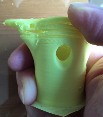

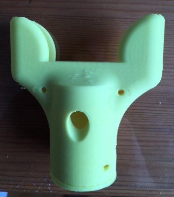

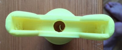

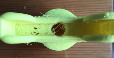

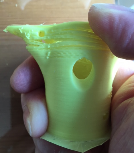

Here are some pictures:
The completely yellow part is the one that i printed with the olive oil. On the very bottom of the part there is an indentation, like a ring about 2-3mm above the base. THat I believe is where the olive oil kicked in.
(Do not mind the transition from white to yellow, i ran out of filament so i swithced to yellow mid print utilizing the white spool untill the last 11cm or so.)
On the bad print you can see where the problems start to occur, untill the solid layer the part is very strong (the pipe part).
On the top view you can also see that the top solid layers inside the part have holes in them and are not at all good. On the part with the olive oil, they are solid. I still do have a bit of stringing, but these appear to be more solid strings like the extruder did not stop extruding, not like the classical spider web type of stringing which was abundant before the olive oil. On another failed part, the upper layers are crunchy and not well stuck together ( ABS @240 degs, and during the print it did not have a drop or similar problem).
