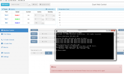

Several (probably related) problems with my Duet Ethernet board.
1) Loss of connectivity, or frequent resets followed by not connecting again.
2) USB driver dropping out and failing to connect again.
3) Duet Web Control dropping out and not reconnecting until USB cable is removed.
4) Immediate DWC disconnect when a file is uploaded to the printer.
When it rarely connects, and stays connected, the printer never starts the print.
Firmware 1.20 and 1.21 both exhibit this problem.
Thoughts? Suggestions?

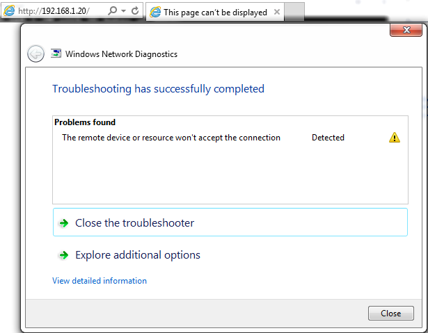

However, I'm back to my board not connecting to Ethernet. I've reformatted the card, and then repartitioned it to a smaller partition size, and formatted it using 32k sector size. I also booted into linux and tried to run it from there. It would ping at first, but shortly after that it stopped pinging. I reformatted it to 64k sector size, changed antivirus programs, and tried Chrome, Firefox, and Explorer. No luck.
It's printing out using the touchscreen at the moment. Not what I was hoping for...
Re: Duet Ethernet connectivity problems
We get very few issues with connectivity on the Duet Ethernet. Have you tried a different Ethernet cable, and a different port on your router or switch? Are you certain that the IP address you assigned to the Duet isn't also being used by another device? If you've already checked those things then perhaps the Ethernet adapter on your board is faulty.

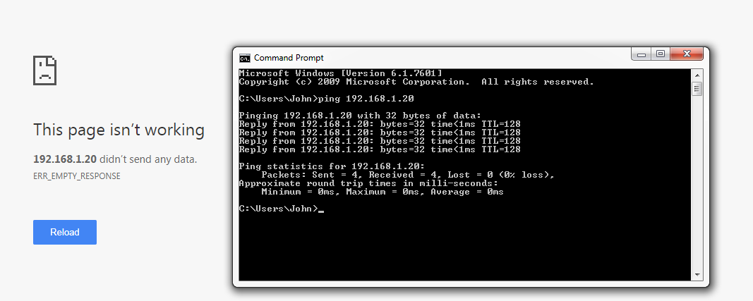

I leave it on with just USB power while I'm away to see if it fails, and it died again while I was at work.
It's had two different Ethernet cables, and either your adapter or my NIC has automatic crossover because I don't have to use a crossover cable (which is nice).
It has its own dedicated NIC card, and it's set to a different network than the rest of the house. And I've used ipscan to look at the network after a failure (no duplicates).
It's pretty simple to detect a bad or disconnected SD card, go to the console screen and look to see if the system sees your network. If it's unplugged, you will just see a running time stamp and the word "Connected". Nothing else. (BTW, I can't tell you how many times I've popped the SD card out while trying to disconnect the Ethernet cable. This is why I know this). When it's plugged in and working, you will see your network. Non-Gcode (or I suppose a corrupted file) will knock out the network as well.
Curiously, the board says "Duet WiFi" on the bottom, but I'm assuming the only difference between the two boards is the network adapter.
I've tried it with and without the USB cable plugged in and unplugged. It doesn't seem to make a difference.

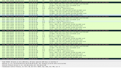

I'm installing Wireshark, we'll see what it comes up with...
