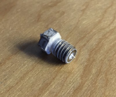

After recalibrating for the filament diameter and running a test print, noted that there was melted filament oozing out of the heater block above the nozzle. Shut everything down, disassembled the hot end again, and replaced the no-stick stainless nozzle with a stock 0.4mm brass nozzle.
All is well! Printer now on third day of creating R2-D2 parts.

I don't think I've ever seen an E3D v6 leak before. Is there something wrong with the back face of the nozzle?

Doesn't seem to be anything unusual, but I've never looked for this sort of thing before. You can see the melted PLA all over the threads.
Posts: 5183
Re: EZstruder "backslip" problem?
It may not just not been tightened properly - the E3D v6 requires that you tighten the nozzle at temperature. I don't recall what the temp setting is - it should be listed in the assembly docs for the v6.

I did tighten the nozzle at temp... I think it was around 210 or so. Held the heater block with a wrench while tightening. And that's why I was surprised to see leakage. I actually had no trouble removing the heat break after all had cooled down.
Posts: 5183
That might have been your problem - the tightening temp is listed as 285C. See the last bullet in the "PID Tuning" section here: https://wiki.e3d-online.com/E3D-v6_Assembly
