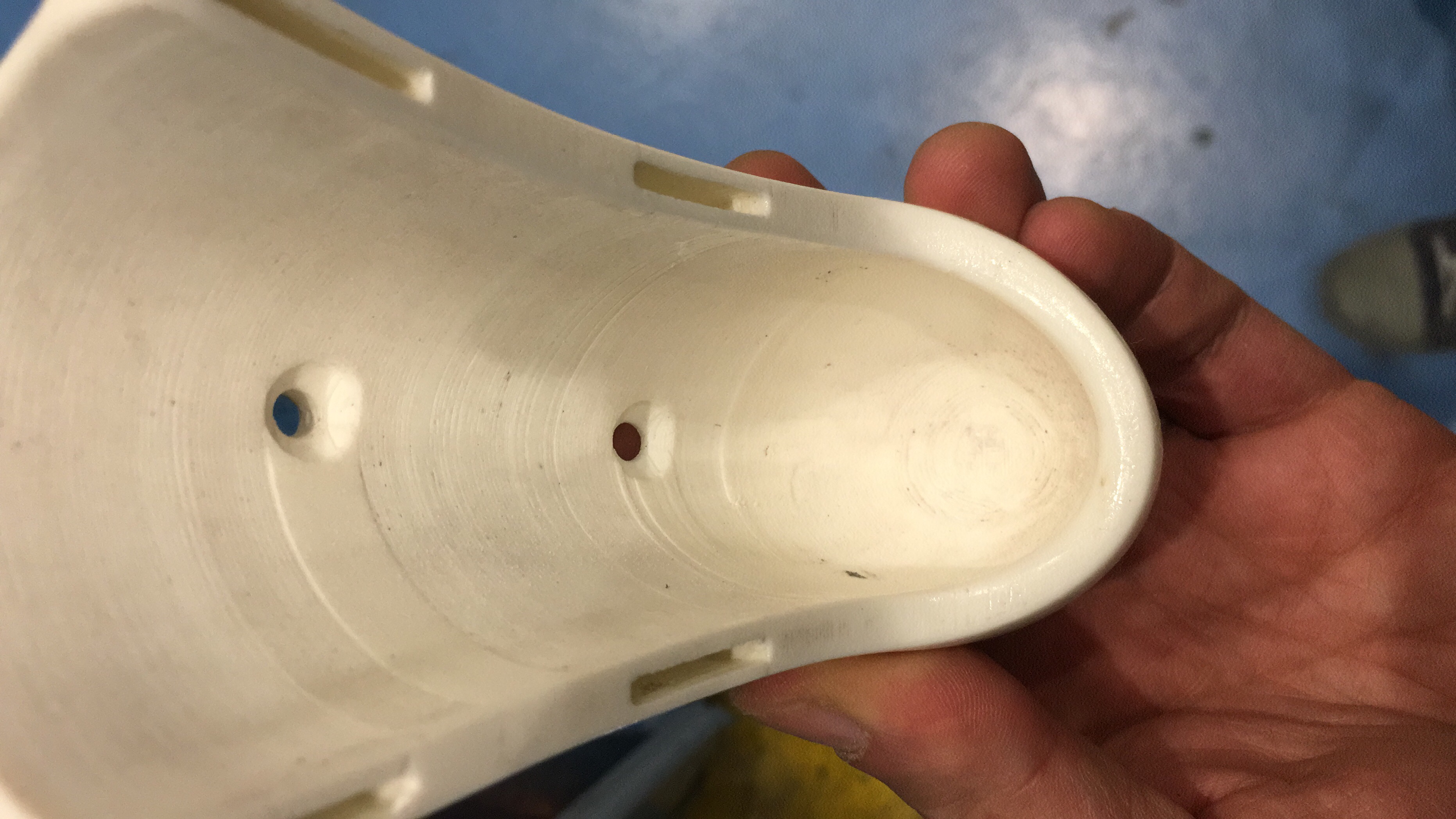

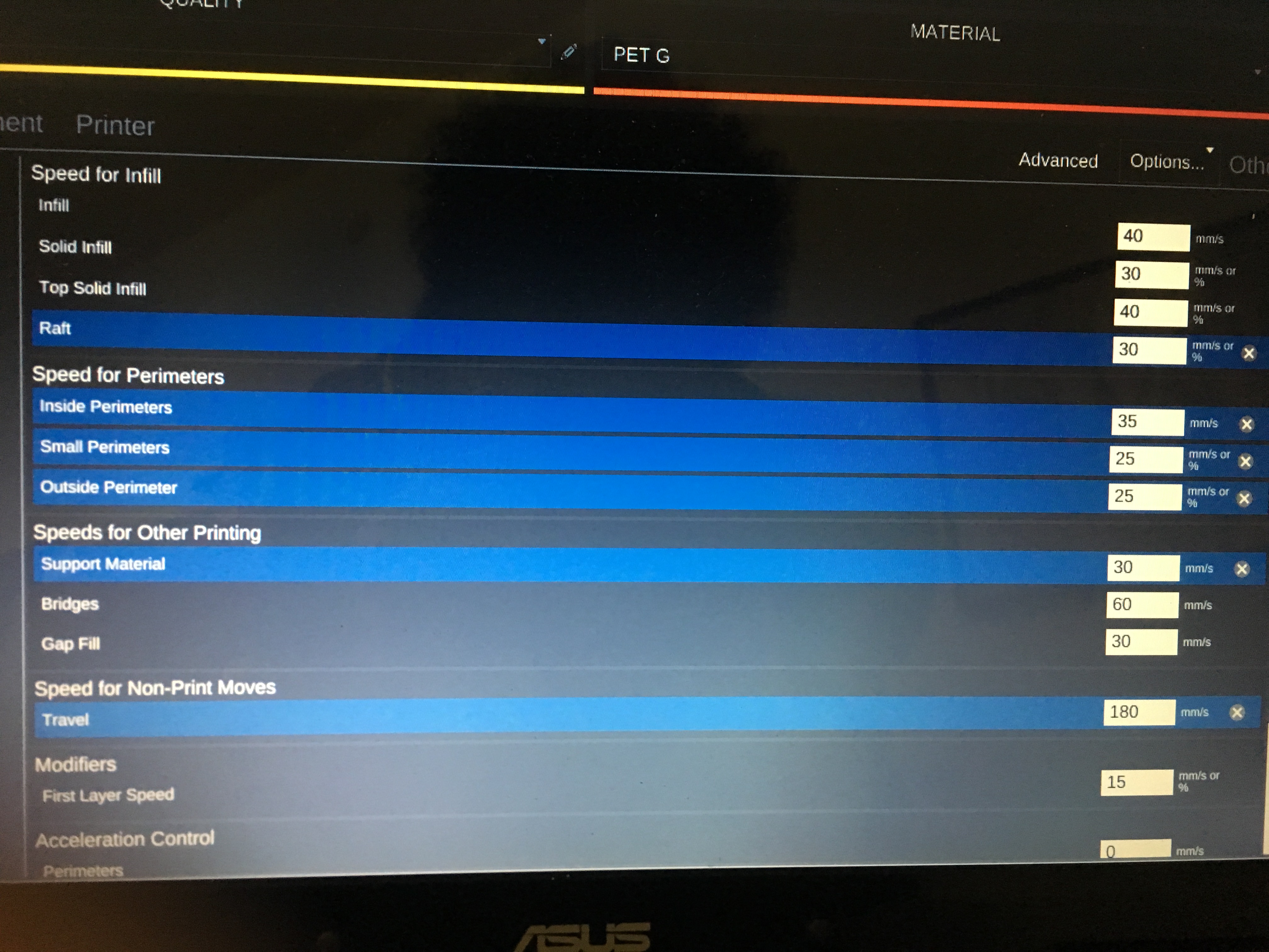

I don't why my 3D printer (Rostock max v3) does this error. I think that is an error of position.
Can you give me an advice?
Thanks in advance

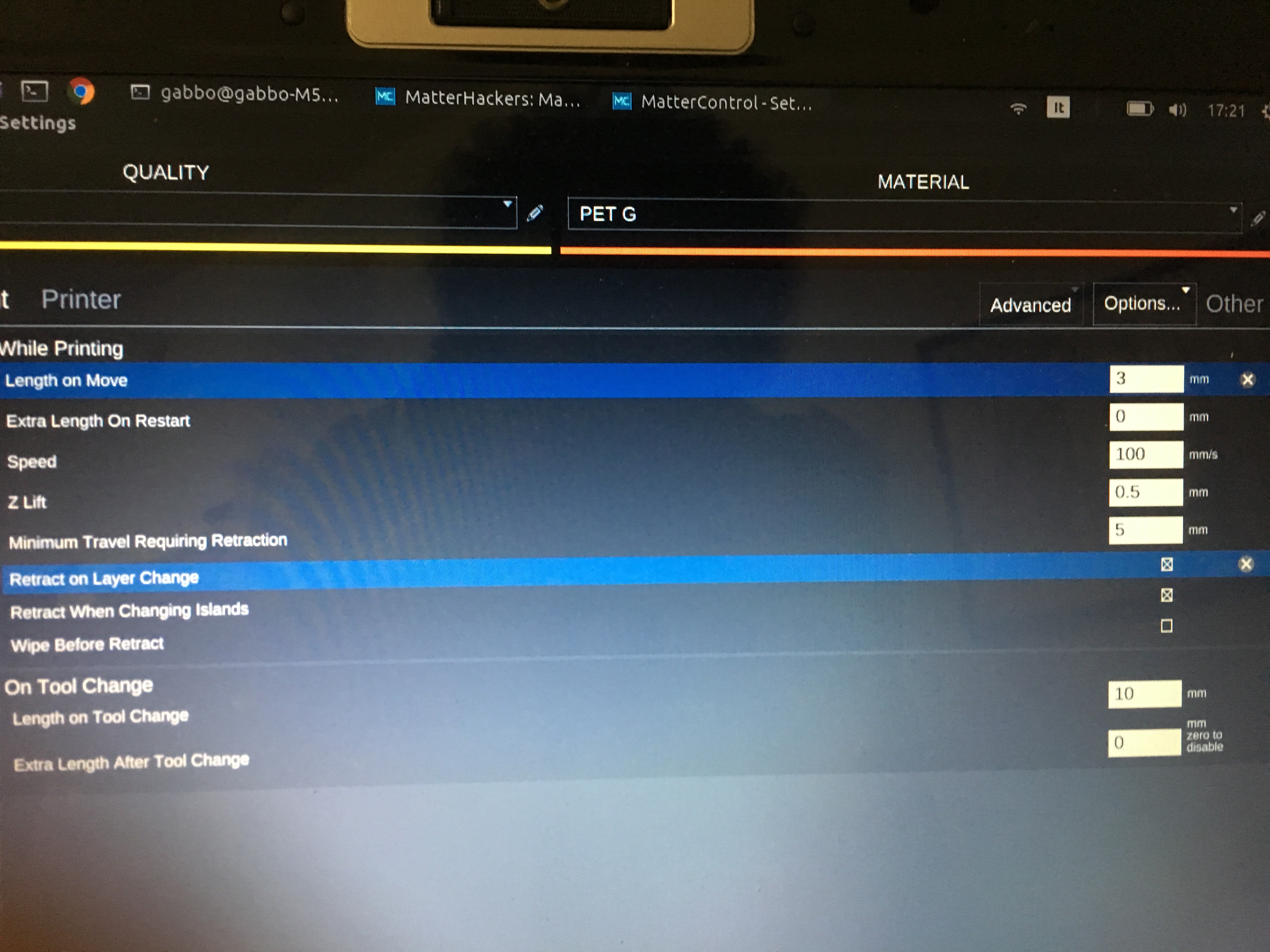

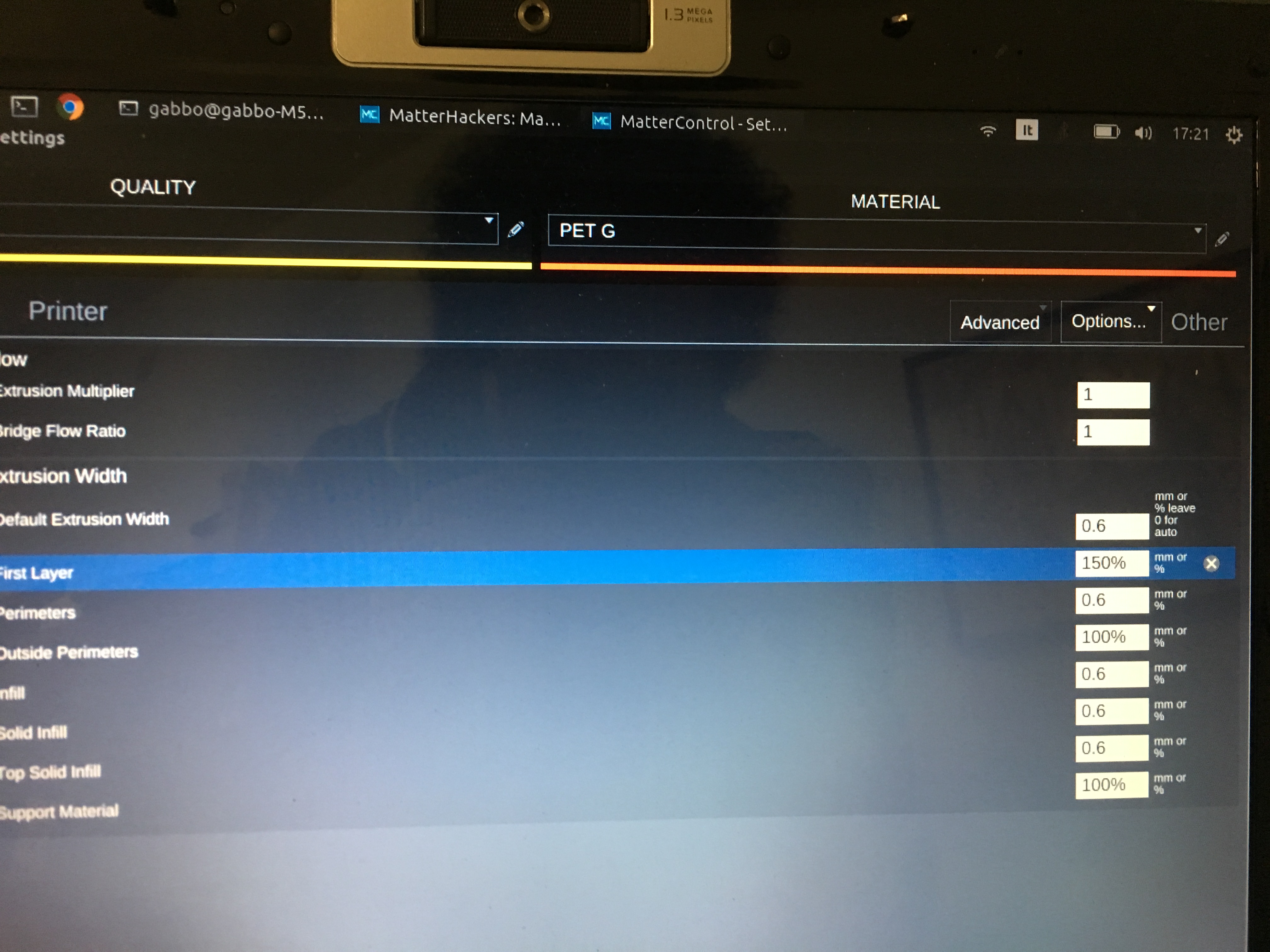

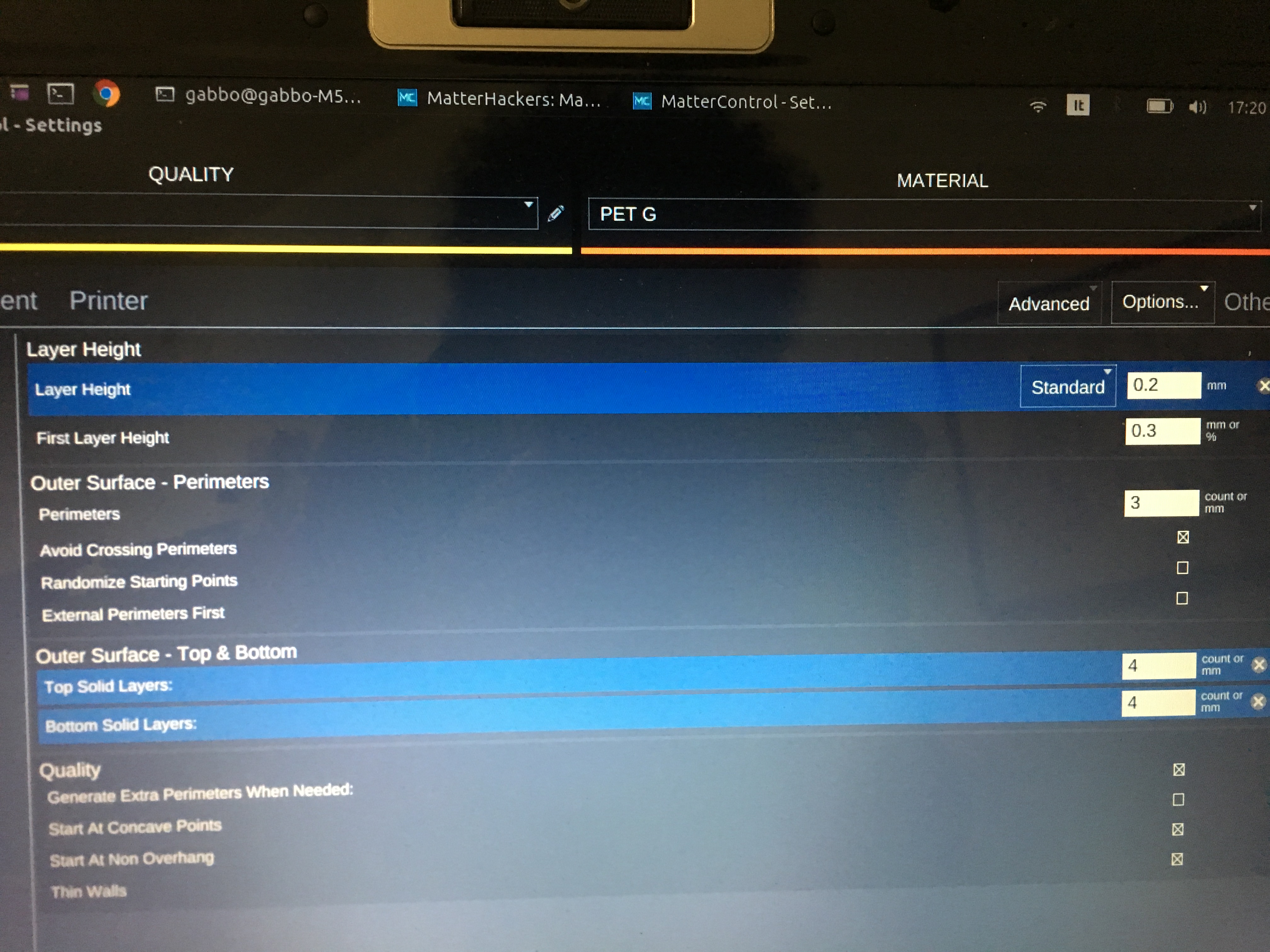

What slicer and print settings are you using?
Re: Advice to have a good Print
Hi, I use Matter control with slic3r...and I use this setting...pouncingiguana wrote:What slicer and print settings are you using?
Do you need something else?
Thanks in advance

I see several issues with your settings, and MatterControl is pretty far behind when it comes to producing good prints. You might want to take a look at Cura. You can find a setup guide here (https://seemecnc.dozuki.com/Guide/Setti ... a+2.6.2/60) complete with instructions for downloading profiles that are tailor made for SeeMeCNC printers.

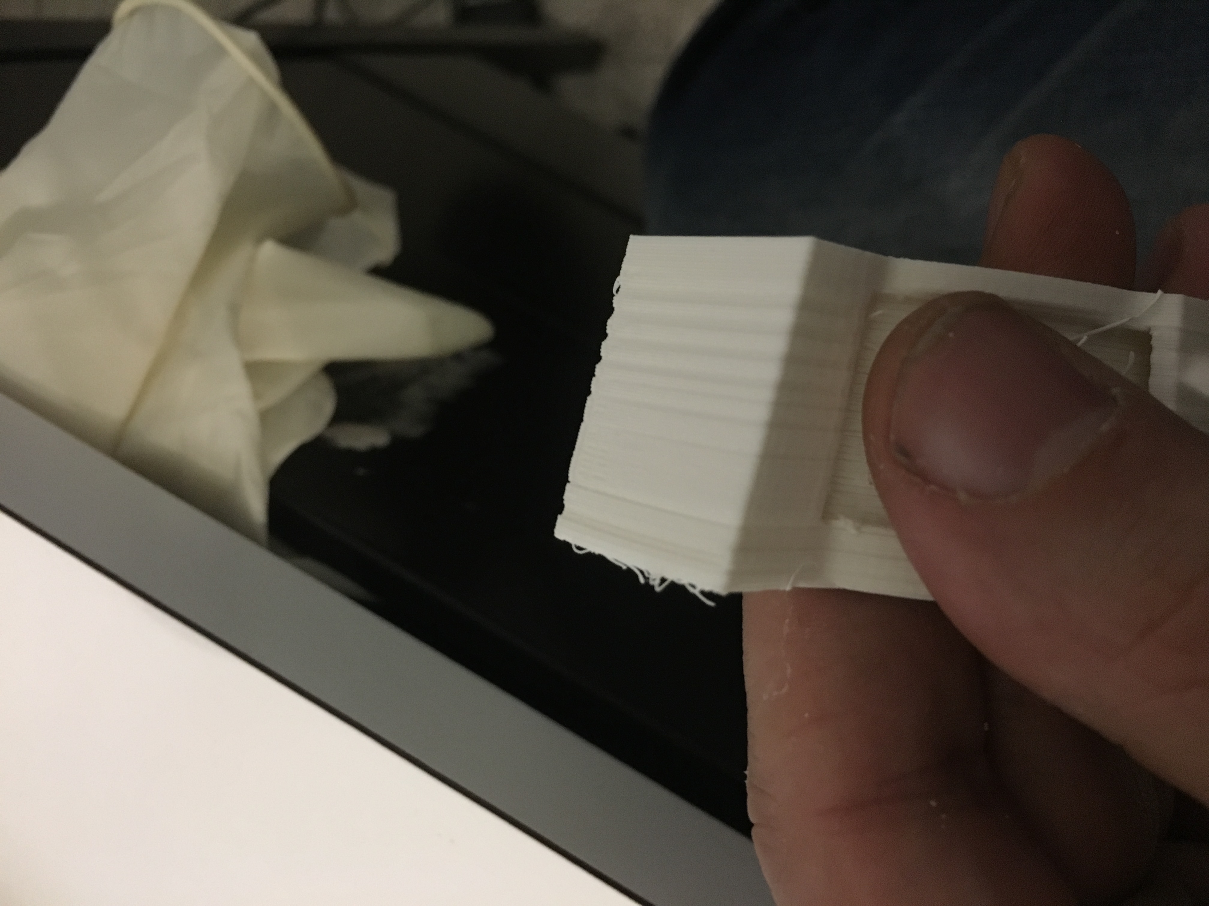

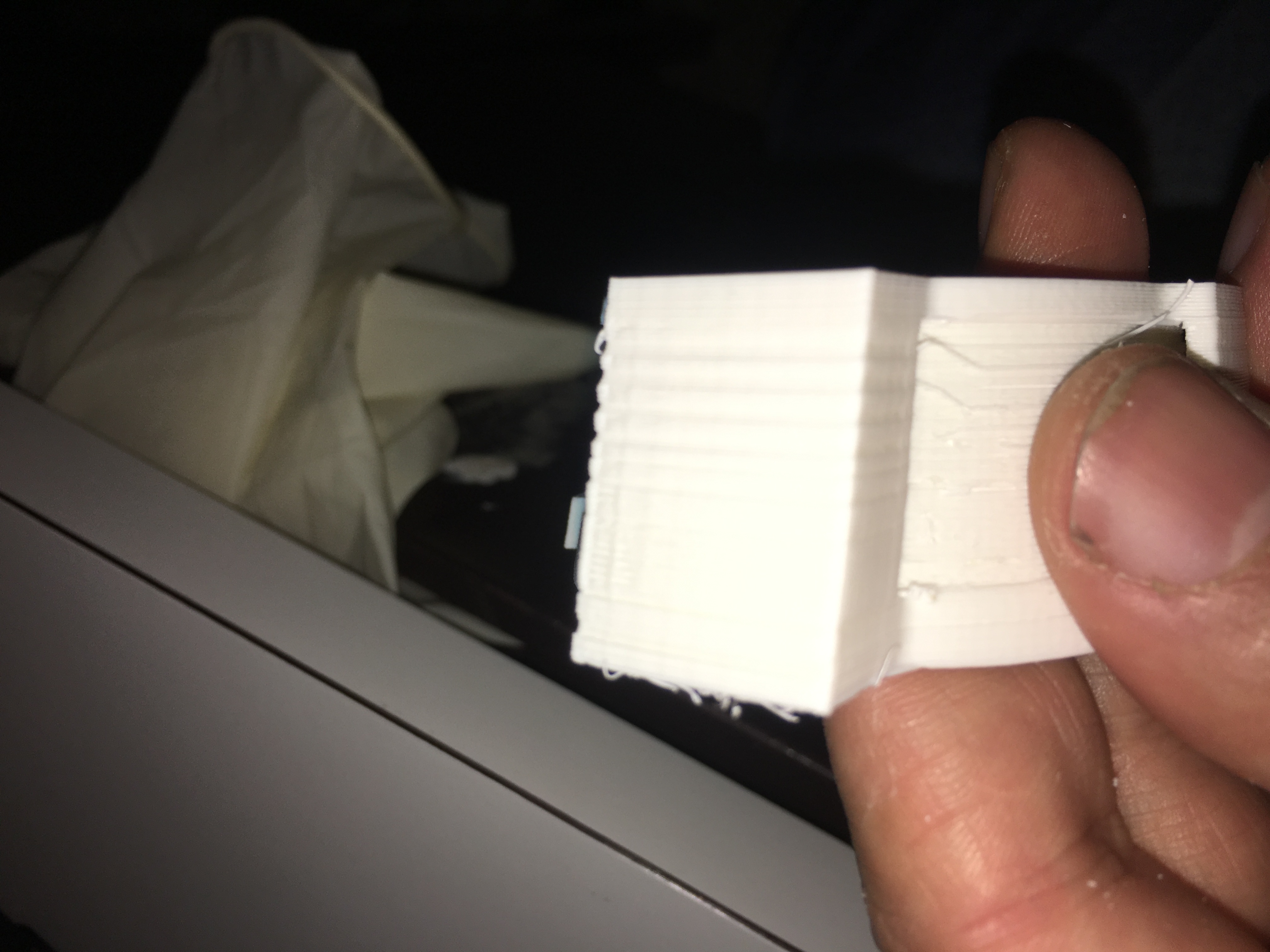

Fire up Matter Control and connect to your printer. No need to heat it up. Lower the Z axis until it is around 100mm from the plate, and grab the hotend and wiggle it. Is it loose? Does it make a funny noise as it lowers to start the print? If so, it could be binding up (mine was). Are your belts tight?
Yes. I fixed the hardware and I also have a steel nozzle now, but doesn't change the result.rootboy wrote:Fire up Matter Control and connect to your printer. No need to heat it up. Lower the Z axis until it is around 100mm from the plate, and grab the hotend and wiggle it. Is it loose? Does it make a funny noise as it lowers to start the print? If so, it could be binding up (mine was). Are your belts tight?

It looks like you're over-extruding on some layers. The way it over-extrudes on certain layers tells me it's likely a software issue; if it's not a setting, then mattercontrol itself. If you're desperate to stay with mattercontrol, I'd recommend checking "print outer layers first" (on the last screen you posted), see if that helps. It could be another setting, but I can't imagine what it could be now.
I do recommend trying other slicers, it'll help you better understand slicer settings. Personally, I like Simplify3d, especially since the update, but it is expensive, especially compared to those free slicers.
