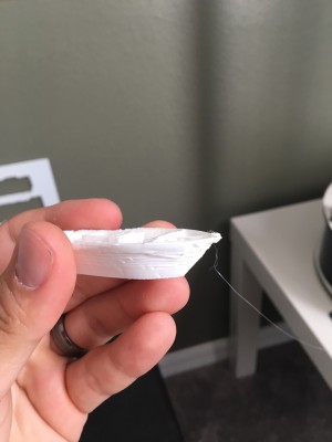

I had my printer happily printing PLA so I thought I'd let my makerspace use if for a class yesterday. I carefully strapped it down to my back seat on its side with the carriage inverted and skates held in place with rubber bands.
It printed perfectly for the class with PLA and I brought it home and decided to try my first spool of ABS. I homed the printer and did a full calibration to be safe.
Now for the issues
Setup
Hot end temp: 235
Bed: 90
Purple glue stick on glass for adhesion.
File: benchy
First layer goes on super transparent so I read up on z offset and connect via mattercontroller and adjusted the nozzle until a piece of paper would just barely get snagged by the nozzle end. That was a 0.08mm offset.
Start benchy 2, still transparent and the first layer looks like crap going down and not even.
bridging, what bridging. It just squirts melted plastic out. And as it prints the perimeter it looks like nozzle is pressing down because the still hot plastic is bending.
As soon as it's done I'm going to have to figure out where to begin. I'm thinking I need to look at the extrusion multiplier. I didn't change it in S3D for ABS and it's at 1.06
Suggestions?

I did change the extrusion multiplier to 1 and saw an immediate improvement in layer extrusion but I now think my HE temp may be too high for this filament since it's at 235 which is 5 degrees less than suggested max for this filament.

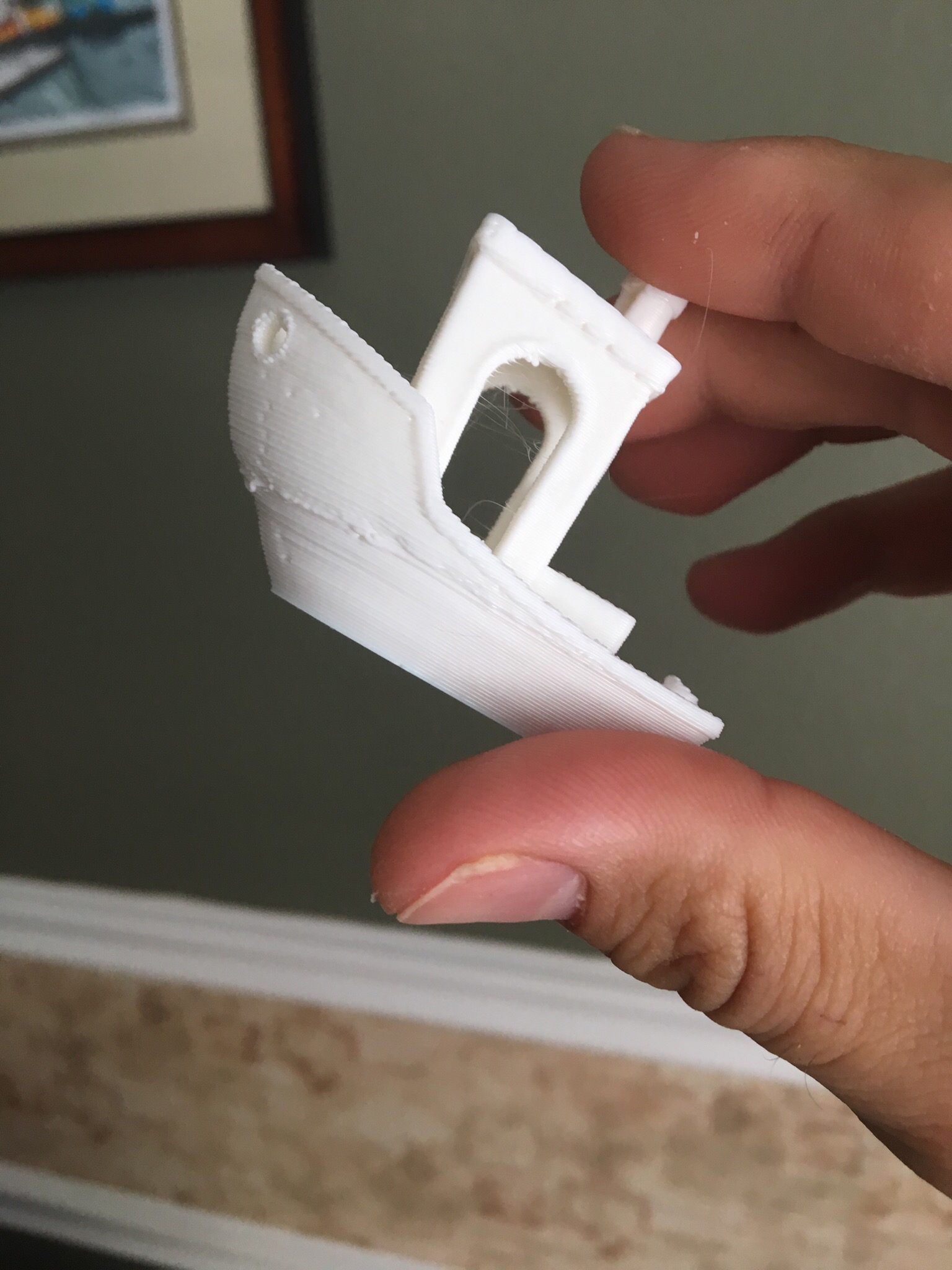

I redid the cable whip sort of. I removed the Bowden tube and disconnected it from the hot end and untwisted the Bowden tube since it was causing issues catching on the x tower skate. Put it all back together and did a 1 layer test print which was successful. I was successful at running the delta calibration wizard and immediately saw an improved first layer across the whole bed. I didnseitcj back to PLA since ABS really needs an enclosure.
Go to print a part and the printer shuts off completely. Weird...I'm able to turn it back on after two minutes or so. I attempt a print and it's going well and then it starts air printing. The HE and bed temp both show "def".
I stopped the print, clean off the failure and restart the printer. For fun I start the print again. Hot end target is 205 and bed temp is not used. The temperature now just hovers around 203.7, 202.9, etc. but never goes above 203.7. I set the HE to 210 to see what happens and it won't go past 207.5-7.

Checked the PSU output and it's 1.6 volts.
Opened the PSU after removing it and one of the large capacitors blew. I have a new MeanWell brand PSU coming today to replace this. The cap must have been failing when I started the last print because I smelled a burnt ramen smell and wasn't sure if it was the IKEA table or the filament.

new psu solved it. support shipped me a replacement that ill keep on the shelf if my meanwell version dies.
