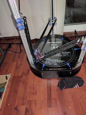

When my G29 command drove my hotend into my X tower and bed and didn't stop, I started looking around for what caused it.
Through that I found that I could use the m261 command to test the acceleromoter. Int 1 never changes. I can thump it or move it and some of the other values change, but never the Int value (meaning it never passed the threshold).
I believe my wiring is correct because my nozzle and bed are reading the exact same temperature (or near) and that is room temp. When I turn them on they warm up as expected. If I had messed up my hotend wiring, wouldn't that be also wrong?
This is a rostock max v2 upgrade to v3. Only parts that stayed were my e3d hotend, rambo, LCD screen, and motors. All wiring, heated bed, frame, extruder is new.
Any ideas how to correct the threshold settings?

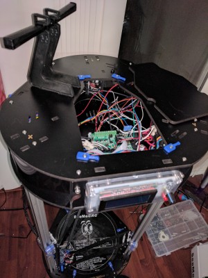

On the wire whip that came from SeeMeCNC, the PS_On wire looks more blue. I have it connected but after work I will go buy a cheap multimeter and test connectivity from pin 7 to the end of the wire.
nrbelk
Posts: 61
Joined: Wed Jun 17, 2015 1:58 pm
Re: Accelerometer is not working
Post by nrbelk »
I sent this picture to support and they also confirmed that I need to check the blue wire (PS-ON).
nrbelk
Posts: 61
Post by nrbelk »
It was the PS_ON. It came from SeeMeCNC wired wrong.
One time I tried switching it but I was too focused on what I thought was the actual problem that I switched it back before trying the calibration.
With the wire moved to the correct location, it works great.
