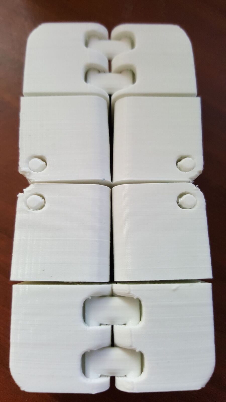

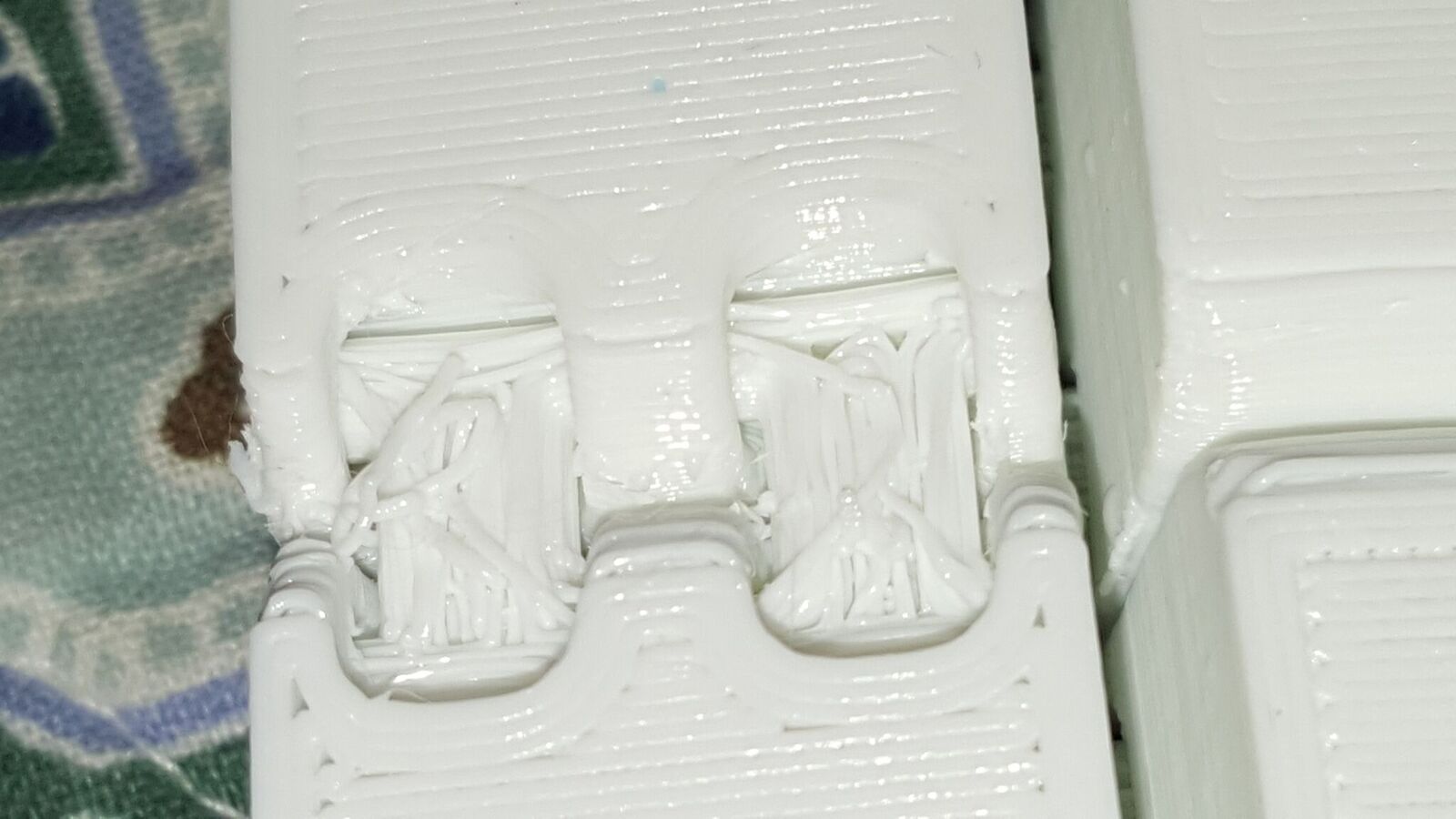

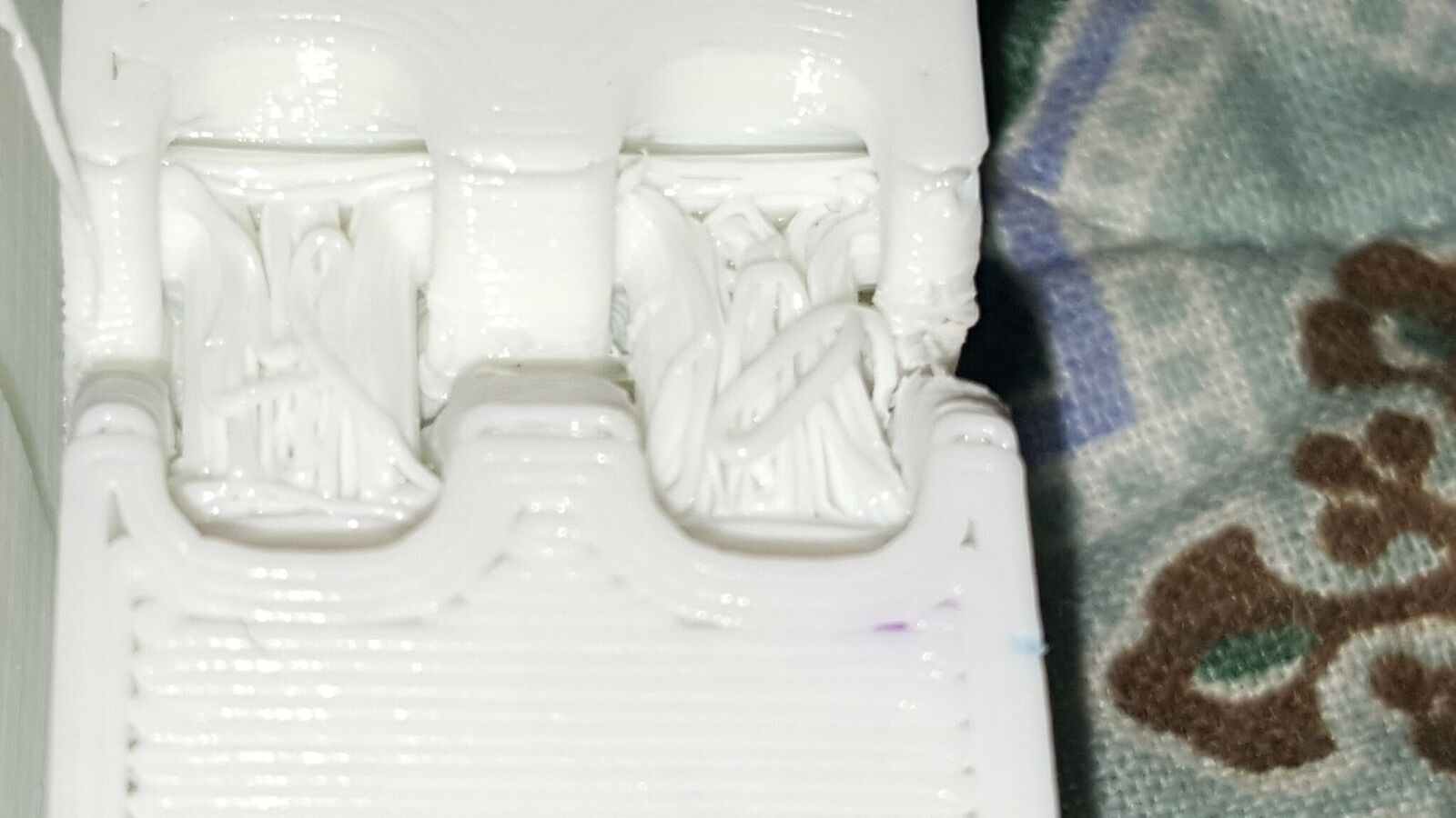

What's (still) annoying is that the printer does -some- bits just fine. Then screws up the same thing in a different part of the same print.
Pictures: One is Matter Control's default calibration box. It's about as close to .5mm as is likely to get. I had to mess with my extrusion multiplier to get that. (Yes, I tested with calipers) Look how nicely it prints! If only I wanted to make open-topped boxes...
Another (the spires on the base) is a retraction test. It printed very well--apart from the purpose of it--seems my retraction sucks.
The other images are of a fidget cube I grabbed from Thingiverse. See how it -almost- looks good? Some of the part connectors (printed in place) look great. Others, which are exactly the same as the ones that printed great look...not as great, and one set is positively stringy.
What. The. Hell?
This is AFTER changing to what the friendly folks at SeeMeCNC suggested I alter my settings to, as it's what they use. And recalibrated my extrusion multiplier.

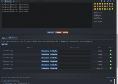

*Edit Here's another question: Where the HELL are my attachments?!?!
**Edit Due to the mechanics of this forum biting the big one, here are dropbox links for the images.

I can't really help you with your stringing issues, but I don't seem to have any problems attaching the pictures? Are you letting them all upload completely?
SS of the attachments in this post:

Annnyway. The calibration cube looks good, of course, except for the missing top. I haven't used matter controller in a year (srs, switch to repetier host or something), so I cant talk on it with complete certainty, but I believe there is a 'solid top' or 'top thickness' setting. Make sure these are set to On/not 0. Additionally, it looks like you had 0% infill (or the vase setting was on), so even if there was a top layer, it would have just sagged into the print.

There are some other things that look to be going on. I think you're a little high on temperature (Or too low of fan. Even ABS can benefit from a bit of fan speed). Another thing would be to turn on support, and possibly increase your non-printing travel speed and Z-hop. The combination of factors should reduce stringing, as the now cooler (Either through temp adjustment or fan speed) filament won't dribble through the nozzle as readily, while the higher speed and larger Z-hop should stretch out and break any strings that would develop, making them much easier to remove from the part if they remain. Support would stop pieces like the undersides of those hinges (I think those are what they are) from distorting as much, and increasing the minimum layer time will help on small parts quality wise.

So the issues are the gloppy mess that are the connectors on the fidget cube. (Which no one's noted some came out perfectly--and those are all photos of The Same Object--not separate prints) And the blobs that look like broken tree branches on the retraction test object (The one that has blobs that look like broken tree branches)

So, in not particular order: 210 sounds like a fine temperature for PLA. If you're using the HE280, then it's understandable that you don't want to reflash the stock firmware, since it's only sorta compatible. The temperature reading on the laser doesn't translate particularly cleanly to the actual nozzle temp. However, it does give hints. That 191 sounds high given my experience, but it's also very possible you have a more accurate IR thermometer than I do, since mine reads ~180 at 235C nozzle temps (Aluminum and other uncoated metals are a pain in the butt to get a good IR temperature reading on without a very expensive thermometer). Each PLA spool is slightly different though. Perhaps lowering the temperature will improve the finish (I don't use PLA much, since I do vapor finishing of the parts, which means ABS is almost a requirement). That would track with what I usually see as effects and advice.
Increasing the fan speed does in fact cool things down, which acts to get the extrusion below the transition temperature quicker, effectively freezing it in place (Much like chilling dough will firm it up). This reduces the chance of it distorting and drooping. This should improve the bottoms (And given the size, probably the tops of the hinges), and probably keep those cylindrical pins from shifting sideways at an angle. I would bring fan speeds up in 5% steps or so, then do finer tuning once you know around where you want to be.
To be clear, Mattercontrol and Astroprint are primarily host programs, but at least mattercontrol contains a slicer (Although you can feed in arbitrary G code instead if you want.) S3D is a slicer primarly, although it may contain a host program (I refuse to pay a company money to give them ownership of my G-code, which seems to be in their license agreement and they refuse to say that it doesn't). This is mostly a pedantic clarification, since I'm not going to tell you to switch slicers (or avoid doing so). I feel my role is to give advice and knowledge, not dictate the process. However, each slicer has it's strengths and weaknesses. S3D is considered to set the bar for CONFIGURABLE support. KISSlicer is thought to be the best of the free (as in beer) slicers around for general use, but needs a lot of configuration and tweaking. Mattercontrol and matterslice is flexible and somewhat balanced, but has some interestingly terrible failings, IE Z-hop not working in a raft at all, broken Slic3r implementation, and a weird relationship between "first layer speed" settings and the actual speeds when making a raft.
Supports may need tweaking. If you're having issues removing them, I would increase the gap set in the slicer, or lower the density of the support. This offers a balancing act between drooping and ease of removal. Pick your poison.
For travel speed, I would start by increasing it ~20mm/s, and raise the Z-hop to maybe something like 2mm. This is a large step, but you'll be able to see any changes pretty clearly like this.
As far as retraction, low and slow seems to be the right answer, especially for PLA. If your slicer supports independent prime and retract speeds, retract slow and prime fast. PLA is non-newtonian at temperature, either you want a very fast speed which few extruders can accelerate to in a small enough time or a slower one to remove as much molten material and pressure as you can from the melting chamber.
