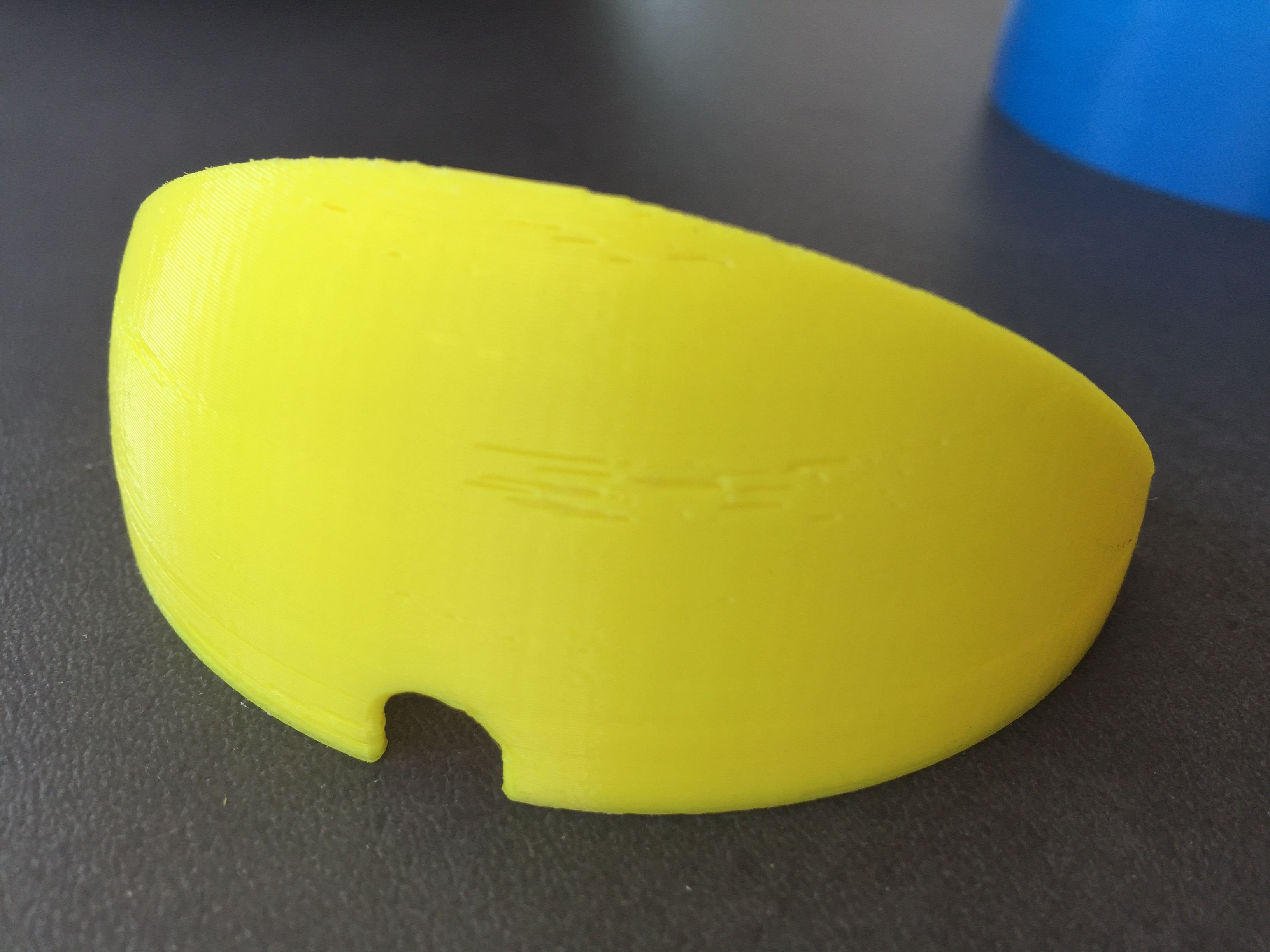

I have my Rostock Max V2 since about 4 months now. Total print time is ~224hrs.
I have observed that on my recent prints with different filaments that there is some under extrusion from time to time. I don't know why and what exactly happens here.
Any suggestion where I shall look into?

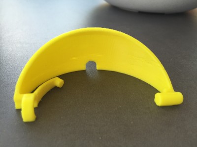

It seems random. Yesterday I've printed a model without any issues - however another low cost filament had been used. I need to check for this behaviour more detailed. Maybe I'll print out one more sample I did in the past that had said temporary under extrusion signs. (the yellow part in my earlier post)

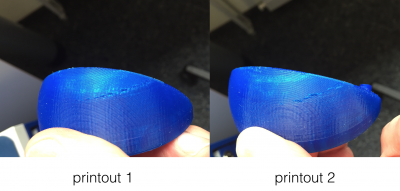

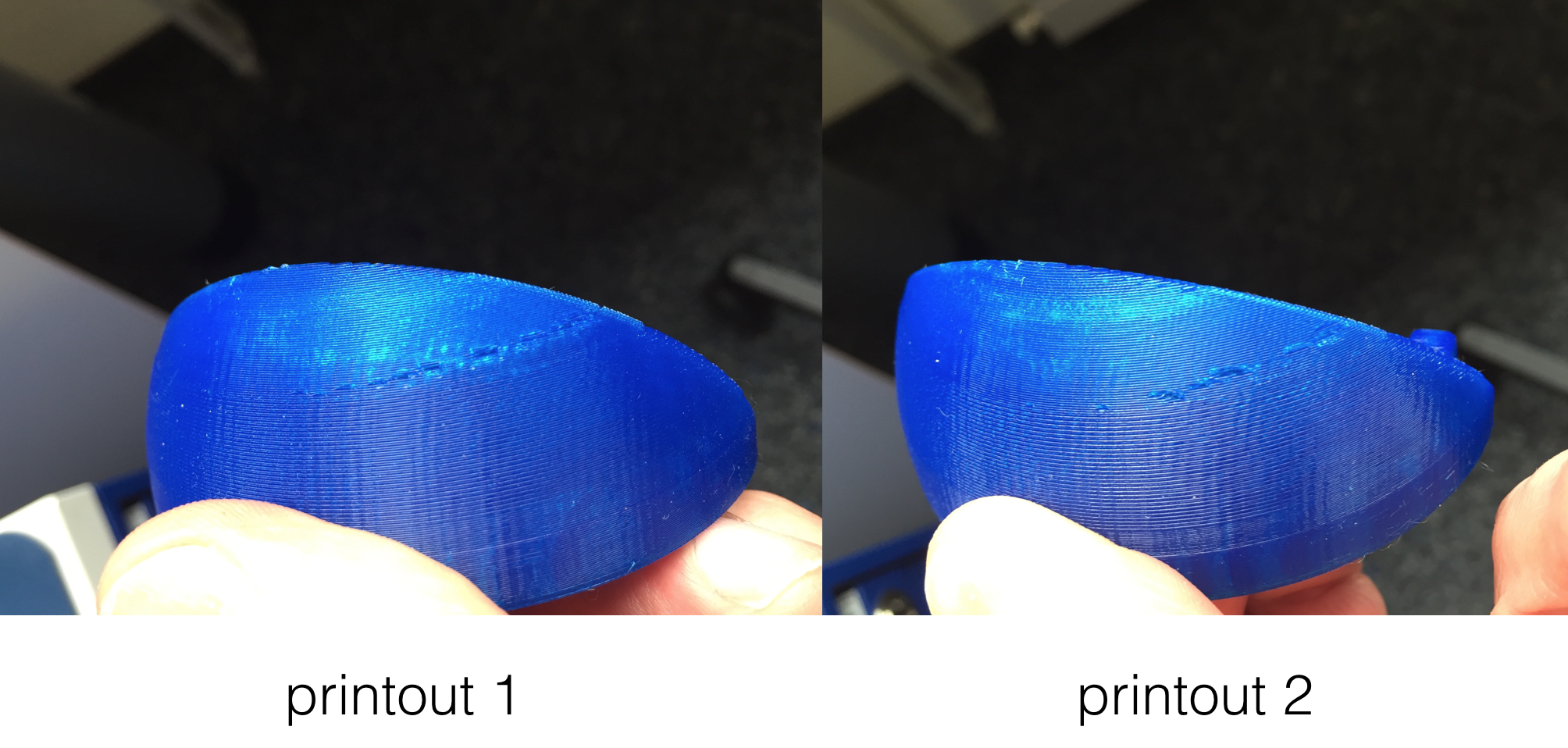

I've printed the above yellow shell again with a different PLA filament (low cost PLA which gave me good results so far). (from http://www.thingiverse.com/thing:1559232). It's the outer shell. Strangely I've found some irregularities similar, but not identical to what I've seen on the yellow part already. I decided to print it out again (printout 2) and to my surprise, the error pattern was identical. This is yery strange to me. Any hint what can cause this?
Interestingly to observe is that also the banding on the shell has a identical pattern. The print speed was 40mm/s.
Thanks for any help to clear this mystery.

RandomFactor
Posts: 35
Joined: Wed Apr 06, 2016 12:36 pm
Re: under extrusion occurs every now and then...
Post by RandomFactor »
Problem with the model? Try repair/remesh in MeshMixer and/or 123D.
Johncoffee
Posts: 87
Joined: Tue Feb 23, 2016 6:25 pm
Location: Switzerland
Post by Johncoffee »
I think the model is perfect. No issues with it.
Tincho85
Posts: 659
Post by Tincho85 »
What happens if you print it but rotated 45º?
Also, print something similar, but simpler, like a cylinder or half a sphere.
Martín S.

Hi Tincho85,
Very good idea. I've tried a half cylinder wall and all went fine. Now I'll be trying half a sphere. Will get back again...
