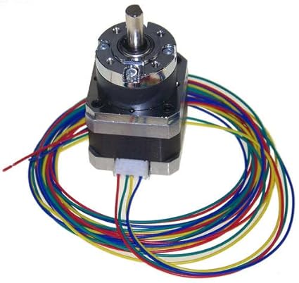

@ Tonkabot. I am looking for a gearbox stepper. Do you have a link to the one you bought?Tonkabot wrote:
Along those lines I bought a really cool stepper motor with a 5.2:1 planetary gearbox, that I think would make a decent extruder motor.
This is the one I bought, and have a second in my cart at amazon to get: http://www.amazon.com/gp/product/B00JBP ... YS4P930GVM
Hopefully that link doesn't put you into my shopping cart or anything stupid. Cause it does if I follow it.
[img]http://ecx.images-amazon.com/images/I/5 ... SX425_.jpg[/img]

Hi and thanks for all the info. I orders 2 geared nema 17.

You must use geared extruders with this hot end. A regular EZStruder doesn't have enough torque, nor does it place enough pressure on the roller (although there's a mod you can get that compresses the spring more). When I was using EZStruders with this hot end, I endured the pain I posted about above. With geared extruders, and the hobbed bolt being a few millimeters wider than stock, you get both ample torque and "pinching force." I have been running PLA and HIPS through the hot end. When I was using a stock EZStruder, the HIPS just wound up getting stripped as soon as the going got tough, which was practically all the time. It never ran for more than a few minutes without screwing up. However, with the geared motor and the fatter hobbed bolt, the HIPS doesn't get stripped. It just goes right through.
Another benefit to using geared motors, with lots of pinching force on the rollers: I was able to clear a nasty jam just by extruding 1mm of filament at a time. I had also tried ramming an Allen key down the jammed side, and I did manage to get the filament to go down a little, but it immediately jammed again. Feeding 1mm at a time, I could see the Bowden tube being pushed more and more - but after I had extruded 4 or 5 mm, the jam cleared!

I also recently installed a Kysan geared stepper, though a slightly different model than the one posted here (I got mine from tridpirinting). I notice a tiny bit of backlash in the 8mm shaft, at certain points of the roataion. Is anybody else experiencing that? It doesn't seem to hurt the quality of the prints so much, but I'm worried it will make retractions sloppier than need be. Should I look for a new one, or do all geartrains have some amount of backlash?

I got two of those from the same site, with their bigger hobbed bolts. One of them has a little transmission noise when it gets to a certain angle of rotation. Other than that, I haven't noticed anything. Retracts have been very, very clean so far.
Re: [Solved] Surface Quality Issue with E3D Cyclops
Can you get your finger in there and wiggle the shaft a bit and see if it moves? I had the same "rattling" kinda noise at parts of the rotation, and it turned out to be a tiny amount of backlash. Everything does seem to work nice, so it's likely a non-issue. I might have to increase retracts by .2mm to compensate, though I have only done three prints on the new nozzle, so it's hard to tell where my retracts stand in regards to the new nozzle and stepper.
