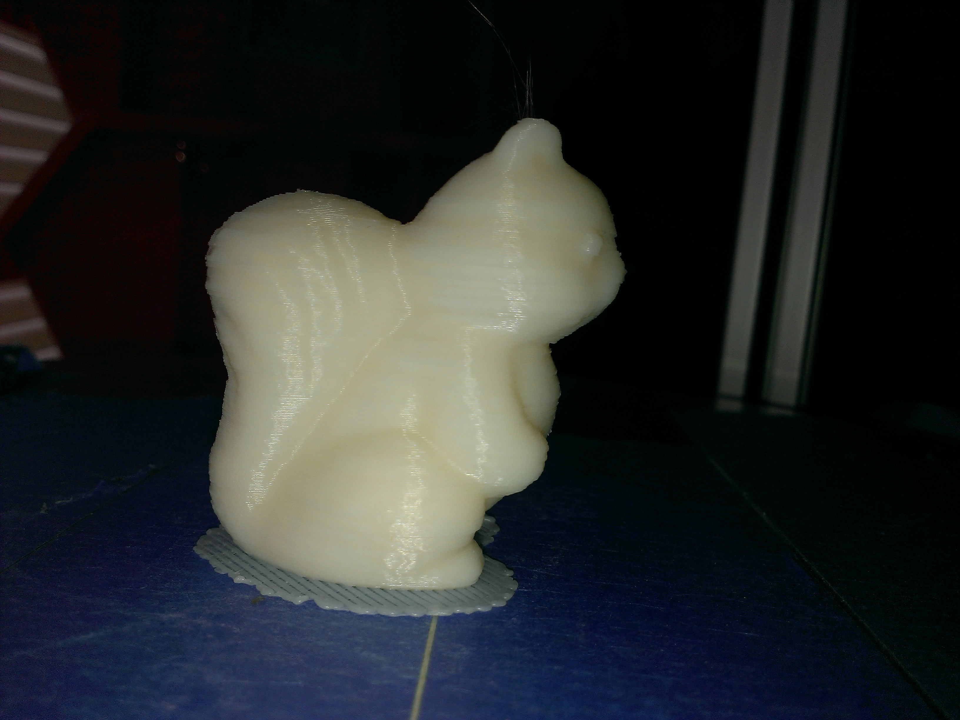

Re: Layer shifting

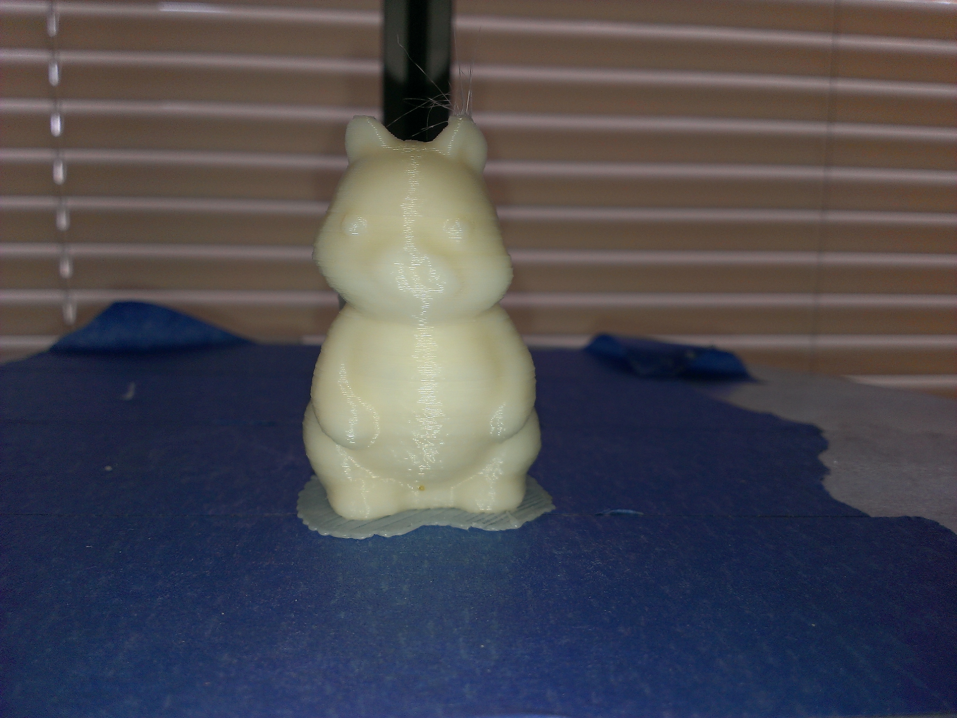

So although motion has improved, it has not corrected my layer shift issue.
Notice the squirrel's head, it's shifted over to the left.
Look at the left edge of the squirrel's tail, the layers are misaligned all the way up.
Now I'm really at my wit's end. Motion is smooth, and there isn't any mechanical binding, acceleration is already lowered, jerk is lowered. Motors ohm out equally at 1.1ohms for every coil, belts have been tightened and loosened, motor currents have been set high and low, magnetic joints have been swapped in and out, and I am getting tired of this. I must be doing something wrong and I don't know what.
Bad motor? Bad rambo motor driver? I don't know.

Clearly you are losing steps in what ever way that's leaning on the bed.
Have you tried swapping the bad axis onto the extruder 2 steeper output to rule out the electronics?

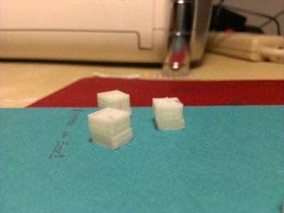

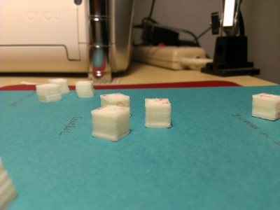

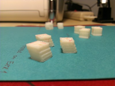

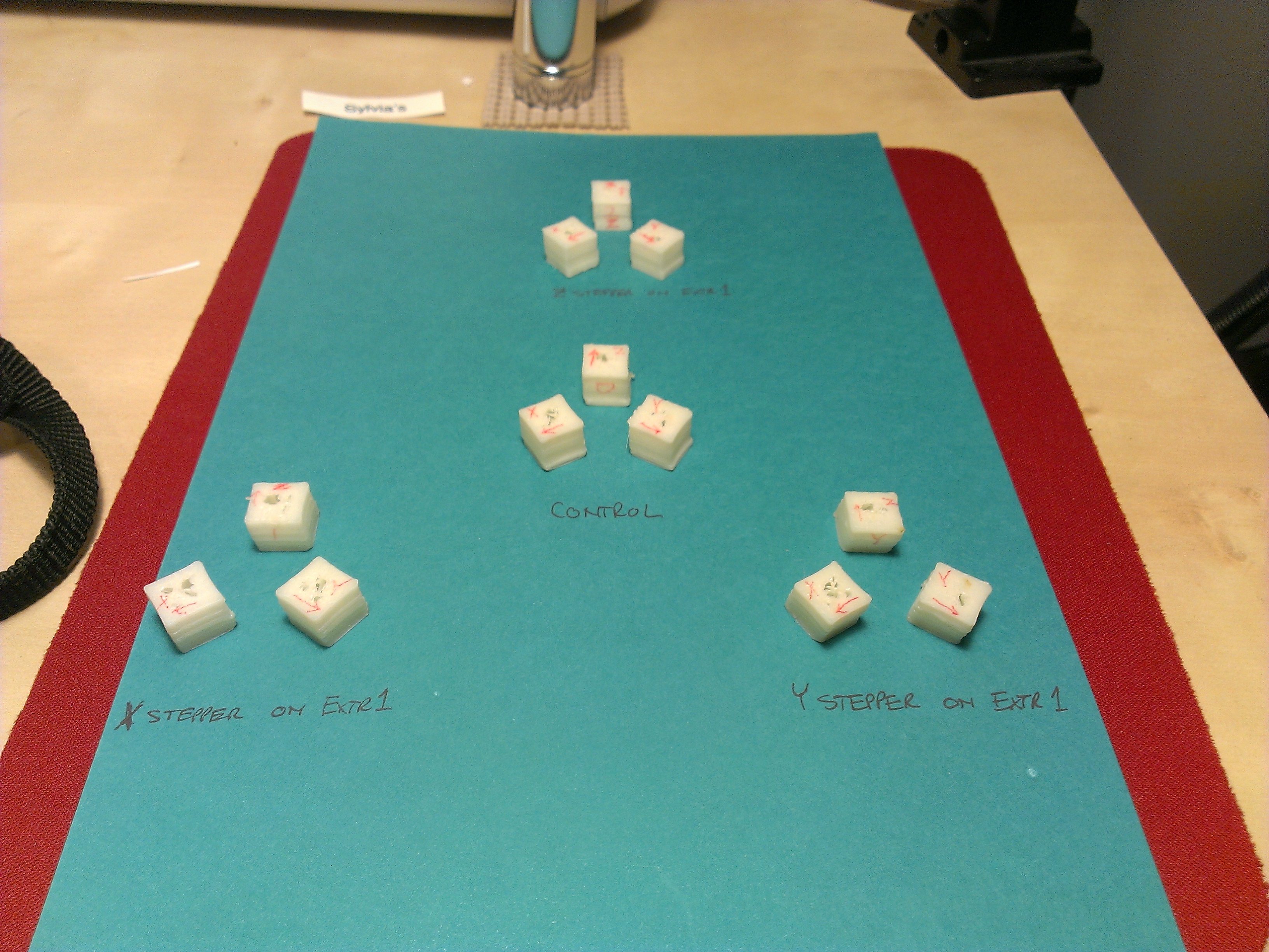

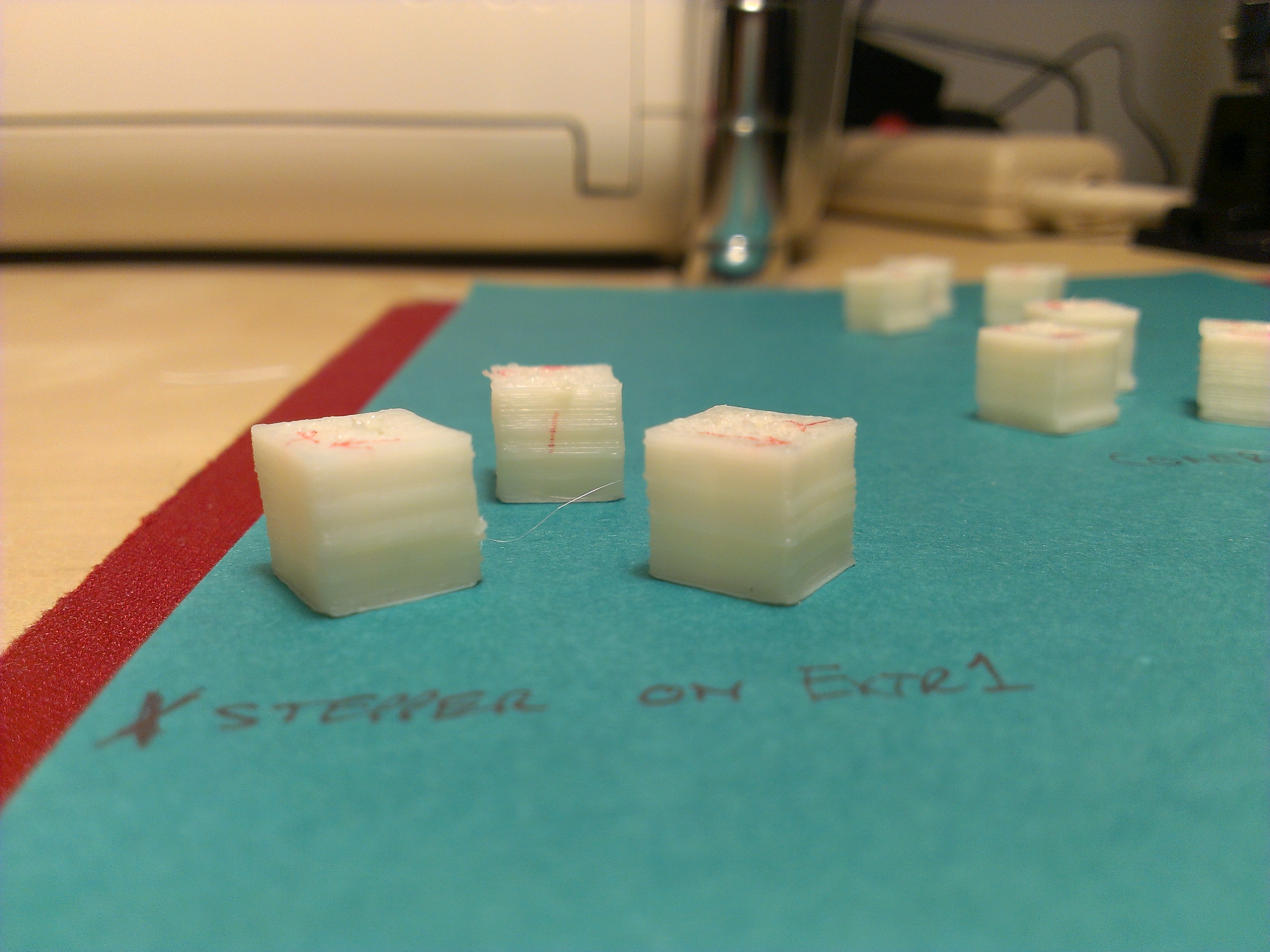

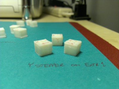

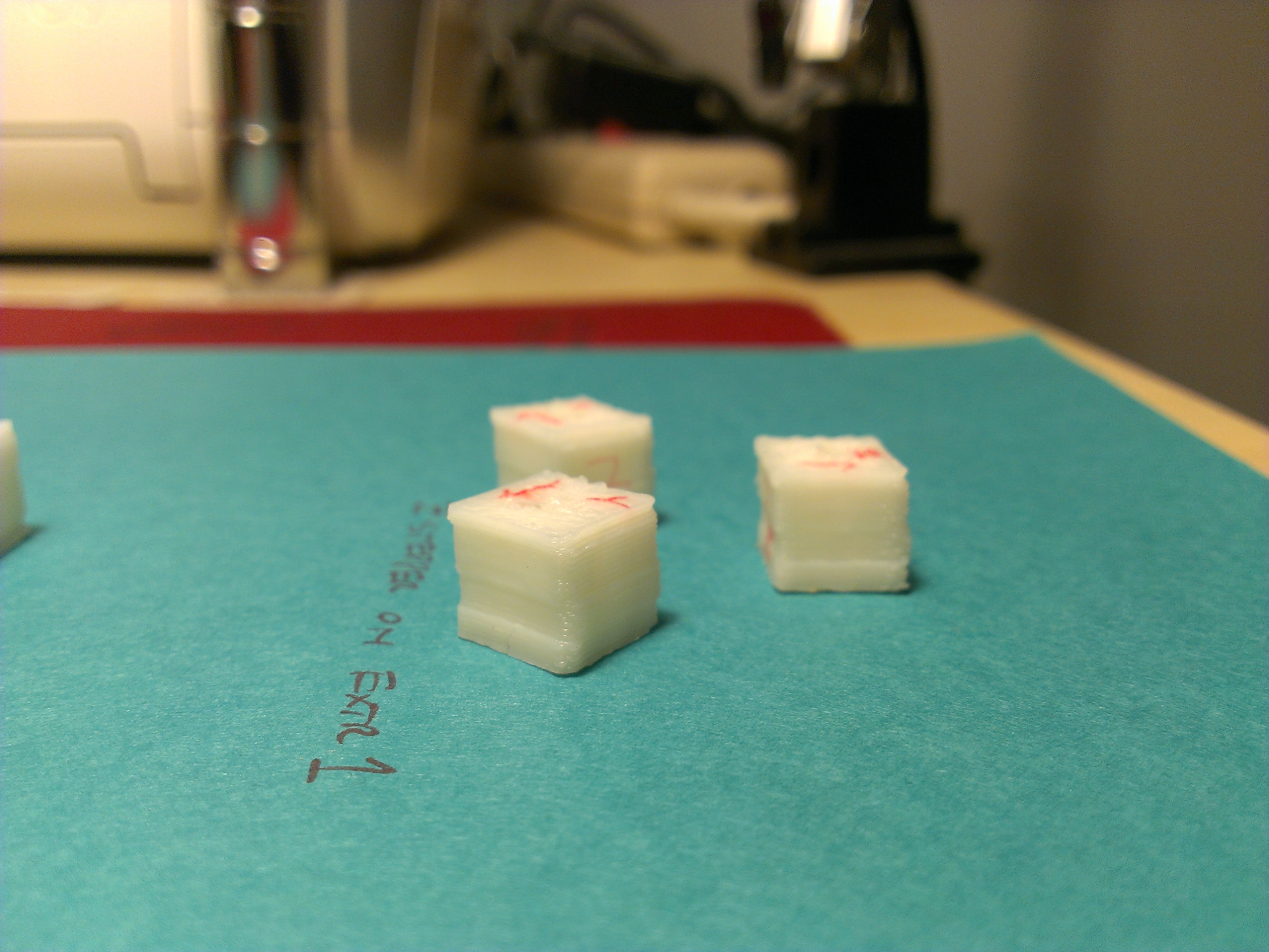

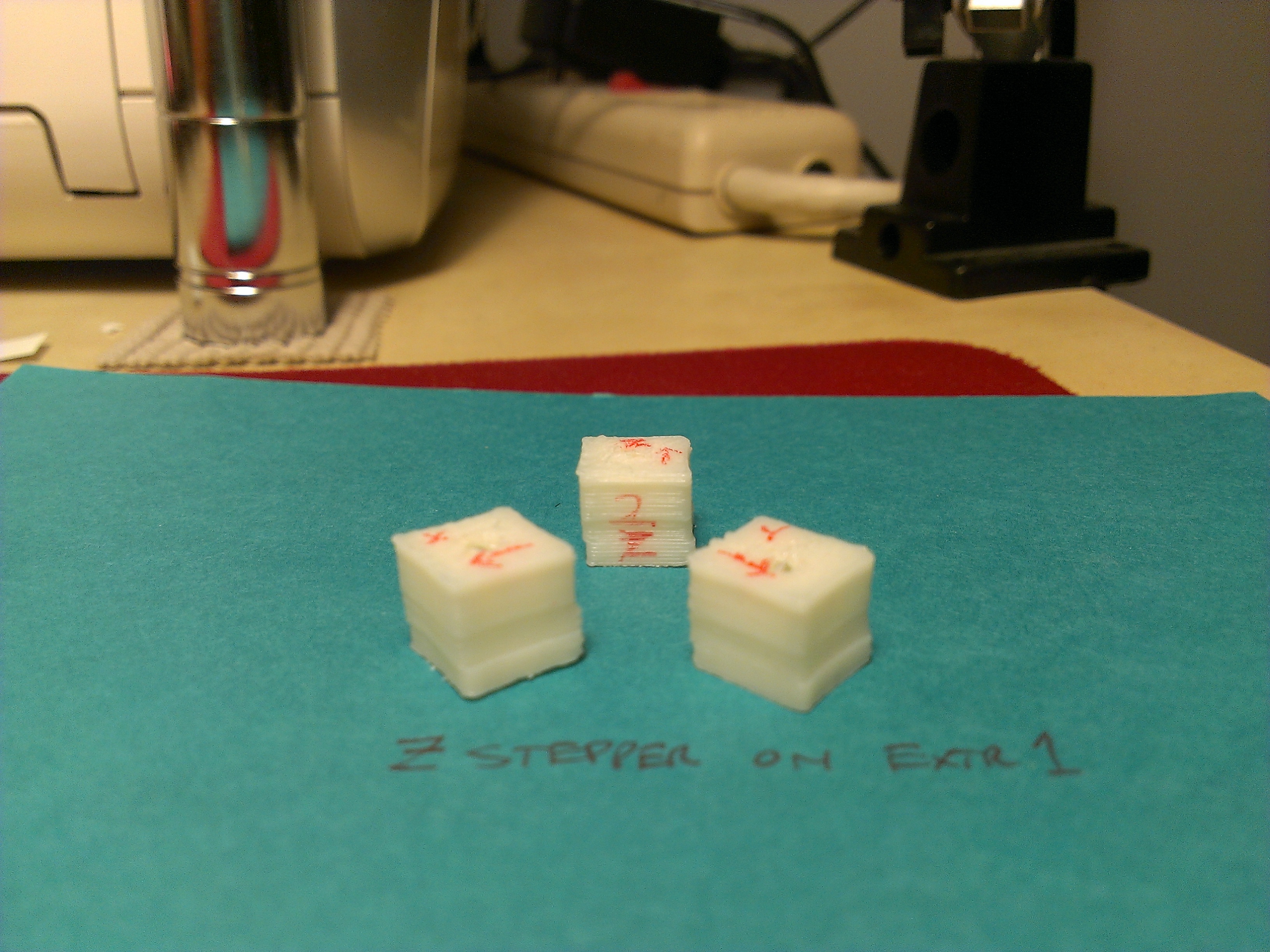

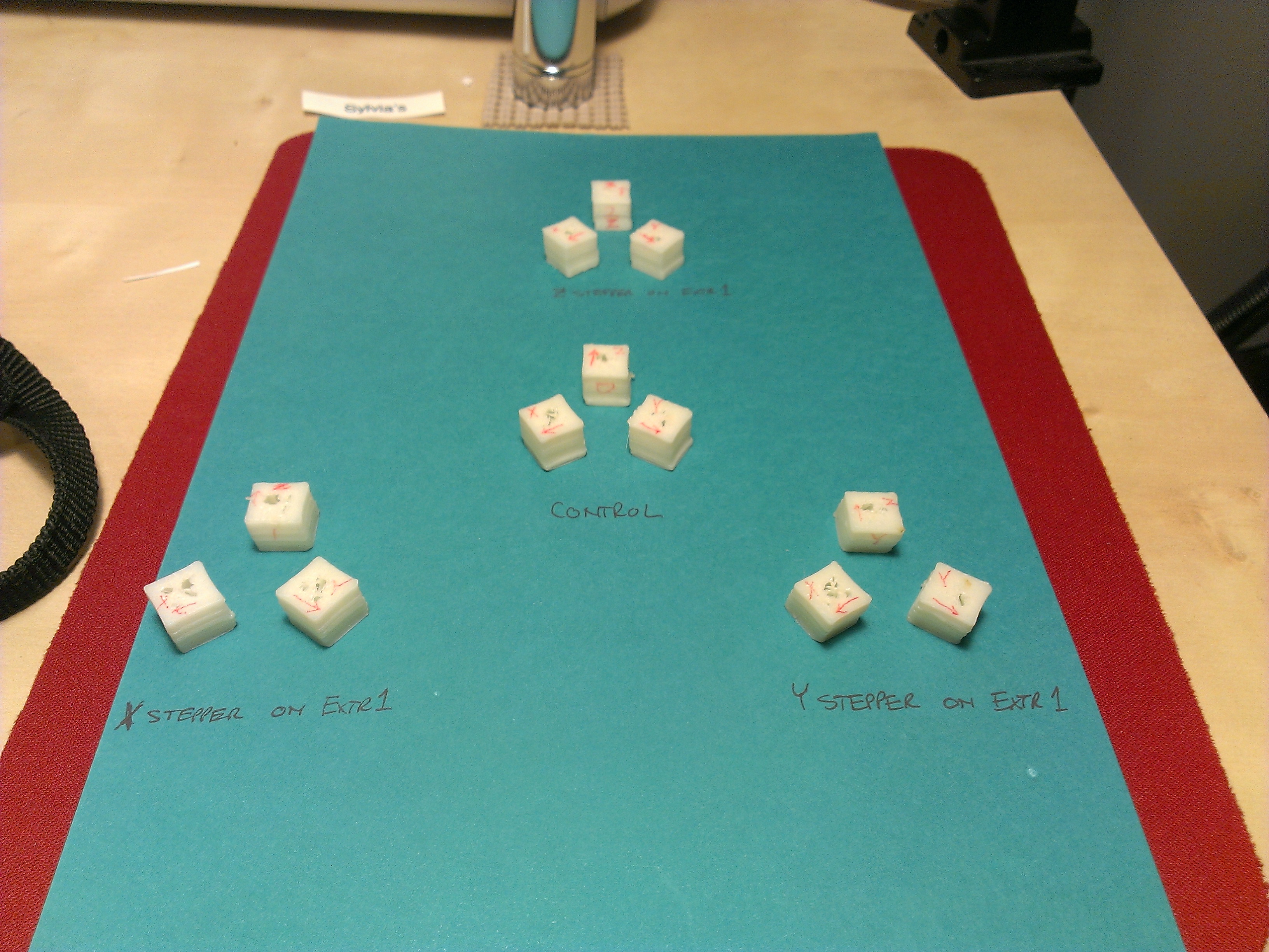

So here's the results of the pin swap extravaganza. In openscad, I created another test pattern so I could better see differences between each change. It's just three 10mm cubes arranged in an equilateral triangle, with faces facing each tower. The center group is the control group. Each stepper motor on it's default driver. Lower left is X motor on extruder1 pins,
lower right, Y motor on extruder 1 pins, and top group is Z motor on extruder 1 pins.
This is the control group.
This is the Z motor swapped onto the Extruder1 port. Looks pretty much the same as Control.
This is the Y motor swapped onto the Extruder1 Port. Obvious lean away from Z tower.
This is the X motor swapped onto the Extruder1 Port. General waviness.
So how does one interpret these results? I'm not too sure. Seems like since the Z motor swap didn't change a whole lot, the Z motor driver isn't the culprit. But since changing both X and Y messed it up even more compared to Control, I'm not sure where that leaves me.
