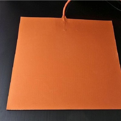

I was researching other heated beds out there and came across the silicone ones. I was wondering if anyone had tried to adapt these to work with their delta. From what I've read they get up to 90C in 2 minutes. I have a Rev5 that takes 20 minutes to get to 90c and an hour to get to 110C if I throw a towel on the glass.
My idea was to come up with an adjustable height standoff that supports my copper heat spreader and fix this silicone heater to the bottom of the copper. Doing this I could get rid of the snowflake and the Onyx. I am looking for reasons why this wouldn't work or would be less than ideal. I haven't ordered one and have no idea if they really do work that well. I am trying to avoid going the 24v route since I just put in a brand new ATX and that didn't help much if at all.
They include a built in 100k thermistor and looks like they are $10 plus $16 for shipping. Please give me input if you have any. Thanks!
http://www.aliexpress.com/item/Silicone ... 74961.html" onclick="window.open(this.href);return false;

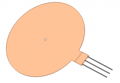

This is what I think it needs to end up looking like:
Of course he wants like $250 for a sample of 3. and I am sure for more than 10 the price goes down.
I have the hole in the middle 8mm. how little can it be?

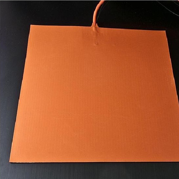

I have a sample of one of these heaters here on my desk. It is 1mm thick, 6x6 inch square, flexible, 245W at 12V. It has a 1.5x1.5 inch area that is bumped up to 5mm thick for the wires.
This one has an adhesive backing, I don't think we would want that (At least not to affix it to the glass, maybe the snowflake). It would conform to the flat glass very well.
